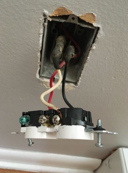

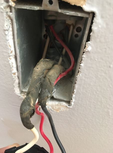

I'm finishing my project of replacing old switches and outlets in our new house, and I have a wall outlet where the lower receptacle was controlled by two 2-way switches, so we can control a floor lamp by using either of the two switches. I thought I just moved one wire at a time, from the old outlet to the new one, but now the receptacle isn't linked to the 2-way switches... it will only turn on or off when I use the actual switch on the lamp. What did I do wrong here?

It looks like it was only HALF controlled by the switch. Cut the tab between the gold screws and the half will be controlled again.

That solved it, thank you!
