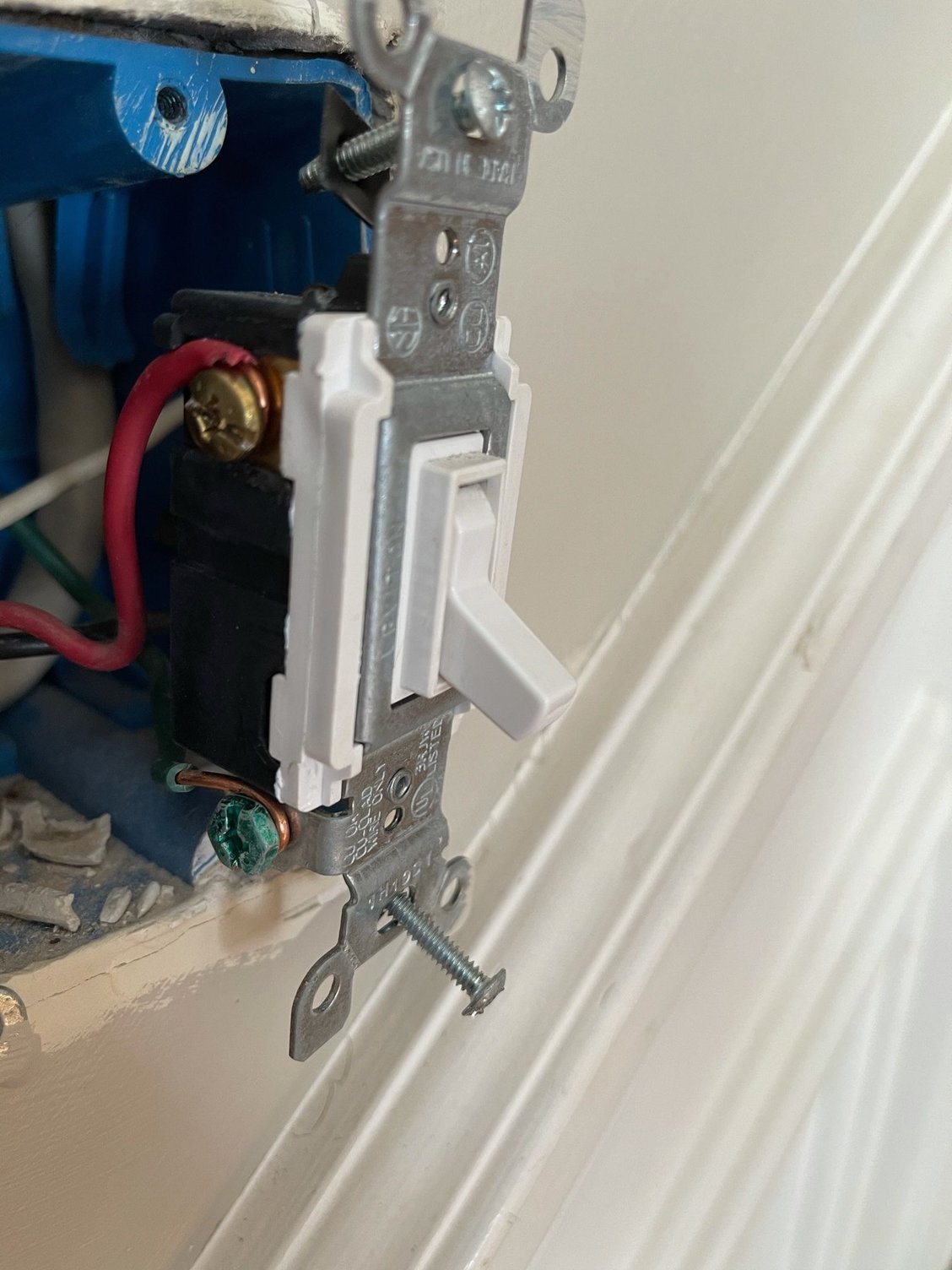

R
Join Date: Aug 2019
Posts: 28
I have this switch elsewhere - four wires, no ground. The switch would work on this setup then?

That is a four way switch. You need to check the second three way switch for a neutral.

Is this a proper 3-way to which I could install that smart switch then?

No. That is another wire four way switch and from a different switch circuit. Typically one set of wires goes on the top of the switch and the other set goes to the bottom OR one set of wires goes to one side and the other set goes to the other side. Your switches are not wired identically.
You want a switch that has three screw terminals on it. (not counting the ground)
The neutral that your treatlife switch needs is not one of the switch wires.
The red and white wires in your pictures are the travelers.

R
Join Date: Aug 2019
Posts: 28
I thought that I needed to have FOUR wires (one common, one neutral, two travelers, one ground) coming from the box for the smart switch to work. I have the switch below, but if this is a good candidate I'm still not sure what to do with the extra traveler connection on the smart switch.

Is this the switch where all three wires are in one cable ?
Old 12-02-20, 11:47 AM
R
Join Date: Aug 2019
Posts: 28
Yes it is, it's a two-switch box, and each switch has a single central wire which then splits (in this switch's case) to four wires (one of which is the groundwire).
Old 12-02-20, 11:56 AM
PJmax's Avatar
Join Date: Oct 2012
Location: Northern NJ - USA
Posts: 60,936
Received 1,351 Votes on 1,249 Posts
Ok..... so at that switch..... you have black which is line/load and you have red and white that are travelers. Since red and white are travelers..... they are both hot wires. Red is live-white is dead. Flip the switch and red is dead-white is live. Those are travelers and change polarity based on switch position.
You have two sets of three wires at the four way switches. Red and white are travelers and are on the switch while black is line/load and just carried thru.
So we are right back at the beginning.... you do not have a neutral there.
That means that switch MUST go in place of the other 3w switch.
