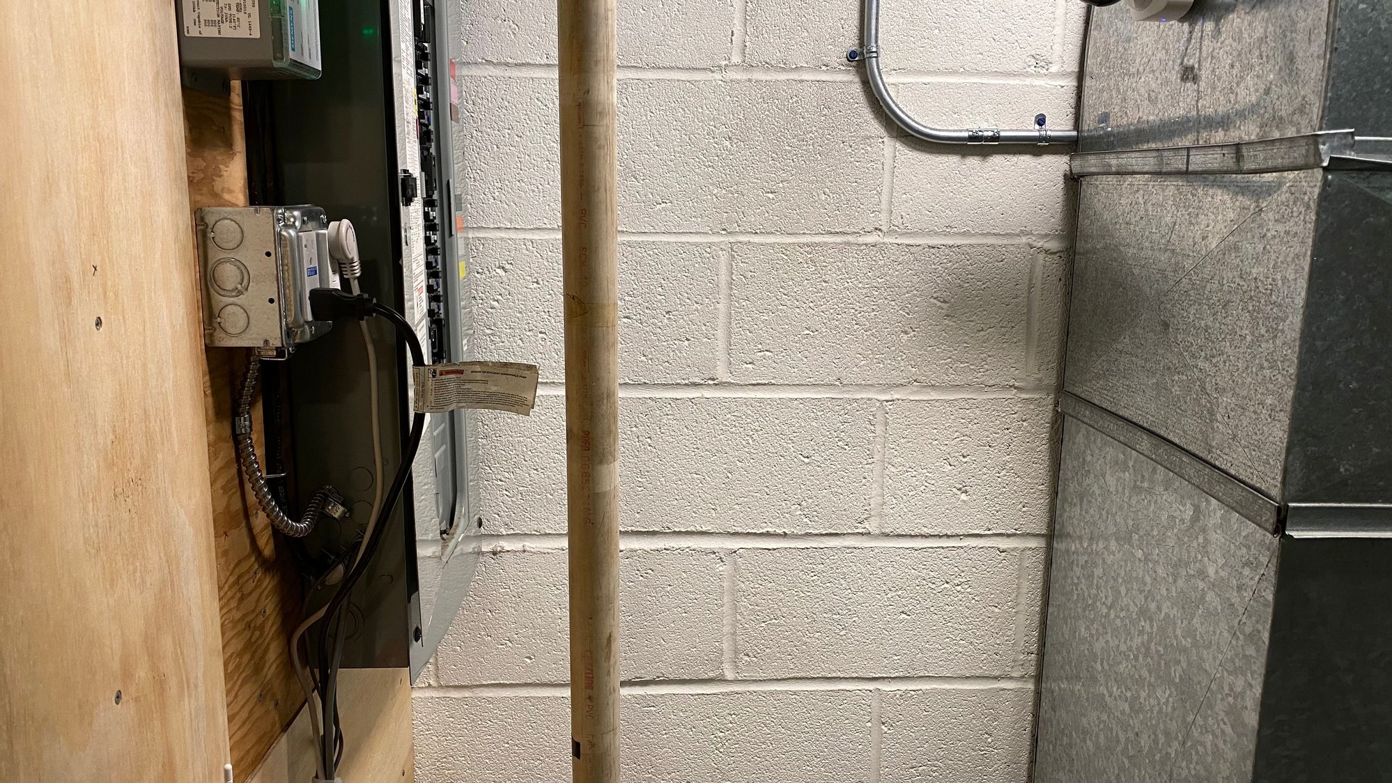

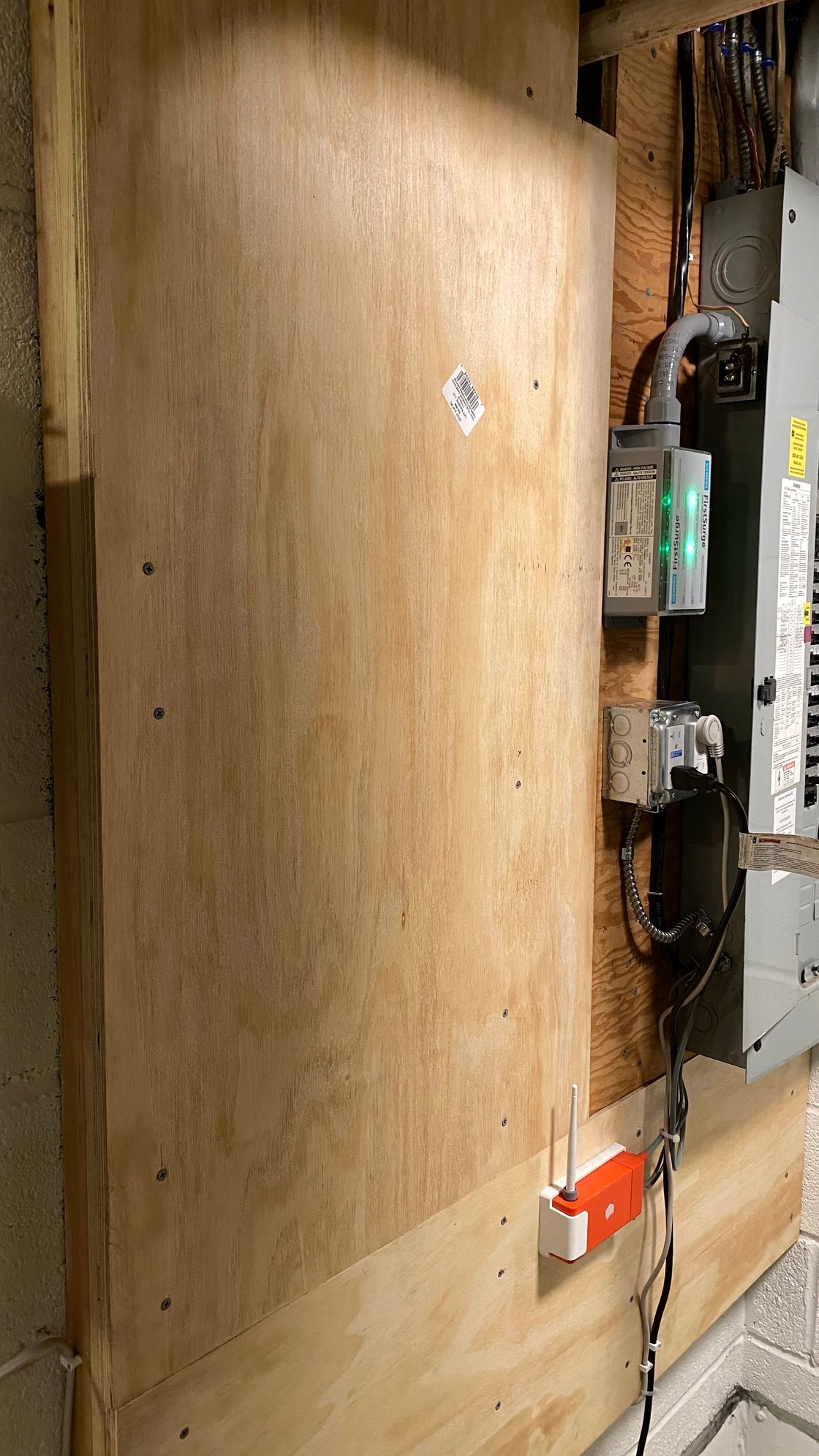

I live in a house built in 1950s which has a main panel that was installed in 1980s (by previous owners - cant be certain but the siemens product code tells me it was around that time). This main panel is on the corner of the basement and faces off the furnace/hvac and it appears that it is not meeting NEC requirements for clearance.
It has only 30” of space from the panel to the hvac unit. Furthermore, it has a sump pump pipe that is about a foot away (sump pump pit is below it).
Now I understand this panel is “grandfathered” so to speak. The question is, can a subpanel that I plan on installing right adjacent to it to also be included under the same exception? If not, it will be substantial amount more work to locate the subpanel somewhere else and it will be a very ugly solution. Having both panels side by side is far more elegant.
Sump pump pipe is something I can relocate (rather than going up, I will have it go to the wall, go around the wood base panel and exit from left).
The plywood extension is something I added later on and it was a lot of work (have studs behind it that I anchored to the masonry wall). It will be a bummer if I cant use it.
If you relocate the sump pipe, seems like there's enough room on the cinderblock wall between main panel and furnace? Could mount some plywood there and mount subpanel to that.
Old 12-07-20, 06:34 PM
D
Join Date: Jun 2017
Posts: 438
There is a radon pipe right above that location which would violate another NEC rule that prohibits any similar piping to be above the panel.
see pictures

I don't think the radon pipe would be a problem. But the sump pit and pipe would be. The pipe could be moved and if you built a shallow floor(removable) over the pit I think you might be OK.
