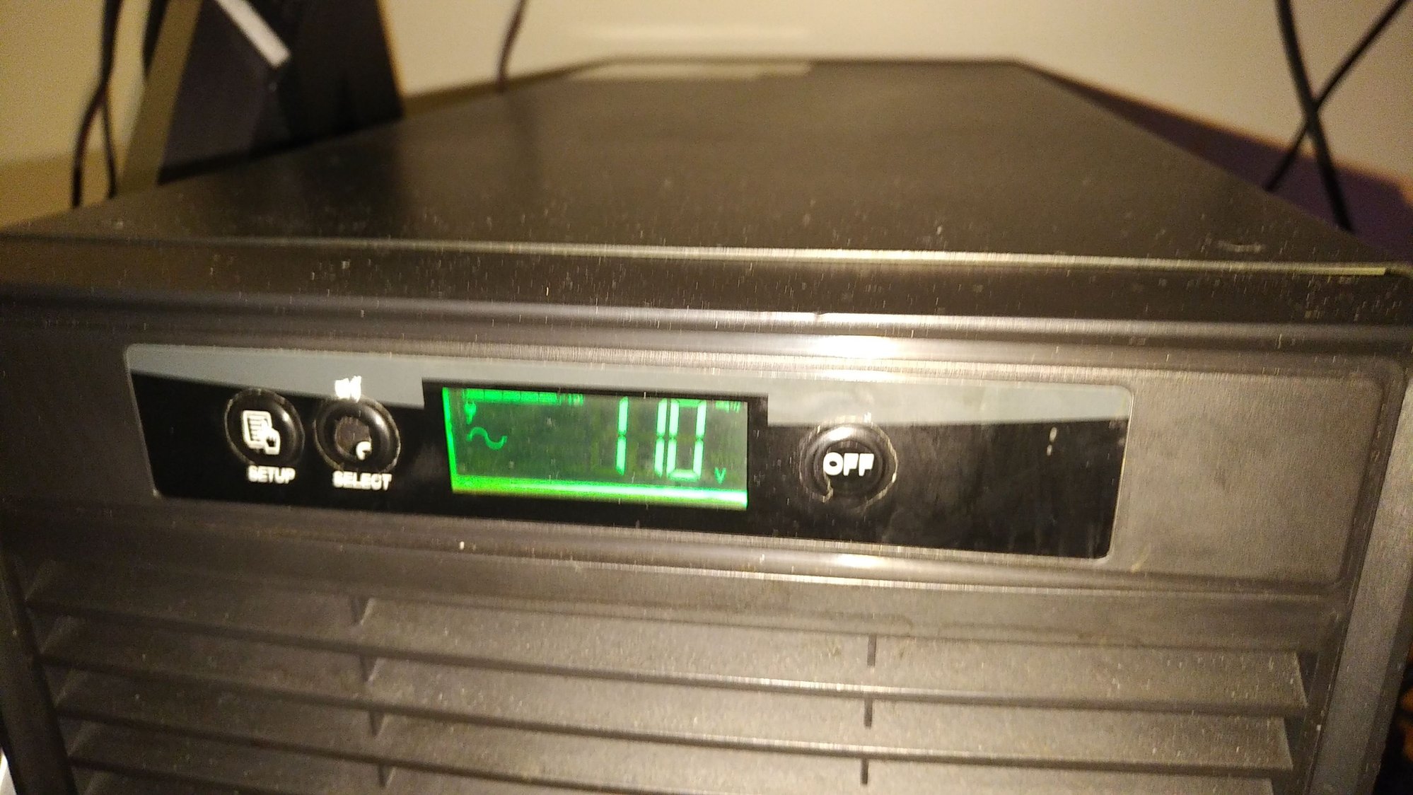

Ok, so my box (in the picture) is sitting at 120 flat, most other outlets are between 115 (on the high end) and 117 all bouncing around, I got one attached to my bathroom light GFI/Light Switch (which also has a plug on top of one of the light fixtures that goes on when I turn on the light) sitting at around 113, but they are all variable at different times.

Keep in mind my box doesn't show decimals, just the voltage so it could be shifting around itself at the 120 range.

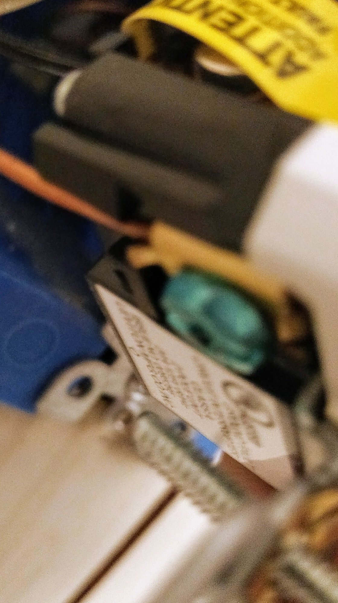

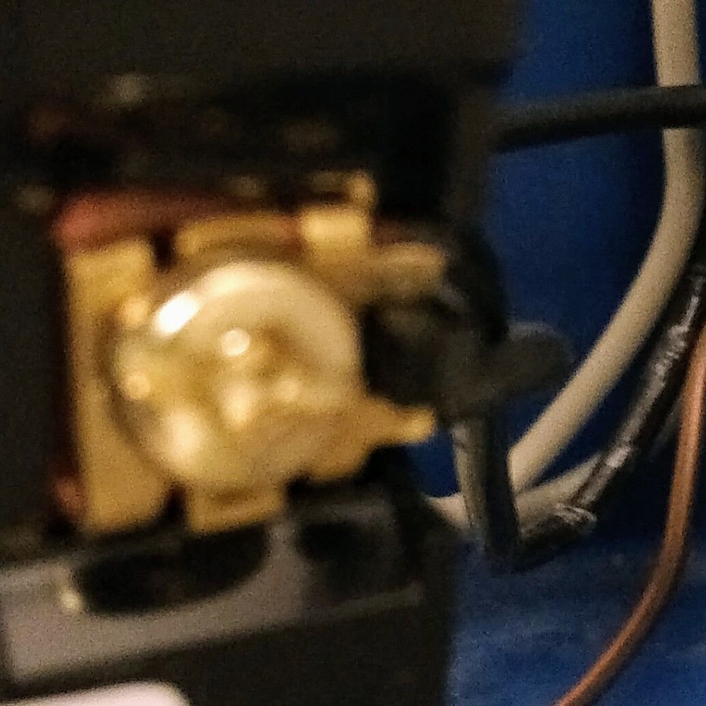

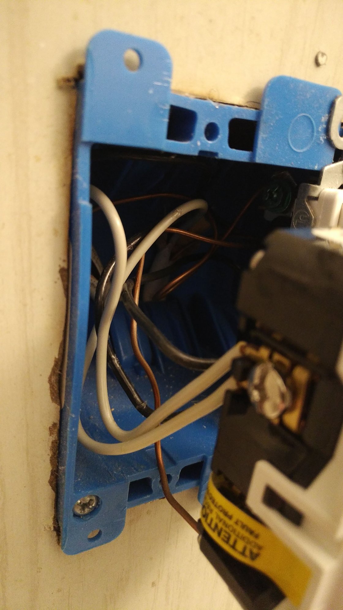

The Bathroom GFI and a visual of the wiring in the house and my other outlet.
The wire mess and general type in the house mostly . There is a light switch next to this that is grounded, think they may have used the good ground there.
How the ground "was" , I put it around the screw, still not grounded.
One Hot, 2 Neutral. Sorry bout the quality, too many photos.

Swapped the grounds (they are coming from opposite hot lines, it now shows I have a neutral unlike when I pulled it out of the push in slot...breaker still doesn't trip and shows it isn't grounded.
Is it possibly due to the double neutrals on the receptacle?
