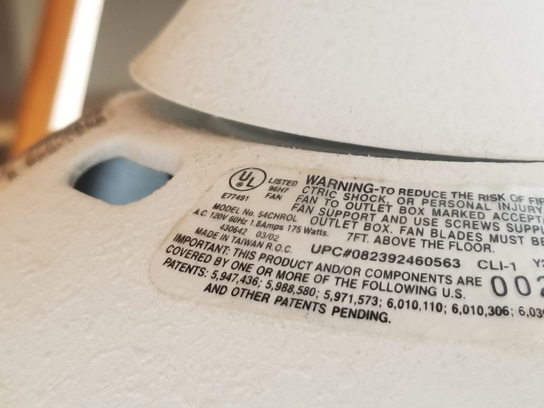

Have this Hampton bay Callaway II ceiling fan, which did not come with a remote and I am really hoping to use it.
Can I simply by pass or eliminate the receiver(present inside fan motor) and just use fan at the highest speed and light? For example using this video: www.youtube.com/watch?v=M0NvjKEEr9s
Not seeing any chain or anything hanging anywhere:

Hi, can you post a pic of the wiring Dia. or installation instructions?

There are universal remote and transmitters available. I am not sure how you will control the speed without a remote.

Thank you both, sorry but I don't have any manuals
Anyway I can use below switch to control light and fan at maximum speed?
Possible, but you will need some knowledge of how motor works and may need ability to reverse engineer control circuit. Wire color coding is not always the same. When I modified mine, wire colors did not match diagram I found on-line.
I have modified mine to use dimmable LED bulb and old fan controller did not support it. I used capacitor built into the controller instead of external one as I did not want to spend any extra money. Permanently wired to highest speed setting.
Fan speed control will need to be done by a external controller. It could be universal remote receiver or fan control switch.

Thank you @lambition, that is exactly I am after, trying to re-use capacitor from the existing receiver and see if I can hack it at the highest or 2nd highest fan setting, then use the switch to control light.
Because I don't have a remote and not intending to buy. How should I go about it? Any help or advice please?

private image upload
This is the receiver, now just need help in terms of jumping the wires and maybe adding a capacitor? Thank you
