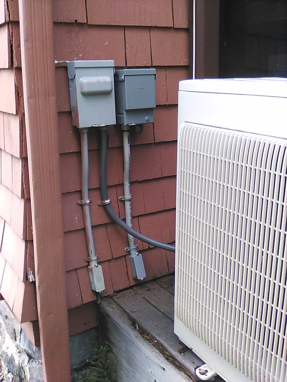

That is what I thought, but the HVAC contractor is asking for the 30 inch wide & 36 inch clear access. I suppose I will have to check with the inspection dept.
Old 09-12-22, 07:23 PM
Tolyn Ironhand's Avatar
Join Date: Nov 2007
Posts: 15,029
Received 627 Likes on 536 Posts
I would not think the clearances rule would apply to AC disconnects because they do not require "examination, adjustment, servicing, or maintenance while energized." (NEC 110.26(A)(4)) All that is required of a disconnect should be to operate it on or off.
A visit to the chief electrical inspector this morning proved very fruitful. His interpretation is that if the disconnect contains overcurrent protection the clearance requirements in Section 110.26(A)(4) would apply. Otherwise the disconnect switch only needs to be "readily accessible".
Clearance from front of right hand switch to adjacent AC unit is 13 inches. As a minimum, just enough to be "readily accessible". The enclosure is similar to one that would house a circuit breaker (overcurrent protection) but in fact contains only a switch that looks like a breaker and is specifically labeled "No overcurrent protection." If it contained overcurrent protection he would require that it comply with Section 110.
Without getting into details that are only relevant to my particular situation, he also clarified an on-line permitting/inspection issue that was very favorable to me.

FWIW I like the PVC conduit work, that's what PVC should look like with bends.
Makes sense to me. However, I have seen many disconnects with fuses that do not have those clearances.
FYI - I believe disconnects only need to be accessible, not readily accessible.

[QUOTE]that’s what PVC should look like with bends.[/QUOTE]
Thanks. I have an old very powerful hair dryer that I use as a heat gun.
