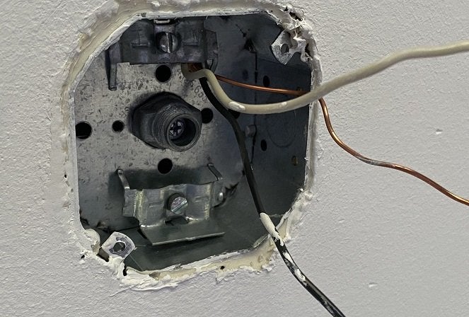

I likely put this in.... 15+ years ago. So I forgot what I put in there. Previously was just a ceiling light. That's likely a ceiling fan box, based on that thing in the middle?
(thinking now, I think the existing wall switch controlled 1 outlet of a 1 gang receptacle. I put the ceiling box in / wired it for the wall switch to work the ceiling light).
I could go in the attic, but there's 2 layers of insulation up there - 1 layer between the joists. And then I laid another layer going the other direction on top of the joists.
Looking through the holes, I see metal through 2 of them which line up with the ones that would have a bar going between joists (so more likely a fan box).
Side note - Maybe in another room or previous house, I remember running if you were wiring for an always hot line AND a switched line. The fan would have the always hot / controlled by the pull chain on the fan. And the switched line would be for the light (so fan can run all the time).
Did you do that also (run a hot AND switched line up there)? Do you do that now?
My memory is bad but I think in the recent past, I looked at a new fan with a remote and couldn't see how to separate electricals for light from fan... and still have the remote working? Or some other issue?

Based on the presence of the center stud the box could be mounted in a joist-to-joist hanger. But I do not know if that satisfies the requirement of a fan box.
Based on the lack of mounting studs inside the box (supporting the fan with screws in the ears is not acceptable) it appears not to be a fan rated box.
And based on only two current carrying wires it is not possible to switch the fan and light separately without a remote or pull-chain switches at the fan.

Your box looks very similar to this one. A standard electrical box with a bracket to mount it between studs.

AFAIK It is not illegal to have 2 branch circuits in a single box. It is not usually done except for specific uses like for dishwasher and disposer connections. However it can be dangerous. If the two circuits are not on the same phase it introduces 240 volts in the box. Also if not a MWBC the neutrals must be kept separate. If you have 2 circuits in a box you should put a warning note inside or on the back of the cover plate.
One of my very informal rules-of-thumb is that if a supporting flange is attached on one side only (as in the pancake box above), it is not a fan rated box.
The larger the screw, the greater the contact area of screw threads to box threads. My preference is a #10 screw. I also consider the thickness of the box material
314.40(B) says sheet steel boxes of not more than 100 cubic inches must be at least 0.0625" (1/16") thick. Exception 1 says "Listed boxes ... shown to have equivalent strength and characteristics shall be permitted to be made of thinner or other metals." (Ellipsis is mine.)
If the material is 1/16" thick (not listed using Exception 1), a screw with 32 TPI, will only have 2 threads of engagement. Not enough for me to feel safe.
