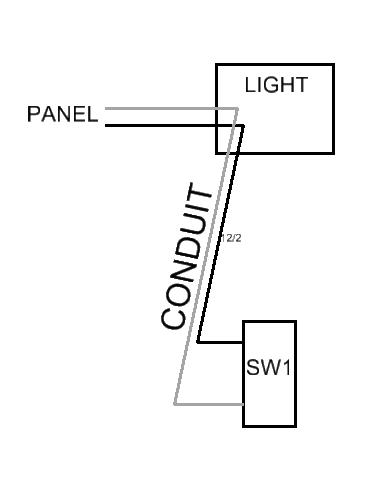

I came acrioss some online articles recently that I want to understand better and may be relevant in the way I have installed my home wiring. It is about how all wires for a circuit needs to be housed in the same raceway, and that wires need to be always in pairs (hot and neutral together), and how not having the wires in pairs may lead to overheating and electromagnetic interference EMI especially if the raceway is metallic like EMT, BX, MC etc...
I don't quite understand it, or the science behind it, but I do have my own wiring done in ways that the wires are not always together in the same raceway, especially on three ways and switch loops. So I want to show two examples below and see if the pros can comment on whether there are potentially issues with NEC, or have EMI problems, or even if code compliance but still bad practice. In my house, most wiring are done in EMTs with metal boxes, there are some NMB, and a few MCs.
To keep the diagrams simple and less clutter, I am not showing any ground, but ground is there, either as a ground conductor in the NMB or EMTs acting as EGC.

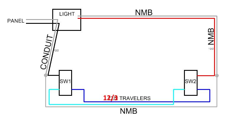

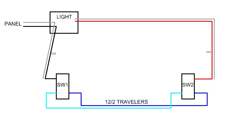

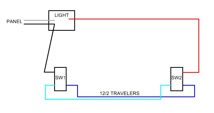

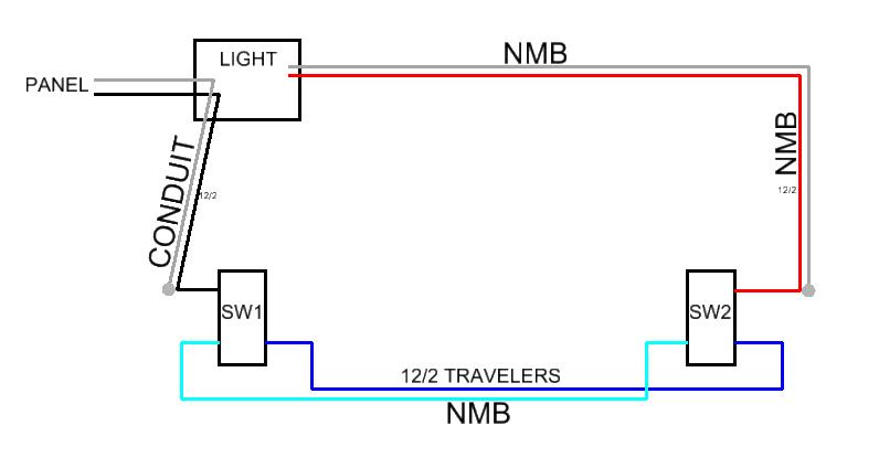

First example is three way wiring. In this case I have power going into the ceiling box where the fixture is. I then have the hot going to the SW1, a pair of travelers to SW2, and a switched hot going back to the fixture. In this case there is no neutral conductor going to switch box 1, no neutral going from switch box 2 back to fixture.
(1) Is the lack of neutral from fixture to SW1 and from SW2 back to the fixture is bad thing in terms of heat inductance and EMI?
(2) I know NEC requires a neutral in switch boxes since I think 2012, so in newer wiring I did carried a neutral conductor to switch boxes, but I have no need for the neutral at all, so that extra neutral is always capped in the switch box. So that capped neutral does not make it a "pair" because there is no current flowing through it right?
(3) The pair of traveler wires in it's own raceway, is that OK? does it need to be in the same raceway as the hot and have the neutral included. In other words, is the preferred installation is to have a 12/4 from fixture to SW1 to SW2 back to the fixture?

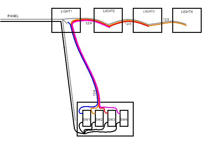

The next example is where I may have many fixtures in a room. It could be several sets of lights, or fan/light combinations and there is a multi-gang switch box. The power goes to the first fixture, then I would feed a 12/2 to the 4 gang switch box with the constant hot and neutral. Again neutral is capped since not needed. From there I run a 12/4 back to the fixture, each conductor of the 12/4 carries one switched hot for each fixture, as shown in the diagram below.
Again, the switch legs in a 12/4 are totally separated from the 12/2 feed. There is no conductor with current flowing in an opposite direction, nothing is in pairs. Is this an issue? If so if the 12/4 is in an EMT is it an even bigger issue?

The code requires all wiring to be contained in a common conduit or cable. (NEC 300.)
One reason is for over heating of wiring but that's more for commercial applications.
Wiring is contained within a single enclosure for troubleshooting and future modifications.
If you were to move out.... no one could tell how it was wired.
It could allow for several circuits to share the same neutral.
Your wiring will work... it's technically not dangerous... it's just not code compliant.

Why not add another neutral wire from the switch box back up to fixture 1? To any extent that conduit presents a problem, wouldn’t that solve it? Seems like it would.
In the first example, if I add a neutral from the fixture to SW1 and from SW2 back to fixture, it won't be sufficient because those two neutral legs are not doing anything being terminated in SW1 and SW2 right? I really need to carry a neutral from fixture to SW1 then along the traveler pairs to SW2 back to the fixture to complete the run I think.
Although I have seen so many implementation of three way with a lone 12/2 between the two 2W switches in books and in articles, with no neutral carried through, then they are all wrong?
In the second example again I need a neutral back probably, but the issue is the 12/2 and the 12/4 needs to be in the same raceway. There isn't a 12/6 cable so a conduit needs to be used?
As you've pointed out, there are lots of ways that work (as in the light goes on), but are not code compliant. Code is intended to ensure consistency and safety, and while many non-code-compliant installations work and may be reasonably safe, most codes are based on actual fires, electrocutions, or disasters that have happened in the past.
I'm sure someone with enough research could point to a handful of fires or other catastrophes that happened in the past due to separate conductors. Do I think your house is going to be one of them, most likely, no... but if you run the wiring in the way code specifies, we can all agree that there's a basically zero chance of any overheating or issues with unbalanced raceways.
Back to your first drawing, how did you even do that? Cables don't have a single wire, so it seems like a challenge to actually install that wiring in that way.
Your second drawing, conduit is one solution. But most residential electricians would run single 14/2 cables from each of the 3 switches to each light. 14/3 is used sparingly on most sites, and 14/4 is almost never used. (or 12ga of the same).
IMO, if you're going to continue doing electrical work, I would read up on standard practices. There's a lot of that isn't intuitive about the code and standard installations that are worthwhile to follow, both from a safety perspective as well as someone down the line looking at your work and not wanting redo it.

Well I didn't read Zorfdt's response yet - but it takes me so long to type I'll post this first and go read the good info. Here's what i wrote:
If conduit is not being used then I don’t see a problem with what you are showing in your diagrams. I don’t see why you would have to make any changes. I think the other guys will jump in if that’s wrong.
But if conduit is being used, then I think you don’t normally put cables in the conduit. You run individual conductors through the conduit. I think you are allowed run cables in certain cases through the conduit but fill capacity has to be considered and wet/dry location considerations. I think though generally you run individual conductors through the conduit. It is also easier to do it that way.
So, if conduit is being used in your diagrams, then you can always add a neutral conductor through any 2 points in the configuration, thereby paralleling hot and neutral. You can add the number of conductors needed between any 2 points, but fill capacity for the conduit has to be taken into consideration and calculated according to the NEC rules. You can increase the conduit diameter if fill capacity becomes exceeded.
In other words, if in your first diagram conduit is being used you would route the neutral as:
Panel neutral to Light Fixture Box-->Light Fixture Box to SW1 Box --> SW1 Box to SW2 Box -->SW2 Box to Light fixture Box-->Light Fixture Box to Light.

Forgot to say, if you do need to use conduit some time, you can get individual conductors that you can use in conduit at Home Depot (and I guess the other home centers also). They have them on spools, all different colors: red, black, white, green, etc. You just tell them the length and they’ll cut you a piece.
NEC 300.200 "Where conductors carrying alternating current are installed in ferrous metal enclosures or raceways, they shall be arranged so as to avoid heating the surrounding ferrous metal by induction. To accomplish this, all phase conductors and, where used, the grounded conductor and all equipment grounding conductors shall be grouped together."
The rule of thumb I was always told is you do not run one wire in a metal pipe. I suspect even the presence of another wire in a conduit is enough to disrupt the magnetic field induced by current carrying wire. None of this would apply to cables used these days.

added neutral wiring
I do remember now of seeing pictures of new construction where EMT was used inside the wall. Maybe they used EMT inside the walls because of a rodent problem in your area. I get mice in my walls sometimes and they like the intercom wires. Had to patch the wires several times. They haven’t gotten to my NM cables yet – I think.
The above picture is not good, just quick and dirty, but it’s what I was trying to say about adding a neutral wire if really necessary. Sounds like it is necessary by code, but it seems like some of the more knowledgeable people here wouldn’t be too concerned about it.
In your original picture above, it seems like it would have been trivial to add the neutral wire all through the conduit (like I tried to depict with the picture mod). I think that would be OK. I wonder why they didn’t do it. Maybe it’s a newer NEC requirement.
Imagine from the light to the switch SW1 is a conduit, and I have to guess at some point someone wants the three way switching so the wiring is added from SW1 to SW2 plus SW2 back to the light and those are NMB cables. For this reason I have some places I can add the neutral and some I could not do so easily.
Now, I did add a neutral from the light box to the switch SW1 because it was easy to do. But since hte neutral is not really doing anything, I capped it in the switch box. Now I think doing so does not really help anything unless I can carry the neutral from SW1 to SW2 back to the light, in other words to be along the entire run and back to the light.

Ah -OK, I thought that 3-way switch configuration already existed.
Yes it IS pre-existing. The 3-way switch configuration exist today. I think there is a misunderstanding.
This is a house with multiple owners who have gone through multiple iterations over the years, but I am speculating here that originally, it was a single pole light like below. Power goes from the panel to the light via a conduit, a switch loop was sent to the wall switch box in conduit.
[[img]https://i.postimg.cc/nrHRnLjp/SW1992.jpg[/img]
Later, someone wanted the light to be wired as a 3-way. The three way wiring was added and it looked like this. The travelers to the second switch and from that switch back to the light were done in 12/2 NMB. Probably done a while ago, at least as old as when #12 NMB was still using white color sheathing.
[img]https://i.postimg.cc/FzDPzQ3c/SW2.jpg[/img]
Then at a later time, someone came along and tried to do something else, what I have no idea, but whatever was done, they messed up the three way wiring, so it no longer worked as a three way, but the first switch still work by itself, and the second switch was a mystery switch that no one knew what it was for.
Then I came along and bought the house. I opened up the switch boxes and figured out they incorrectly wired the switches, and I fixed it.
Then I read about the need to carry a neutral along with the travelers, about EMI and heat inductance etc...which prompted me to think that I need to add a neutral between SW1 and SW2 so that the neutral is carried all the way through the run. Like this:
Hence the reason to start this very thread because I basically have two questions.
(1) Is it necessary to add this neutral conductor because it means changing the cable between the two switch boxes from a 12/2 to a 12/3. It is NOT an easy change so I don't want to do it unless it is necessary.
(2) If it is necessary, then the neutral runs along the constant hot to SW1, along the travelers to SW2, and along the switched hot back to the light fixture box. Now, at the light, you have this neutral "twice". The neutral that comes from the panel, and the neutral from the end of the switched run. Which neutral should be connected to the light? I am thinking the one that is paired with the switched hot, or may be it doesn't matter. Does it?
I hope this makes it clear.

The answer is that NEC requires you to add the neutral, so yes you should, according to code, add the wire. But I think some of the knowledgeable folks here don’t think you have a dangerous situation in the least. It’s just that the preferred method would have been to include the neutral. So, I think the answer to “should you or shouldn’t you” – is just personal preference. I think I would just let it be, although I can be a fussbudget and would probably wrestle with the question myself – just as you are. But I think I would not worry about it.
However, in some instances I have pulled in a new cable by taping the new cable to the end of a current cable. I overlap them by several inches and tape them really good and as flat as possible. Then I go to the other end and pull in the old cable and the new comes along with it. But you do have to be careful that the taped connection doesn’t come apart in the wall.
I just pull very slowly and very gently and am ready to reverse the process and abort the operation if I feel a worrisome obstruction as I pull. I’ve done it several times. But whether it would be worth the trouble in your case – I don’t think it would be.
But I don’t understand the question about connecting the neutral in the fixture box. The whole point of running the neutral wire all through the circuit -if you were to do that - is because you want the neutral to be used in the conduit. If in the light fixture box, you connect the neutral from the panel directly to the light, then you would bypass all the new neutral wires that you would have added. So, you would have thrown away all your new work, although the light would work properly with the switches. But that wouldn’t make sense.

Adding a splice in the fixture box to use the neutral closer to the panel will work electrically, but will render the effort of adding the SW1 to SW2 neutral segment useless because the purpose of adding it is to have that parallel return current.
But I know I have seen x/2 run between three way switches all the time in older installations, so this current imbalance and EMI is probably not a significant issue.
I believe technically speaking, right now, I am incompliance with NEC in a sense that NEC requires a neutral in every switch box. I DO have a neutral in both SW1 and SW2. They are both capped.
You can remove the box from the wall without enlarging the hole. I have plaster walls and I do it. You would just replace the box with a new work box. Those are cheap. But I’m not saying you should run a new cable with a neutral from SW1 to SW2. But you would have to do that to be technically – or I guess actually – code compliant. But again – I’m not suggesting you do it.
I have the NEC 2002 and section 300.3 and it basically says all conductors of the same circuit should be in the same raceway, etc. You only have one section of EMT, if I understand, it’s from the fixture box (or junction box) to SW1. But that is enough to make the requirement relevant.

I think that’s what I said. So, I’m a little confused. Are you confirming that is correct, or are you asking me to re-confirm that is correct, or are you informing me that is the correct way to do it? As far as I can tell that is the correct way to do it
(1) There is a neutral in each switch box SW1 and SW2.
(2) The neutral is paired with it's respective hot along the entire path so the inductive heat and EMI is cancelled.
(3) That the light fixture must take the neutral from the end of the run even though the neutral is already there from the panel once in that box, in order to make #2 happen that panel neutral must just pass through the box.
The present condition I have I am not sure if I violate NEC. I do have a neutral in each switch box, but they are capped dead. Actually I believe SW1 does not even need a neutral as NEC says if one can be pulled in the future it doesn't need one. I most likely will not try to run a new 12/3 between SW1 and SW2 as that's just too much work.
I didn't realize a regular switch loop (with no neutral) has no EMI because that loop has current in opposite directions and there is no EMI even without the neutral. But a traveler pair does.
