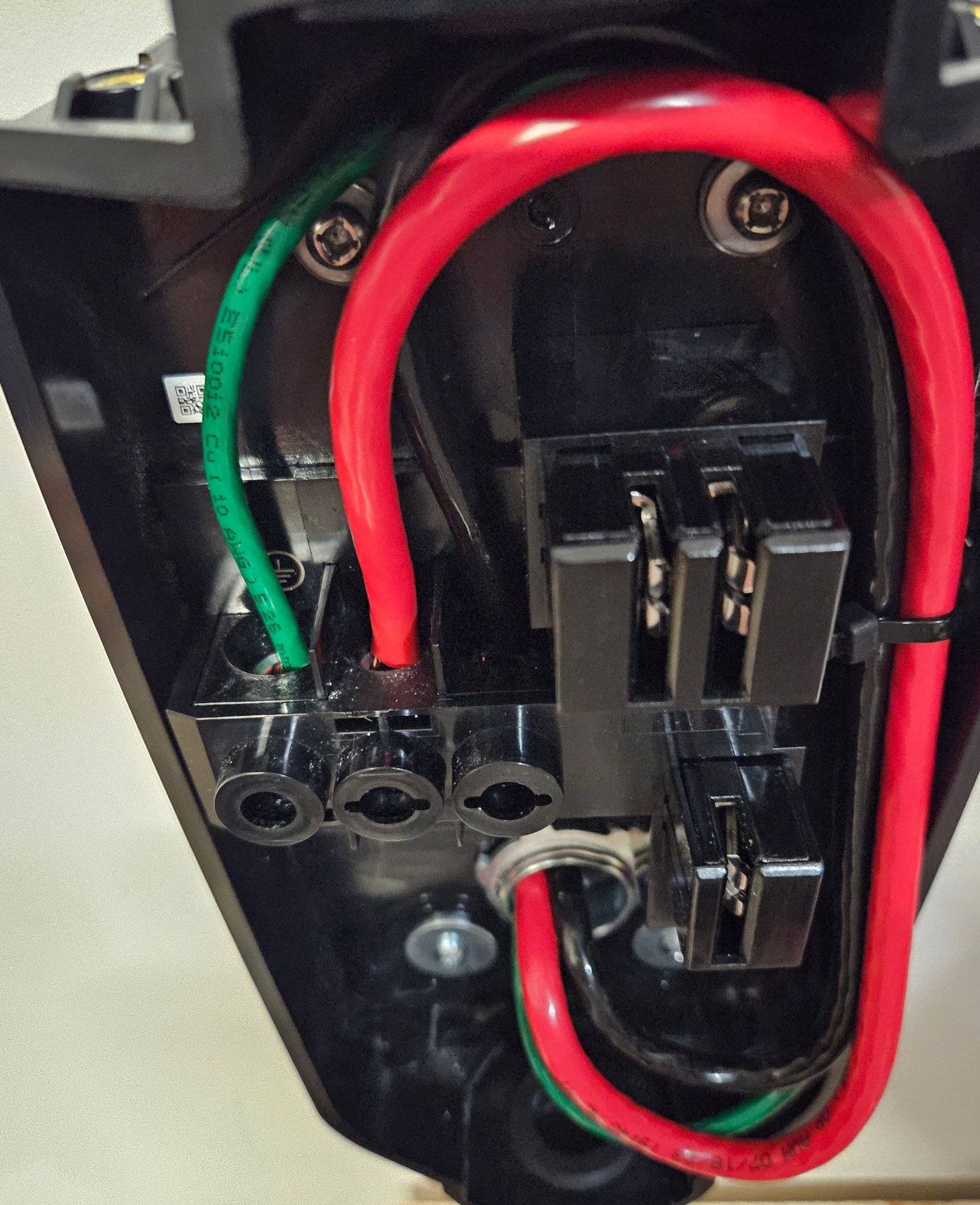

Old 10-09-23, 09:18 AM
S
Join Date: Oct 2023
Posts: 5
Received 0 Upvotes on 0 Posts
Main body of the charger mounts on top of the black plate. There are 3 raised blocky area that transfer power to the main body. Main body is held by 4 screws. I guess you guys are right. The entire device is meant to be its own disconnect.
The photo was taken slightly crooked and exasperates the tilt on the unit.
Panel wiring is also below.
