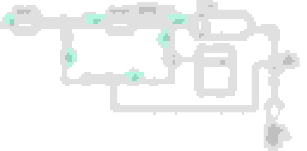

I am trying to decide where to position the chlorinator cell (CC). Ideally it's the last item before the water flows back into pool. But looking at my setup here, seems I have to reposition owing to pipes being too close and limiting space. Secondly, I think I don't quite follow the manifold 5 ports. I can see two pipes attached to the filter, must be in & out. At the manifold, I see what I assume to be port out to filter and port back from filter, the other 3 I can't make headway.
Heater failed during a freeze, cracked leaks water. For now I just installed a u connector to bypass heater and keep the pool running. The water coming back from the heater seems to be sent back to the manifold. That's why I am thinking of positioning the cell on the left pipe near the pool heater. I am fairly confident this is where I should install the cell & flow switch. Any ideas guys?

Old 11-22-23, 06:15 PM
PJmax's Avatar
Join Date: Oct 2012
Location: Jersey
Posts: 63,843
Received 3,748 Upvotes on 3,361 Posts
You want to use that contactor for the chlorinator ??
No.... you don't want that there.
Go back and look at the picture in post 8 again. I redrew it for you.
I'm guessing the heater is not working and has been removed from the circulation loop ?
Light blue is water into the pump (suction).
Medium blue is pump out to the selector valve.
Dark blue is water out of the selector valve (return) and supply to the heater.
Purple is water out of the heater and back to the pool.
If you intend to reconnect the heater... the chlorinator must be in the purple line.
You can't run the chlorinator into the heater.
I also see a valve in the purple return line to the pool.
I drew the red circle for the flow switch but it can go just about anywhere in the return system.
Old 11-22-23, 08:36 PM
B
Join Date: Sep 2011
Location: usa
Posts: 391
Received 5 Upvotes on 5 Posts
Thank you thank you, thank you, for the flow diag. It's the waste pipe that had me stumped. Urgh. Now everything makes sense. I will position chlorinator on the purple line and the flow switch right after

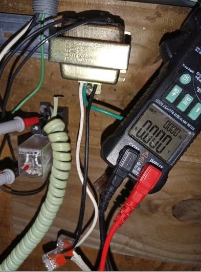

Old 11-23-23, 10:46 PM
B
Join Date: Sep 2011
Location: usa
Posts: 391
I brought this into the garage and made this rig. I am just getting a barely 2v output still. Switched the bases and still the same result. Checking voltage at 2 & 6 is showing 120vac but when it's turned on there's only 1.8vac at 2 & 4. I switched to 1,3,5 and it was the same result. Think I need another relay.
Old 11-24-23, 07:25 AM
B
Join Date: Sep 2011
Location: usa
Posts: 391
A little more details on first pic above
Old 11-26-23, 12:10 AM
B
Join Date: Sep 2011
Location: usa
Posts: 391
Solved!
Ladies and gentlemen, we got him! The relay diag shows-the wiper swings between 2 & 4, therefore 6 is the common pole. Thus,
6 is common.
2 is NC
4 is NO
Moved the 120v wire to 6 and 4, energized 24v and boom 120v was on at the power strip. Worked flawlessly.
