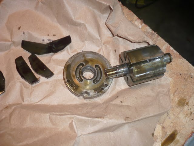

Impact Wrench Disassemble with pics
Pretty easy. Once I took everything apart, I just used some clean rags and wiped everything down, and then liberally used some air-tool oil on everything.
Works great now!

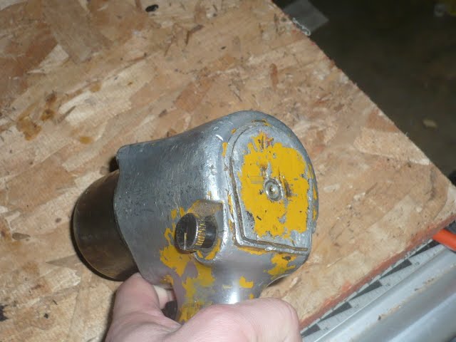

Here is the impact wrench. There are 3 allen screws holding the bell housing on to the handle/body.
Once you remove the bell housing. everything will just fall out, so be careful.

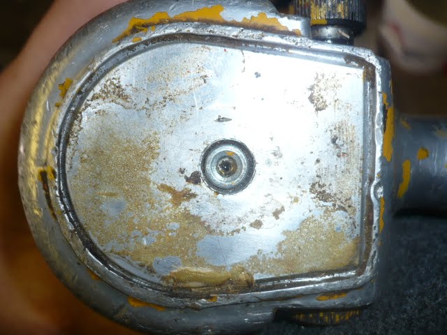

This shows what I guess is the end plate. Is that a zerk fitting on the back? I wonder because inside it looked like there was wheel bearing grease on the inside of this plate:
Here is a close up of it:

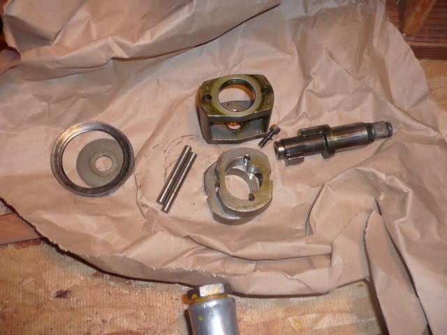

Here is what is inside the bell housing,
and here is what it looks like disassembled

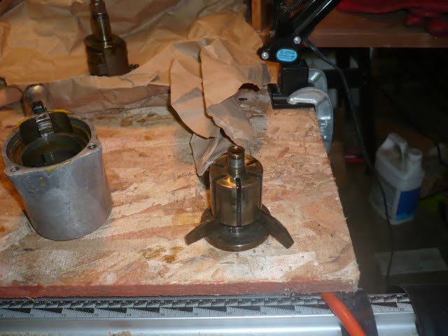

Above the trigger, and before the bell housing, you have this cylinder that has blades that slip in and out of their slots. as air goes through the handle, it catches these blades and drives the spinning. The blades on the left if this pic slip into the slots of the cylinder on the right side of the pic.
You can't see it, but in the above pic under that disc, center page, there is a bearing. It was sort gummed up. I just blew it out with some strong air, and lubed it liberally with air-tool oil.

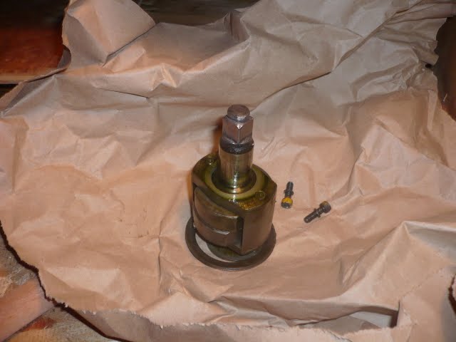

Below is another picture of the blades and cylinder
I didn't undertand it until I was putting it back together, but housing that this cylinder lives in is not a perfect fit. The housing is sort oblong, and this cylinder with it's blades fit tight up at the top, but loose at the bottom. So as the cylinder spins, when the blades are at the top of the wrench, they are fully retracted in the cylinder. But the at the bottom are slightly hanging from the cylinder so the air catches them.
My bet is that it was these blades not slipping in and out that was why the impact wrench wouldn't spin

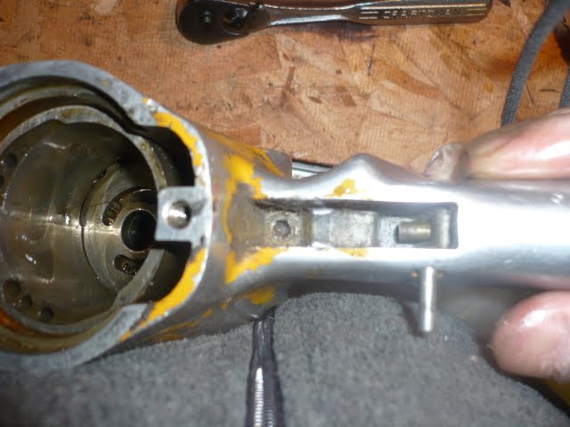

Unfortunately, I couldn't get all of the wrench disassembled because behind the trigger, there was a allen screw that was starting to strip:
My only question aside how to use the 'zerk' fitting on the end plate is what is at the bottom of the handle, next to where you join the air hose attachment? It's got an allen screw and just slides out. Not sure what it's for. To add oil?

the end plate is actually that piece you speak of in pic #5 where you state there is a bearing in it.
the zirk is to grease that bearing
the screw at the base of the handle, not real sure. I'll have to do some looking.

So, that is what I thought about the zirk zerk fitting. But it doesnt' look like a zirk that I'd see on a car, for example. What sort of attachment would grease that fitting? And what sort of grease should be used?
it uses a needle type injector like this
as to the grease? again, not sure. It's been a long time since I rebuilt mine or even used them.

good job
Congratulations on getting 'er running again.
Strange place for a grease fitting though. Go light with the grease in there, I suspect the air blows it right into the motor, making things "sticky" in it. Sears usually has the needle you want in their automotive section.
Needle injector lubes rear bearing, Screw in handle is to put oil into wrench, Been years since I took one apart. I always just squirted oil down the air fitting
same here.
and yes, over greasing the rear bearing will give you a lot of grief. The excess will end up in the air motor and, at the least, reduce performance.
