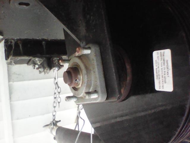

need to get bearing flange unit off shaft
I have this same exact bearing "flange unit" as shown in this link, installed on a shaft on a hoist which I must fix. I need to remove this bearing unit off the shaft. I got it unbolted and removed the two set screws and did some manual hard pulling and prying but it does not want to slide off the shaft. The outer iron gray part starts to budge/move outward with my pulling/prying but the inner bearing or seal (which is beneath the black colored thin metal protector cap around the shaft in the picture, and which I have removed already) seems not to budge at all and is what seems to be preventing the unit from just sliding off like I'd want it to. Anybody know what the trick is gonna be to get this off the shaft? Do I need a puller to do it? And if I do need a puller and get it pulled off, then I suppose a new one would have to be pressed on afterward? Any comments/advice appreciated.

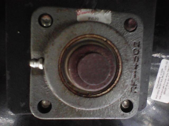

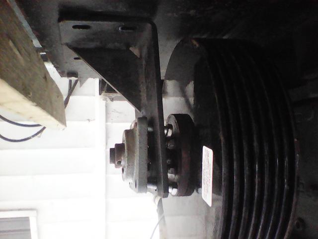

Old 06-28-19, 08:48 PM
sgull's Avatar
Join Date: Nov 2007
Location: AK
Posts: 2,757
Received 1 Vote on 1 Post
Below are some photos of the bearing flange on the shaft and with the mounting plate loosened. This is how it looked when I left it last, after I'd been struggling to pull and pry (evenly) but couldn't get the bearing to even begin to budge. My plan (tomorrow) will to apply the penetrating oil to the bearing and shaft, as suggested, and try again. I'll be applying pressure behind the mounting plate, as I did before, which is kinda the only way to try to push the flange off. I certainly hope the plate and bearing don't separate; so far it has almost acted like it could, even though it doesn't look it will.
Old 06-28-19, 09:08 PM
PJmax's Avatar
Join Date: Oct 2012
Location: Northern NJ - USA
Posts: 54,641
Received 516 Votes on 486 Posts
You've got problems..... major rust. I don't think the rust eater will do it. Try several applications of it and let it sit a bit. You may need to bring in a torch to burn the rust. It will destroy the bearing but it's getting changed anyway.
If the bearing splits..... use a puller.
