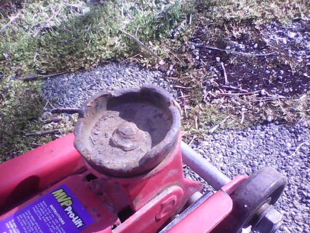

Looking for suggestions on practical/easy method(s) I might be able to cut/shape a standard hockey puck down to 2" diameter from its normal 3" diameter. This is so I can fit it onto my floor jack saddle, which is a 2" diameter. Hockey puck is an inch thick. What tool(s) and/or methods might make good sense to accomplish this?

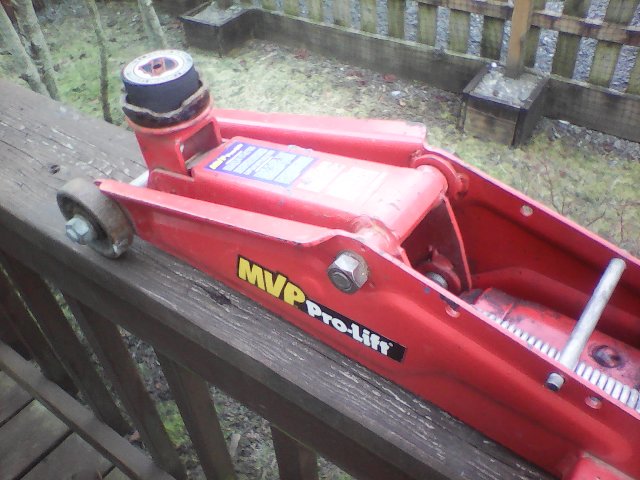

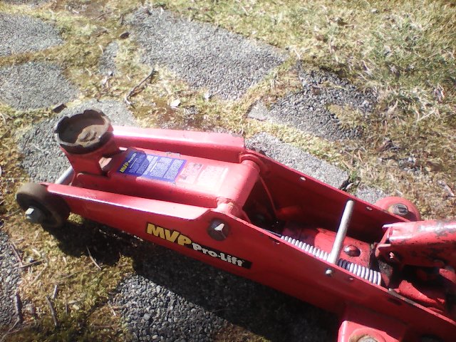

What kind of jack do you have? Amazon has bunches that will fit most anything...
This kind/size of jack (pictured). 2" diameter saddle. I did already look at all those on Amazon; most all of them don't really look like they'd fit in my jack saddle and/or they wouldn't fit right over/into the pinch weld like they're supposed to (2016 Nissan Versa).

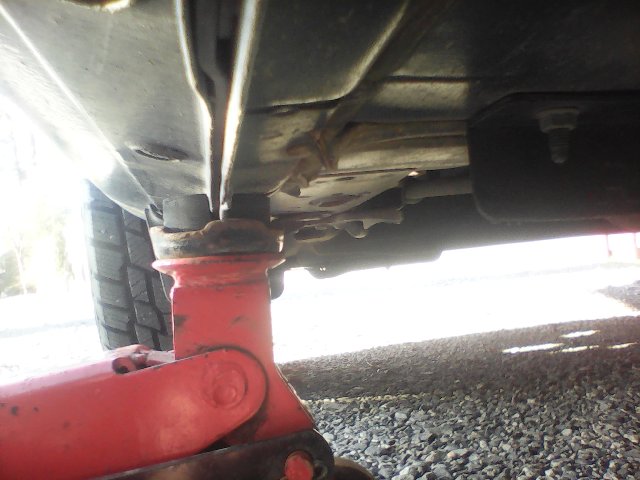

Yes Marq1, the 2" hole saw was the ticket! Worked easily that way for me. Photo below shows the puck cut (with the hole saw) to fit pretty good there in the saddle of my jack. I then cross- cut a notch (or groove) in the puck so it would fit over the pinch weld.
You can do this if you have a jig saw. Take a foot square piece of 1/2 inch plywood and drill a hole for the blade to pass thru in the middle . Screw the jigsaw base to the plywood. Drill 2 holes in the puck. One in the center of a diameter for a tight fit with the securing nail/screw. The second hole is 1 inch from the center hole and of diameter to allow the jigsaw blade to pass thru. On the side of the plywood opposite the jigsaw, drop the puck over the blade and attach puck to plywood using the center hole with enough freedom to rotate the puck. Secure the piece of plywood, power the jigsaw and cut away.
That probably would've worked fine too, thanks. But as mentioned, I went the hole saw route and it worked out good.
Below is the puck, with the groove in it now, shown in action. Works fine and dandy as far as I'm concerned.

Probably depends on the situation with the type/model of car and the style of pinch weld designed in. With my particular jack and my particular homemade adapter for the pinch weld for my car, I'm quite satisfied now with how it worked out and not reluctant about it all. I wanted to avoid crushing/bending the pinch weld with my jack saddle cup which was my need for this. Once it gets all crushed/damaged it just becomes a problematic and potentially unsatisfactory and/or un-usable jack point for either the floor jack or the scissor jack that came with the car. If you look on Amazon for example you'll see plenty types and sizes of pinch weld jack adapters for sale for floor jacks for basically the same purpose as I made mine out of a puck. Not sure what you mean by lunch welds.
