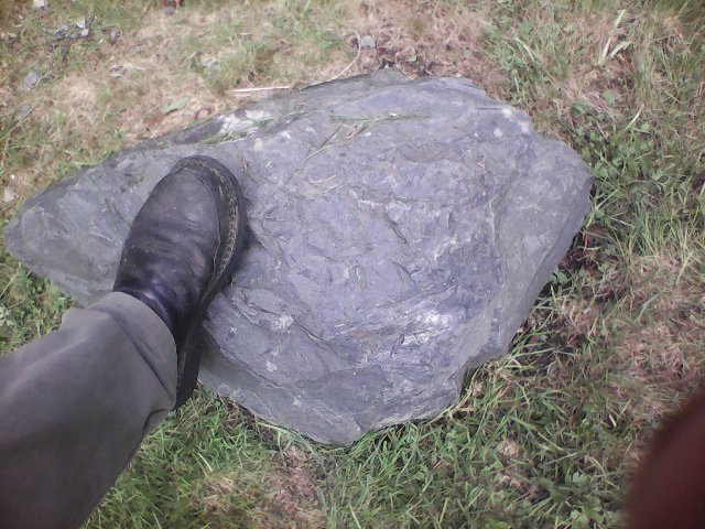

This single giant rock in my backyard goes down into the ground another 6-8 inches. I'd like to be able to bust it up somehow into carry-able sized chunks and get rid of it. I have a regular long handle sledgehammer I've tried in the past to see if it might start to crack if I whacked on it but it doesn't. I suppose if I rented a jackhammer that might do it but before I go that route and spend the money just asking here for any other feasible suggestions but not crazy ones like blasting it or whatever.

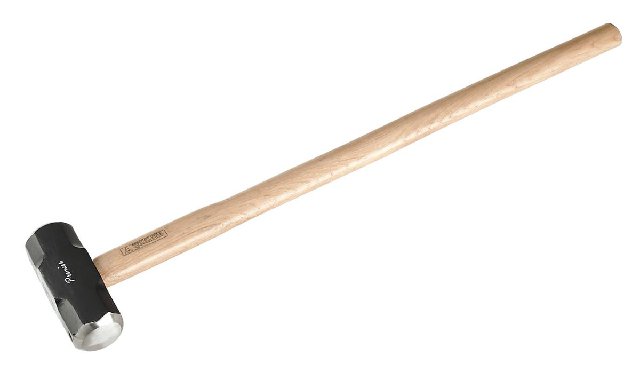

You'd need a big (aka heavy) sledge hammer to break up a rock of that size,.

Only chance you have to break it into 4 pieces with a sledgehammer is to rent a diamond saw and cut across it twice (+) as deep as you can to weaken it. And its possible that hitting it while its on the ground will do nothing except wear you out. The ground will absorb part of the shock of the sledgehammer. If you could somehow flip it up or drag it onto the driveway in order to smack it, you might have better results.

I'd go with lift and relocate, and only break up if necessary.
1) Looks to be around 200-250 lbs. (average 150 lbs per cubit foot of stone) so moving is still workable.
All you really need to lift is a standard steel pry bar, a pivot, and some scrap 2x4 as cribbing to support the stone as you excavate it. Once the stone is lifted, slide an appliance dolly into the hole, snug up some tow chains or cargo straps to hold the stone to the dolly, then leverage the stone up and onto some 4x8 plywood. You can then use the prybar to "creep" the dolly fully onto the 4x8 sheet. Lift and roll, using a second sheet of plywood to roll to the next location, repeat as necessary.
2) On the other hand, once the stone is out of the ground, you can try laying it across the pry bar and then try to split it- stone in compression is hard to split, out of the ground where it experiences tension, it is much easier to split up.
3) There's IS a much more civilized method though. Dig out the soil around the rock and mound up a trench around the rock, so there's a moat around the rock. Collect several nice logs and/or split firewood. Light a nice campfire on top of the rock. In the meantime, fill several coolers with water and ice. Invite friends, fill coolers with beer, add a campfire grill and enjoy burgers, steaks, and smores; all while keeping the fire going as a good bed of coals. Might take several hours.
After you're done with the "social distanced picnic" let the fire burn down to a bed of ash, pour the coolers of ice-water onto the hot rock, and it SHOULD shatter into workable pieces thanks to heat shock.
Repeat the next day if necessary.
There will be lots of steam, so wear long sleeves, work gloves and eye protection. Just before you pour on the water, you might want to toss on some wet burlap bags to catch any spalling rock fragments.

What KIND of rock is it? Looks bluish, quick googling of AK geology shows mostly sedimentary.
I've seen that bluish color in 3 sorts of rocks
1) blue shales - tough to split, easy to fracture with heat.
2) baked 'metamorphosed' shale tough to split or fracture.
3) limestone. tough to split, very easy to fracture with heat (e.g. just makes lime)
Take a look at your local county geology maps, that should guide you in what approach to use.

It's just a stone. Triangular, but looks to be around 2.25 cubic feet so around ~300 lbs.
You just need a prybar, and a sled/sledge
Or, dig out around it and post an "Atlas Stone" challenge at your local gym

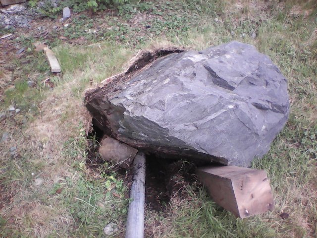

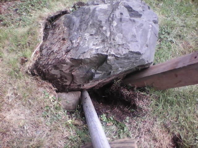

Progress report: Managed to pry it up and out of it's hole to this position using a long pipe and some blocks. Seemed to be too heavy/bulky to budge out any further by myself. I think with more weight (another person) helping to push down on the pipe/lever, it might come all the way out and at least be out of the hole. I saw these same kind of rocks, but much smaller in size, I suppose they might look a little blu-ish in the photos but they're actually just gray, along a river bank not far away, they were probably left from some dredge work in the past. I remember wanting to clear a better walking path toward the river from the trail and decided to take my sledgehammer down there and see if I could bust up some of the bigger boulders. I was surprised that most of them did actually did usually crack/split with several good blows with the sledge. But those weren't huge like this one.

Excellent work.
Bottom photo- seems like you have a promising joint in the rock, running from the steel pole up towards 1-o-clock. With the stone suspended as it is, might be worth a few good whacks moving along that joint.

Well that's encouraging...
I've got nothing to lose. I'll go ahead and give it a whack.
Actually a few good whacks.
Tomorrow!
