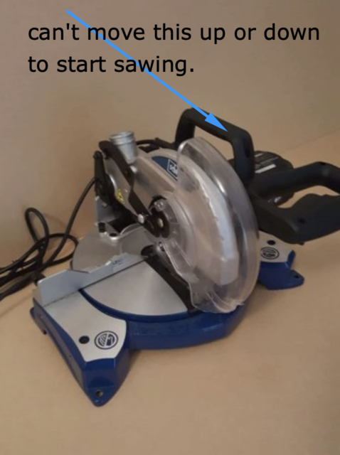

I am unable to move it up or down. Not sure if there's a screw i have to loosen first. The manual is not very clear. This is my first time purchasing electrical tools. So i'm completely new to the installing part.
I have the scheppach hm80l circular saw.

There is a latch on the back side of the saw that locks it in the down position to make it easier to carry. Release the latch and you should be able to move the saw.

Could you tell me where at the back? I took some additional pictures.

Pretty sure you yank that knob out with your right hand while applying slight downward pressure on the handle with your left hand. You need to pull that pin out of the hole it is in.
Also, that's called a miter saw.

The "button" in your third picture looks to be the unlocking pin, it should pull outward and turn to line up the pin in it to hold it in the out position. With the zero experience you have I'm wondering if you should even be using something like this saw without getting someone to guide you BEFORE you severely injure yourself. Fingers can be lost in an instant along with all the other hazards that can be encountered using power saws and some body parts cannot be repaired or replaced.

You guys solved it! Indeed i had to pull it outward. Meanwhile i was twisting it until it simply came loose. I'm an idiot.
