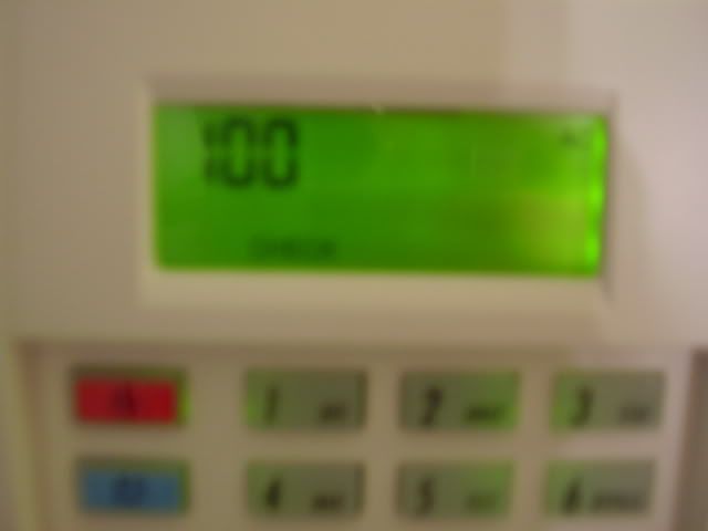

ok, here is a little more info....
when i plug in the system, it beeps a couple of times and then d1 comes up... then
I get these on the keypad....btw, can anyone tell me what keypad I have
then d0
then 01 FIRE ALARM
then 100 Not Ready
all along it says AC in the upper right hand corner...
any good news?

It's a fixed alpha keypad, probably a custom version of the 6150.
All of these indicators are in the install manual. Websearch using the phrase "Vista 15p installer manual".
D1 is the initial power up indicator as the system boots.
DO means Dialer Off -- the dialer is disabled
Check 100 means that the wireless receiver is not being detected, or you have wireless zones assigned in a system that has no wireless receiver.
The fire alarm showing means that somewhere in the house you have a heat or smoke detector that is stuck in alarm. For smokes, look for a solid lit LED, for heats, if the little disk shaped heat sensor on the bottom has been broken off, the device has to be replaced.
The DO is not a good sign, that generally pops up if a system has been shut down using the download software. It's not sticking at D1, so they may have shut off the dialer because of the unrestored fire alarm.

Ah, there's the information we should have started with...
If this panel came to you used, before you connected anything, you should have defaulted the panel.
If may be sticking because if you have contacts on the zone 1 input, it's default configuration is for smoke detectors, so you are booting the thing into a fire alarm condition. Once in alarm, you cannot access programming.
Take the contacts off of zone 1 and put a 2k resistor in their place. Then try seeing if you can get into programming.
If that doesn't work, I would suggest seeking your money back. Used security hardware is often not the bargain it seems to be. I have seen too many cases of people selling off systems that are locked out, missing critical documentation, or just plain damaged.

Old 04-24-08, 11:26 AM
kcxj's Avatar
Join Date: Sep 2006
Location: Kansas City, MO
Posts: 928
Yes, zone 1 MUST have a 2k resistor in series on the circuit. Good luck.
