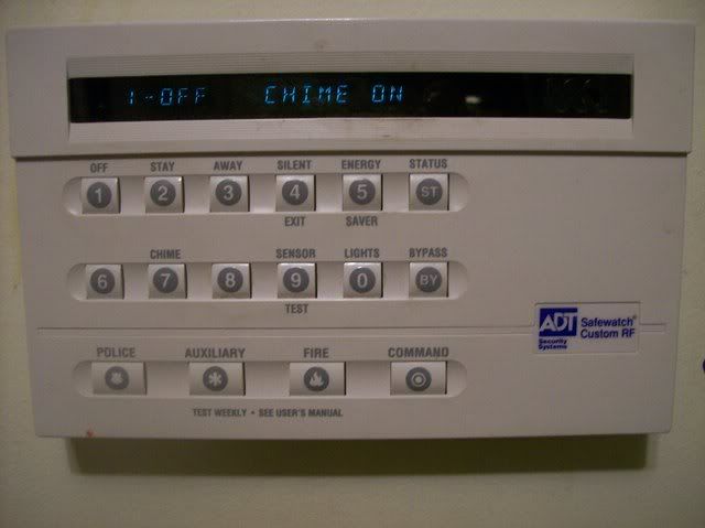

ADT Safewatch Custom RF
I have had this home alarm system for approx. 10yrs. I had it installed when we bought the home we live in now . The system was always calling the locakl sheriffs dept. and ADT could not figure out the problem so we worked out anb agreement where i bought the hardware and did not have any monitoring by ADT. I have an external speaker on the outside of the house and we do use the system when we leave house. I have had to replace the batteries in some of the door sensors and the break sensors. Recently when I go to arm the system it says sensor 7 failure ...system battery failure .
I checked the batteries in the sensor 7 window break sensor and the lights and everything work fine on the sensor but when i open the door to look at the settings the beep beep does not go off on sensor 7 like it normally would .
Can you tell me how I can delete that sensor 7 or get the system to detect it and the mod # on the main touch panel is
Model 17...487242 and it says ADT Safewatch Custom RF on it .
I am sure that the system battery failure is the back up battery in the main panel which I can replace that .
I would appreciate any any and all help .

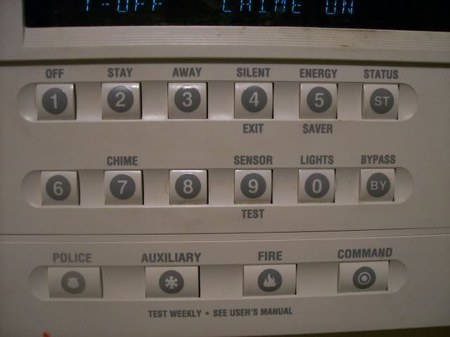

Yes it looks very similar ..Here are some pics

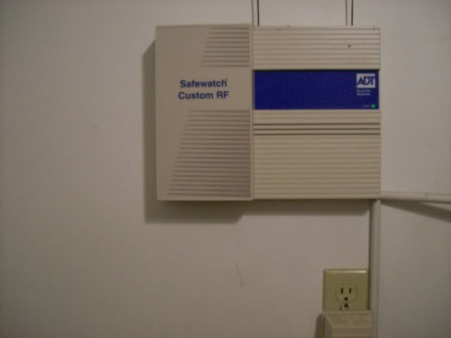

Lets try a different tack: Is the box in the closet with the battery like the one in the manual in the link with the digital display on the surface, or is it a thinner, flatter box with a plastic shell and no display?

The panel that has the battery backup in it for the main panel has No display, here are pics of it .
I am sorry , when I have refered to the main panel for the last 10yrs it has always been the touch pad panel not the panel that has all the main circutry in it and the back up batttery for when the power goes out. I hope these pics helps.

There we go. The true identity of your system is a modified ITI Caretaker Plus system. ADT called it "Safewatch Caretaker Plus" User manual: http://www.adt.com/wps/wcm/resources..._caretaker.pdf
The ADT modified version has a lot of hard coded defaults and are notoriously difficult to try to modify the programming.
On the plus side, _most_ of your wireless transmitters are compatible with current generation GE Concord family and Networx wireless.
Try giving the installer manual a read through and see if you are willing to tackle it: http://www.baipeaceofmind.com/Techni...r_46-504-h.pdf

In my copy of the manual it's on page 4-26.
Once you have access to programming, you press BYPASS or STATUS until the display shows "delete sensors"
Press COMMAND
Then press STATUS or BYPASS until you get the sensor you want to delete.
Press COMMAND
It will confirm the deletion
Exit programming
