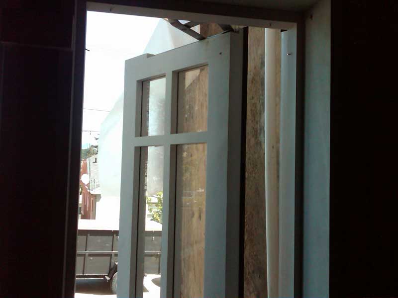

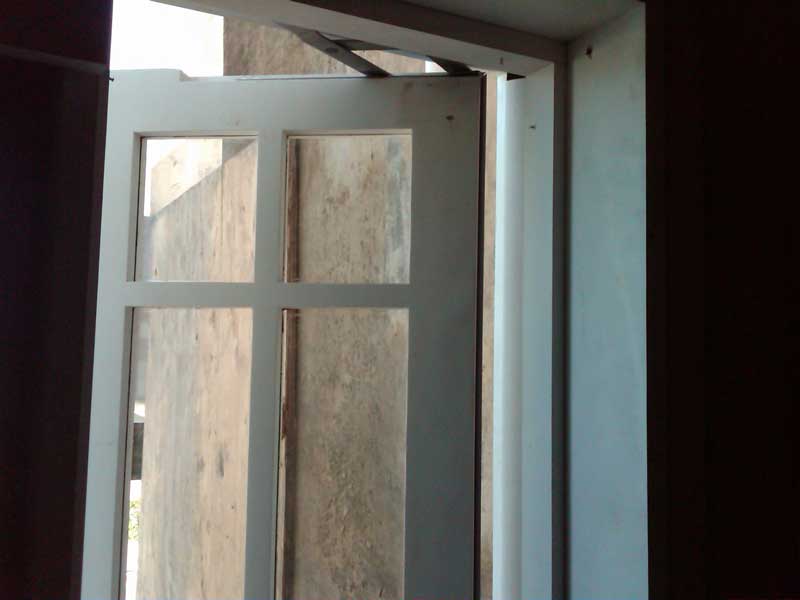

Hi all,
I've got a basic question regarding wiring up window contacts, on windows which will likely be left slightly open on a regular basis to promote ventilation.
The windows in question are all ground-floor casement windows. Please see the attached photos.
I can place sensors inside the jambs on the hinge side of the windows. This would allow each window to be left open as much as four or five inches and still be seen as "closed" by the system.
Alternatively, I can place sensors on the opening side of the window, in which case they'll appear as open almost immediately.
One other option is an "all in" where I install two sensors per window.
Here's my dilemma: we WILL leave these windows cracked open intentionally when home at night. But there is a good chance somebody will leave them open during the day when leaving the house.
If I go with the two-sensor option, they'll alarm if somebody tries to fully open a cracked open window, but the system will also remind users (via a faulted zone) if a window is unintentionally left open when leaving the house.
The pictures show a window in a partially open and fully open position. A sensor on the right side of the frame will be in range of the magnet while allowing a modest amount of opening.
Thanks in advance for lending your opinions on the matter.

For that style of window, the hinge side location is a bad idea.
When casements are closed, they are fairly resistant to being forced open, when partially open like that, a knowlegible crook could easily defeat the contact.
If you really want to do the window open, the two contact route is probably the "safest" option.

from the pic, it looks as if a person could enter the window even in the partially open position without opening it any further.
I would think a beam obscuration type sensor would provide a better system for detecting intruders. I do not see an curtains or blinds that would have to be considered but should be if present.

These are very narrow windows -- about a foot wide for the one pictured.
I think I understand the concept of the security screen, and since these windows open outward, there would be no way to operate the window through a screen--not that I'd want one, due to appearance.
The beam is an interesting idea, though we would have to pick window coverings carefully.

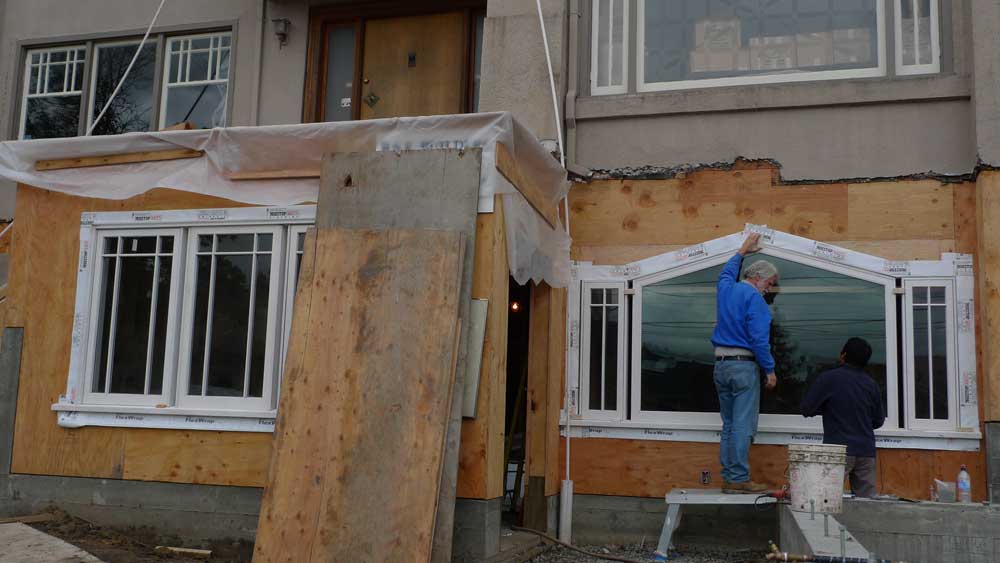

Yeah, the opening in the photo may be a bit narrow, but the others increase in width, for a total of 7 opening windows on the ground floor.
Just for a little perspective, the window from the first two photos is immediately left of fellow on the platform, and it's the narrowest. The three under the front door are the widest (24"), and the others along the sides of the house are somewhere in between.

The way in envision it is as follows:
Window completely closed, both contacts are closed.
Window slightly open, one zone faulted. This sensor would be set as a quick bypass-enabled zone (Vista 20P). It would show as a "fault" on the panel display so everybody knows to secure the window if they are leaving the house and arming the system in "away" mode, but would be able to effortlessly bypass it if armed in "stay" mode.
If the window were all the way open, both contacts would be open, and I wouldn't allow the system to arm. I believe I could set up "chime" mode on the first floor so that if a window were opened out of range, the person doing so would immediately know it.
Of course, this uses up two zones for each set of windows (I'm wiring them as pairs at the two front-of-house double-casements, plus three solo windows on the sides, for a grand total of five added zones to moniter), and that will probably mean I must add a Vista Zone Expander Module (figure another $75).
As for opening/closing windows when the alarm is armed in "stay" mode, I don't see this as being any different than operating a conventionally-wired window in stay mode. Isn't the idea to allow interior movement, but monitor the perimeter doors and windows? And they'll actually close without having to disarm the system.
