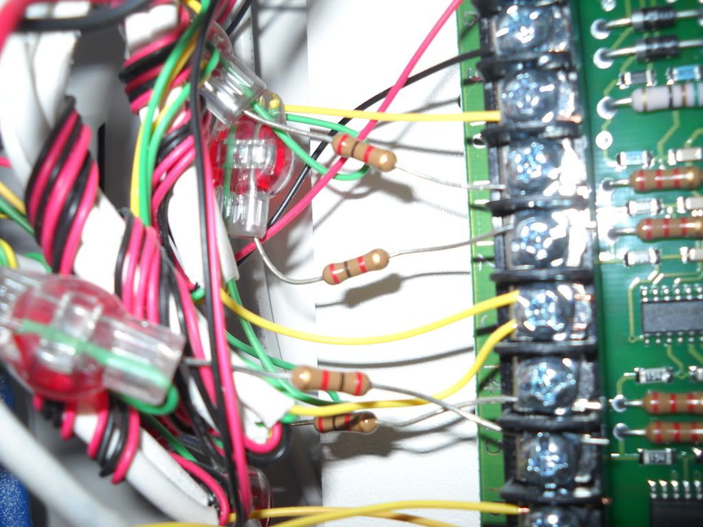

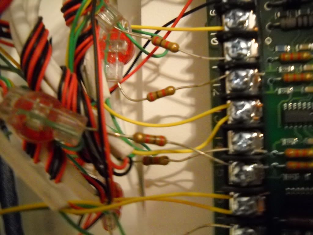

I'm not exactly sure what the EOLR's look like, but I will explain my control box to you. There are several wires (obviously) that come into the control box. A red wire, a yellow wire (there are several yellow wires), and a black wire are connected directly to the circuit board. Also connected to the circuit board are these "pieces" that have a solid metal wire on each end with a small brown bulb in the center. The other end of these pieces are connected to a round red plastic piece. These red pieces also have a green wire connected to them (I'm guessing this may be a splice or crimp).Some of these red pieces have a green and yellow wire connected to them.

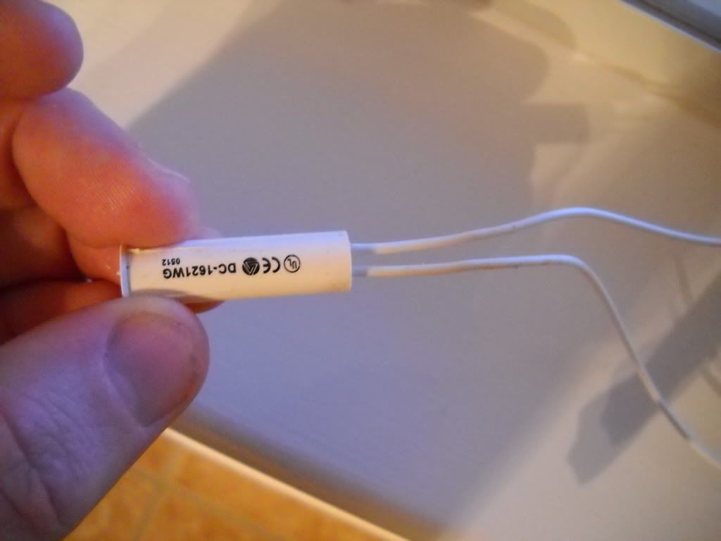

I was able to get one of the senors out of the window frame; all it had was two white wires coming from the end of it. All of the contacts in every door and window are the same. All of my door frames are wood and the contacts are located at the top of every door. I have two doors that are metal and one that is wood. When I look at the alignment of the contacts it looks like they are in good alignment. Yes, the back door is still showing faulted when the door is closed.
If the small brown bulbs have four colored stripes on them--red, black, brown and gold--then they're the 2000 Ohm End-of-Line Resistors (EOLR's). And yes, it sounds like crimp connectors were used, so assuming they were crimped properly, they aren't part of the problem.
Good, those white wires are the leads (pronounced like "lead the troops, not like the heavy metal) of the sensor, and they connect to the loop wires down in the hole somewhere, at two splices. See if you can coax the wires out farther and check the splices. If they hang up, a narrow straw or chopstick, something to poke with, may help. But DON'T force it. If you just can't get it out, leave it for now until we've checked other stuff. Tuck the sensor back into its hole loosely so you can pull it out later if you need to. How thick is it where it fits into its hole, 3/8" or 3/4" (bic-size or cigar)?

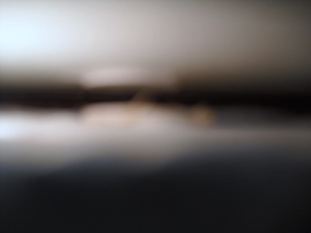

Well, I figured out the picture thing, but it looks like you have figured everything out without them; MAN YOUR GOOD!! I decided to go ahead and post them anyway just in case they are useful.
This is the alignment of the sensor on the back door. I know the picture isn't great, but maybe it will help.
Window Sensor

Well, the pictures were good for catching me being careless. I wasn't careful about thinking out my resistor color coding: the colors, as you see, are red-black-red-gold. As many years as I've known color-coding, that's embarrassing.
Two of those resistors in your C/P pictures make me nervous. The metal wires at each end of the resistor ("leads") are part of the zone loop. Two of them look like they're ready to touch, or are touching, in the pix. Make sure they're separated far enough that they can't do that (touch). It's possible that may be causing a problem on two zones. (we should be so lucky)
Those solderless connectors are not crimp-types after all, but are good connectors. Probably not a problem.
Interesting: Your window sensor model # ends with "WG" = Wide Gap. you should have extra margin for alignment & spacing.
