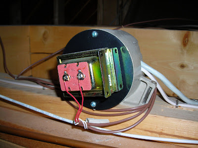

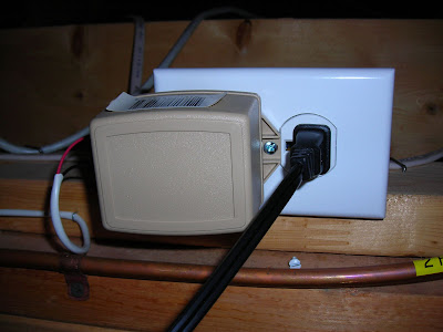

MrRon and ChosunOne, are either of these 2 things it? I've been looking all over the house and the only unusual things I've found are up in the attic.
I'm thinking the second one might possibly be it. I have to unscrew it from the outlet so didn't want to try that until I asked you first. (That's a floor lamp I've got plugged into the outlet next to it--otherwise I wouldn't be able to see much.)
IF that's the AC, is there a problem with having to unplug it in the attic, run downstairs, climb up a ladder to detach the battery in the control panel and then vice versa? Too much time in between operations or would it work?
Needless to say, the outlet in the bathroom didn't do the trick.

The second picture is your alarm transformer. The first picture is your doorbell transformer.

Bingo!! #2, the beige one on the bottom is it. The other other one looks like a doorbell transformer. Unusual to put them in the attic but houses are built all different ways.
You can unplug the battery first, before you start, and just leave it unplugged until you're finished. The keypad may complain after a few minute, but chances are you'll be finished by then.
Edit: When you are finished, I personally prefer to secure transformers with cable ties or even velcro cable ties. They hold it just as securely as the screw and can be slipped off and on without a hassle.

Oddly enough, in this region, prewires done to ADT specs frequently put the transformer in the attic, especially ones above a garage, not sure why, but I see it a lot.
I guess it does have the advantage of not tying up a living space outlet, but I still hate having to climb into an attic void in the FL heat...
If you can't get from the transformer to a keypad in under 50 seconds, you may have to resign yourself to doing it at the panel terminals, or else enlist a helper to unplug and plug.

Typically, the power supply will be plugged into a nearby outlet. Less commonly, they are often plugged into outlets located just inside an attic access, or someplace like the utility room.
If the rough in forgot to drop a wire for power, you can run a new wire to a nearby outlet location (without seeing the physical layout it is impossible to be more than generic).
You could leave the system powered down til the next ice age and the programming will stay put.
