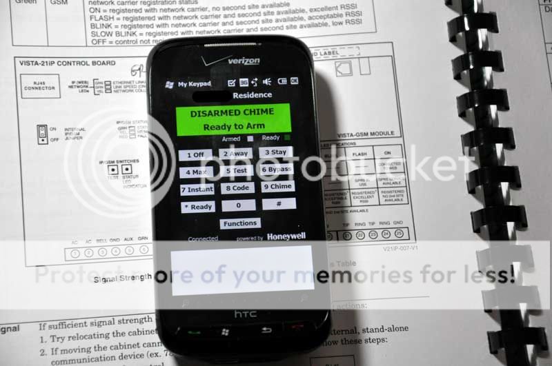

Just adding a note that I now have the keypad on my cell phone and a full report menu on my notebook. Everything is working!
This is definitely NOT for the weak of heart or mind! I had to upgrade my PDA phone from Windows Mobile 6.1 to 6.5 and Verizon discouraged it, but HTC showed me the way.
I have yet to deal with Event / Subject Assignment though it will come to me at some point. I think that I need to program Report Codes into the 6160 first and then use TC to put the name tags on it. Apparently it's for tamper traps for your household goods.
For now, I'll relax a bit. Beer 4U2
