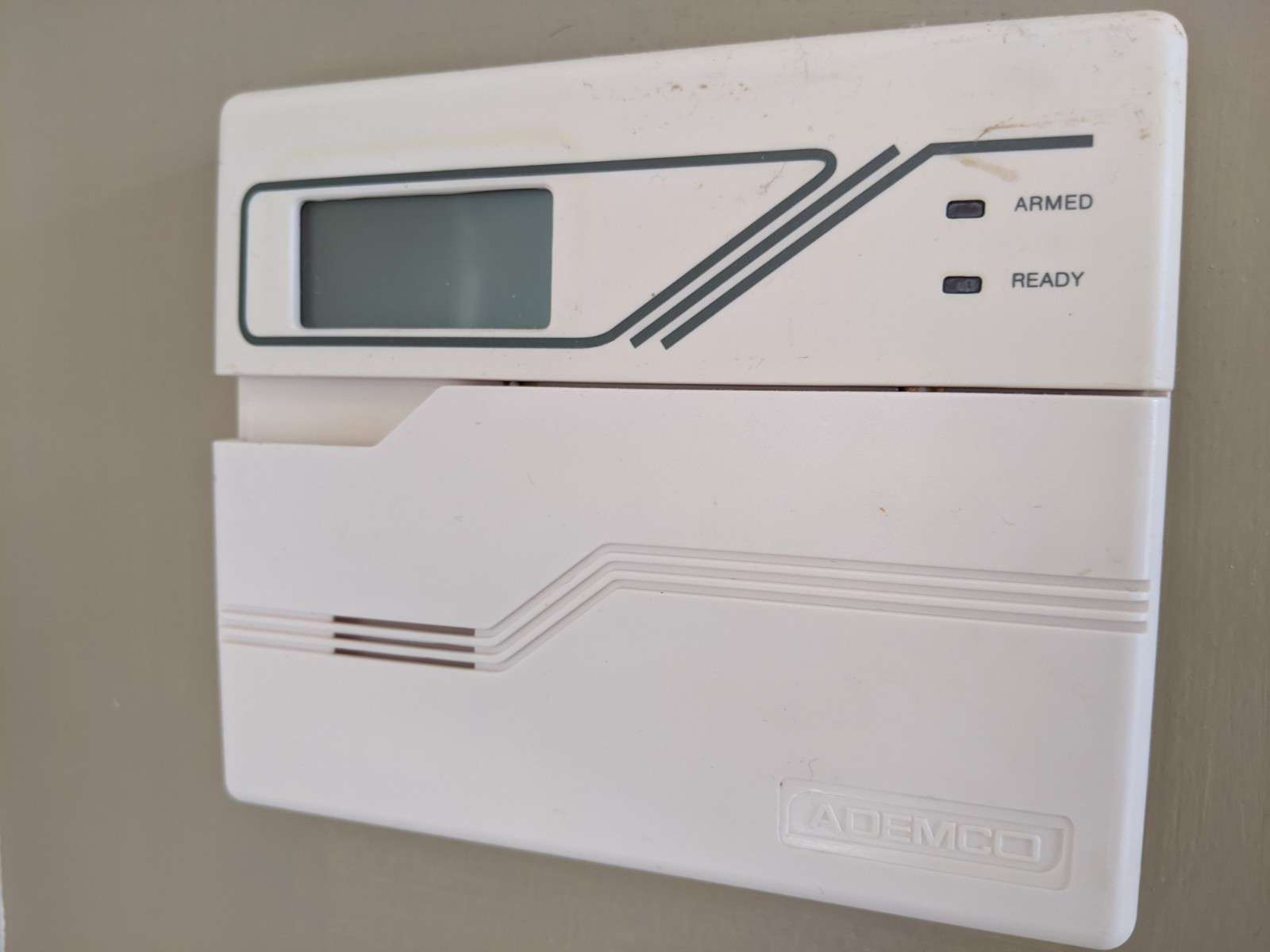

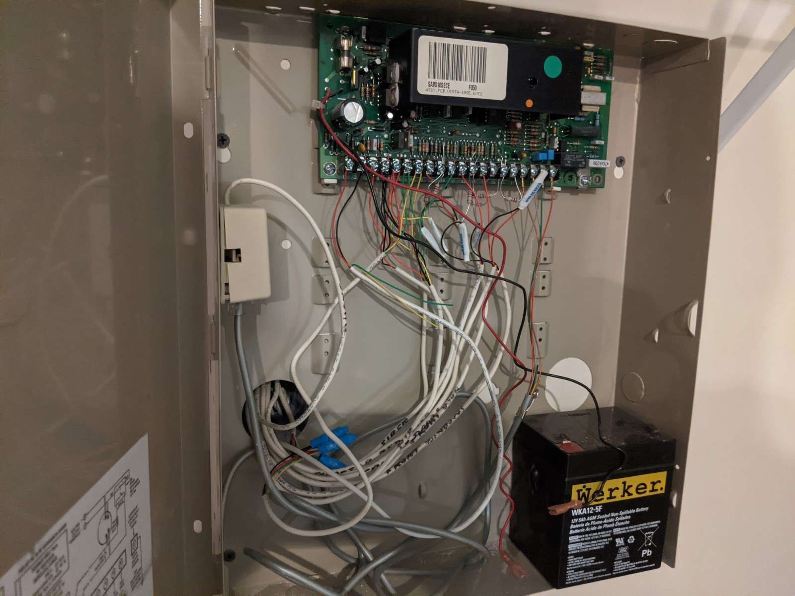

Hello,
I am currently renovating a condo that I recently purchased and I'm in the process of changing out the telecom wall plates (with proper structured wiring), replacing the old thermostat with a smart thermostat, and have a question about an old security system that was installed when the condo was built around 2003.

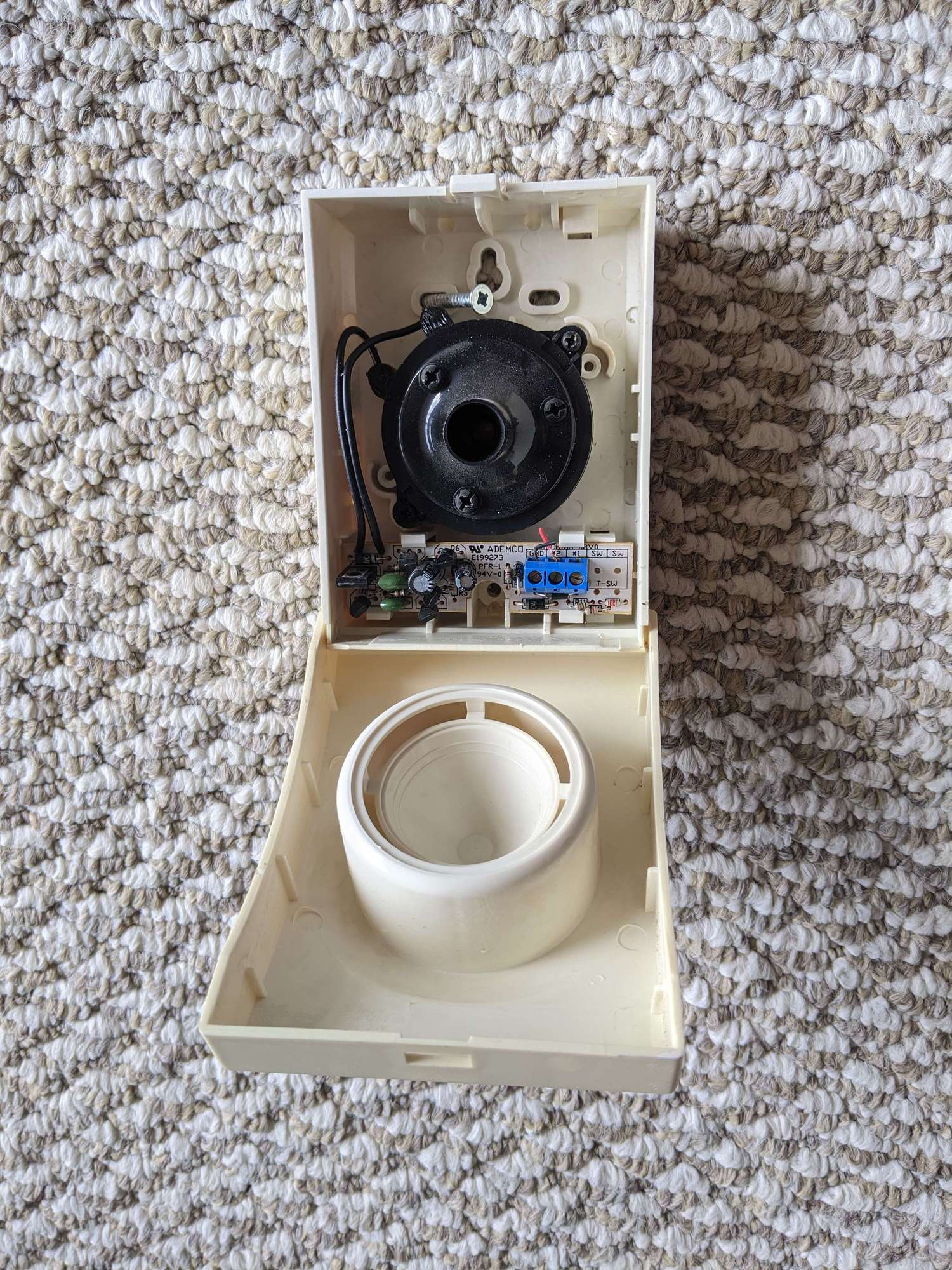

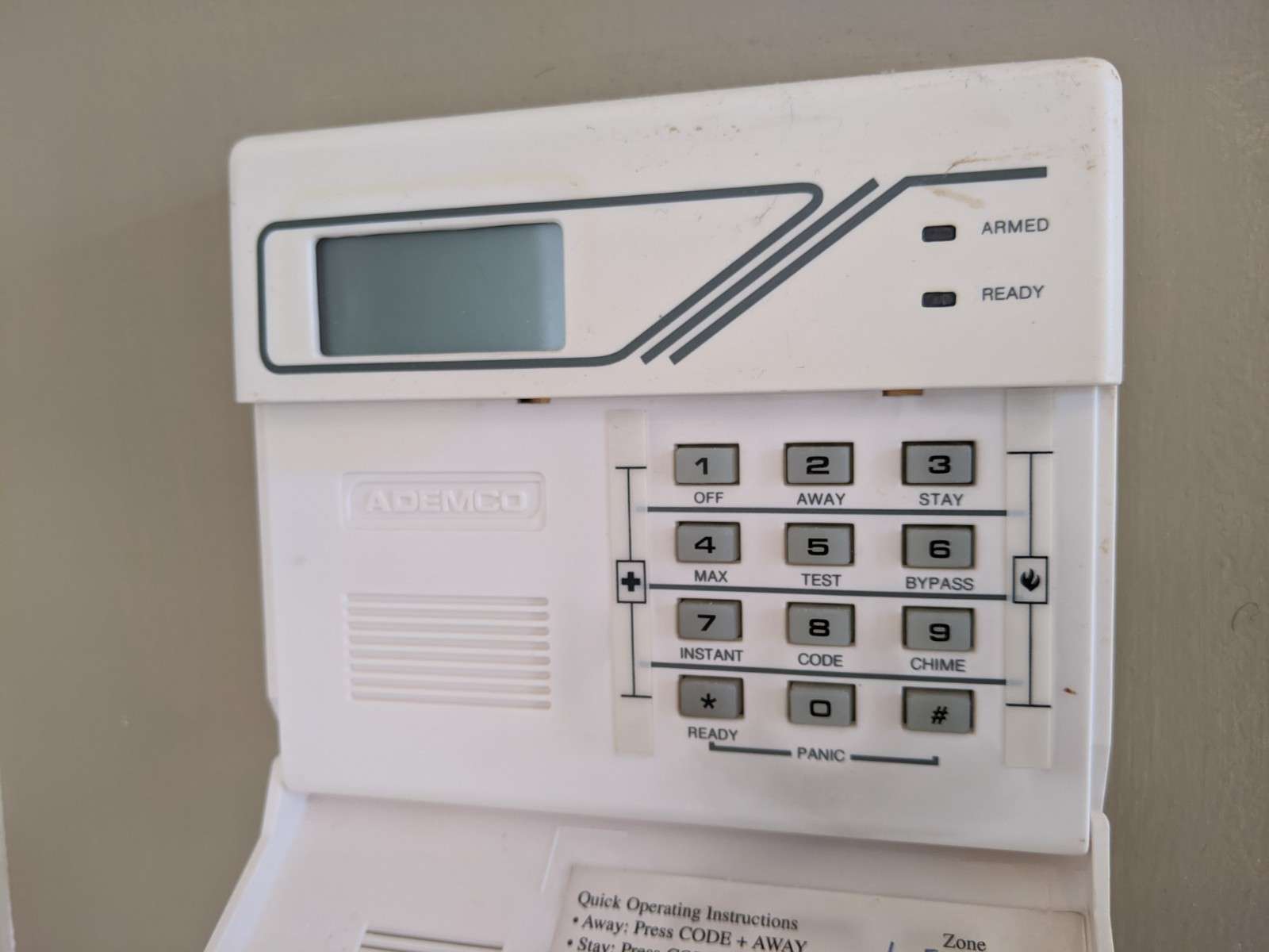

I 'do not' plan on using the security system, but while I have the interior painted of my home, I want to replace the old 'yellowish' components (keypad, motion detector, and siren) after they finish patching holes and painting. If you look at the attached photos of the existing alarm panel and system components, are there any recommended components (keypad, motion detector, and siren) that will work with my system? I want to make these available to the next renter, or possible owner. All of these components have a hard wired connection back to the panel.

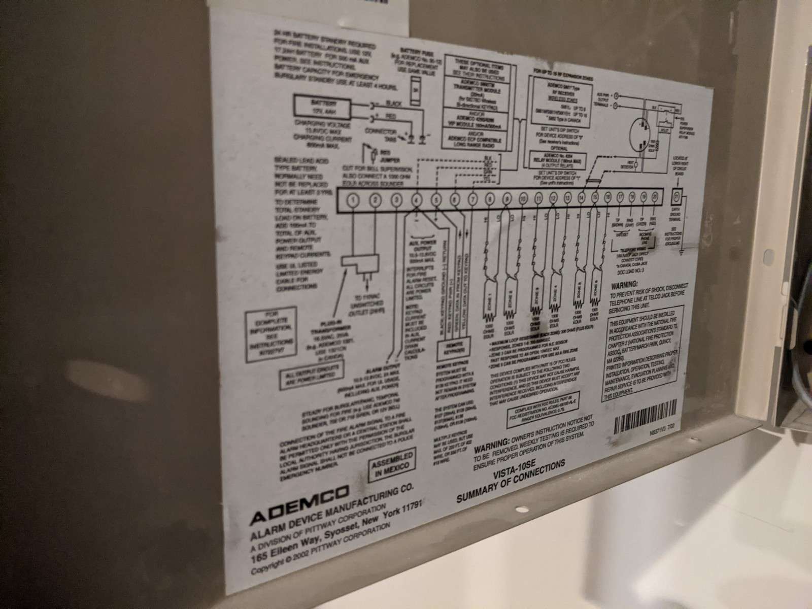

What you have is an old (but still quite servicable) Vista10SE panel. This provides six hardwired zones (sensors), and another 16 wireless zones (sensors) including keyfobs for arming and disarming.
The keypad looks like a 6128, and can be replaced with a 6150 (fixed words) or 6160 (full text display).
The siren is pretty standard and you can get new ones (e.g. on eBay) for about $5; search for "Wave2 siren".
I didn't see the motion detector, but it's almost certainly something that can be replaced as well. It looks like all your zones (sensors) are wired, so most any device that provides "normally closed" outputs will work to replace what you have.

Thanks so much... let me investigate and get back to you. I didn't include the sensor as it just seemed like a 'standard' one if that makes sense?

1) There might be a slight problem with replacing the keypad(s) (which don't actually look that yellowed, but what the hey) with newer models:
Hard to be sure from your pics, but that keypad looks like it's flush-mounted. Meaning, the hole cut in the drywall to mount it is almost as big as the keypad itself. You _might_ be able to replace it with a 6150, but I don't know if the screw holes in the mounting plate will have enough drywall to secure it, and I can't remember the last time I had to replace a flush-mounted 6128 KP. A 6060 probably has a large enough mounting plate not to have a problem.
2) BEFORE you go replacing parts or changing anything in a system, you need to be sure it works properly in the first place. You don't want to have issues with new parts and not know if it's the new part, or something in the old system. If you don't already have a User Manual and an Installer manual, you should download one from Online.
It isn't unusual to move into a house and find issues with an existing alarm system. You said this system was installed in 2003, but how long have _you_ had it without using it? If that's the original battery in the Control Panel cabinet, OR if it's been unplugged for years, it's probably dead or close to it, and will need to be replaced before testing. A dead or very weak battery will give unpredictable results during testing. Or it may test fine and have erratic behavior (like false alarms) later.
Those batteries are available at any Batteries Plus or equivalent store.
3) To be clear about the number of zones available: Your Vista-10SE supports 16 wireless zones in addition to the 6 on-board zones, but those wireless zones (or keyfobs) have to be added via a 5881M RF Receiver + wireless sensor/transmitters.
Looking at your pics, it looks like you have 2 peripherals connected to your data lines, Terminals 4, 6, & 7 of your V-10SE Panel. If you have 2 Keypads, then you probably don't have a 5881 Receiver, only the 4 hardwired zone that seem to be connected to the Panel.
4) You mentioned a "sensor" which is vague--there are more than a few different sensor models, both recessed and surface-mounted. All of them have their own advantages and a few have quirks. If you have plunger or roller type sensors, I'd recommend replacing them with something better--those are prone to chronic failure. Pics would help.
5) If you decide to upgrade to a new panel, be aware that professional-grade alarm panels are not as user-friendly to upgrade as newer Smart Phones. You'll have to program it from scratch, which is considerably more complicated than setting your newest Smartphone up. Professional-grade alarm panels are made to be installed by pro's with experience and some of the programming isn't intuitive. Lots of DIYers do it, but just be prepared to work through a learning curve. There's no memory card to take out of the old panel and import to the new. And you will need at least one 6160 Alphanumeric Keypad along with patience and persistence.
