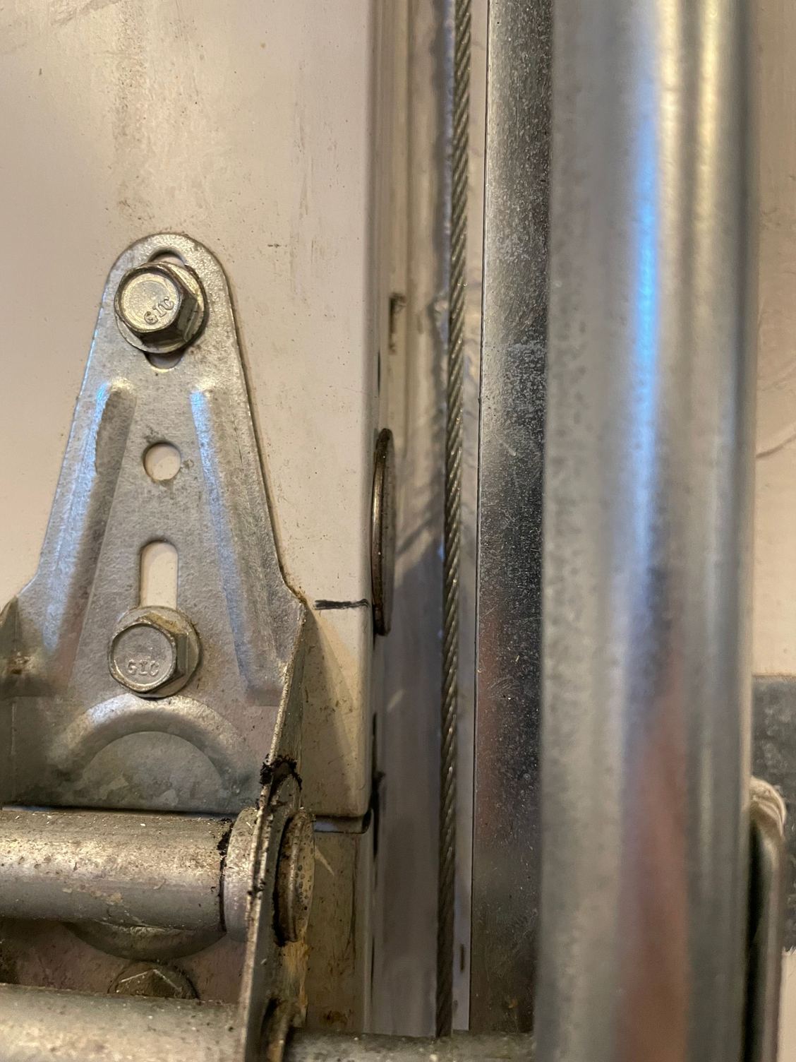

Upon another closer inspection, I think I found the culprit.
A magnetic coin is attached to the side of the door. (photo below)
On the recently repaired side, the coin doesn't exactly face the sensor. It's sitting a couple of inched higher than the sensor.
Are these triggers generic, or do I have to match them to the sensor?

Any magnet of similar strength will work. Given that the magnet is located near a joint, it may be easier to move the switch to line up with the magnet, than vice versa.

That's not really a coin. It's a drilled in magnet. The switch is probably drilled in too.
Not the easiest of devices to work with there. They both install in a 3/4" hole.

The switch is definitely drilled in. I see its wiring buried in the wall.
Can't tell about the trigger, but it's so well attached to the side that I couldn't dislodge it. Maybe it's drilled in too.
Regardless, can I use any magnetic coin with a 3M tape on one side instead? It will take another visit from a repairman with added costs to drill in a magnet.

It would work. There are plenty of flat magnet discs available, BUT, a garage door is a high vibration location. If you can get one with a center screw hole so you can shoot a self tapping screw in to keep it in place, in addition to adhesive, you will get less potential for future aggravation.
I suspect that when your door was repaired, the replacement panel was a slightly different height than the original.

You can access the magnet to put a screw thru in it when the door is up or just around the top bend.
Magnets have different poles and directional properties.
The magnet that is in the door focuses its strength towards the end allowing for a large gap between it and the switch. The round type magnets are different. I'd recommend trying it with a thin self stick pad first to make sure you have the necessary clearance with the door up and it's strong enough to activate the switch.
