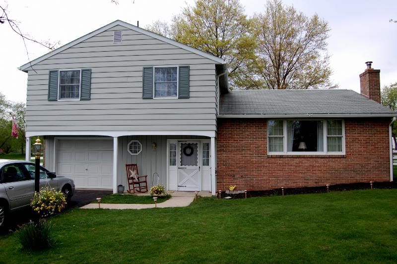

Below are some photos of the house before and after. Keep in mind the house was a nasty green which could be hard to see in the before photos especially on the side shot as the sun washed the photo out a bit.
Before:
Front of house
Left side of the house
After paint, went with a grey on the siding with pewter green for the shutters. Our brick's have a tinge of green in them so we wanted to try to match off of them.
Front of house.
Side of house
Corner
I rolled the entire house from the ground without scaffold or a ladder. I used a 24' extension pole and man I tell you what, my arms are beat. I also used a mini 6" roller so I was able to get under the edge of the siding pretty good without touch up.
Comments? I saved $3100 doing it myself as a local painting company wanted $3,300 to do the job. Paint and supplies cost me $200 from Sherwin Williams. Best $200 I have ever spent and saved a ton......The wife is happy and we all know that is all that matters.
All the neighbors stopped by today and said how much better it looks. I was pleased. To the victor goes the spoils!
