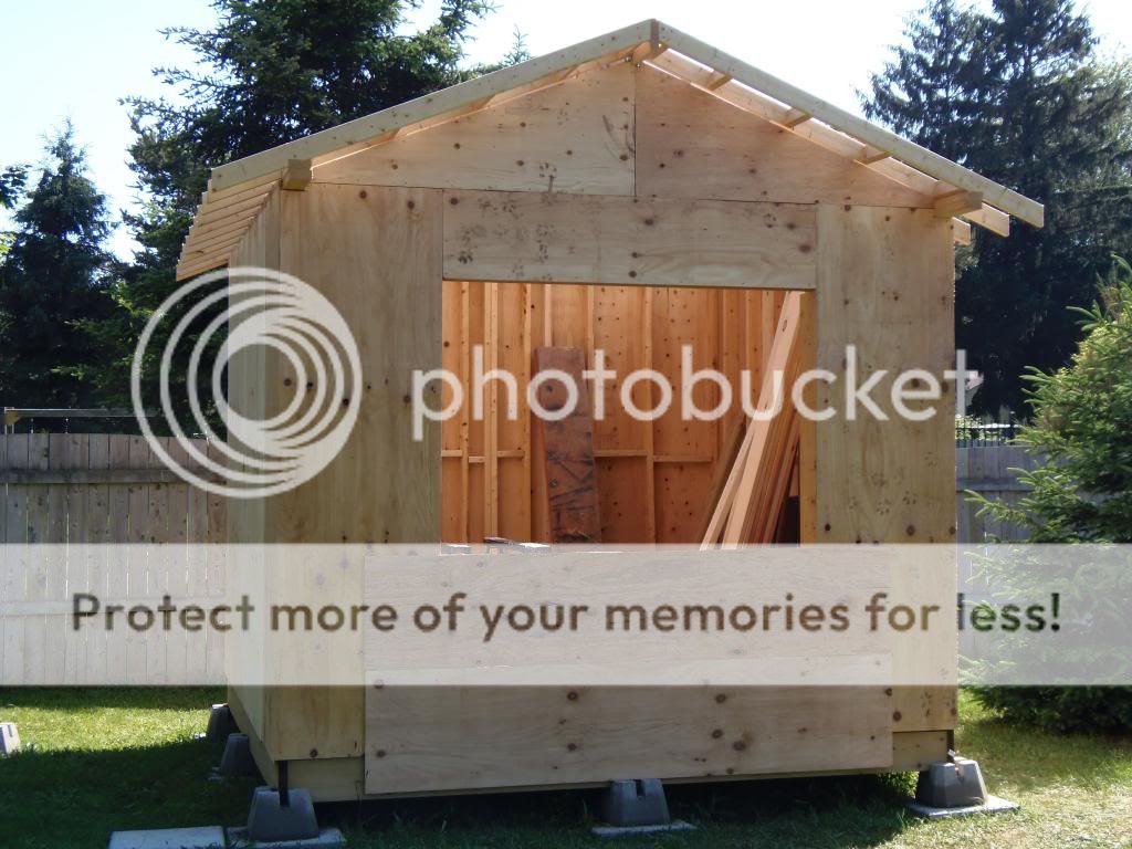

Well, got the walls sheeted with 1/2" plywood yesterday except for the gable triangles. I am pretty happy with the way this thing is going. However, yesterday I noticed that the walls were no longer perfectly plumb, which was kind of depressing. They weren't off by a mile or anything, but they were off a bit. At this point, I didn't think there was much I could do. There's no way I am taking that roof down again. Noticed it when installing the first sheet of plywood. I know that was square, but the framing was no longer so. Boo.
Also installed some lookouts under the front overhangs. Going to do the back as well when I get to it.
The building feels wayyyyy sturdier with the walls sheeted which is nice. Like Marksr said, it made you worry about whether or not the framing was suspect or not.

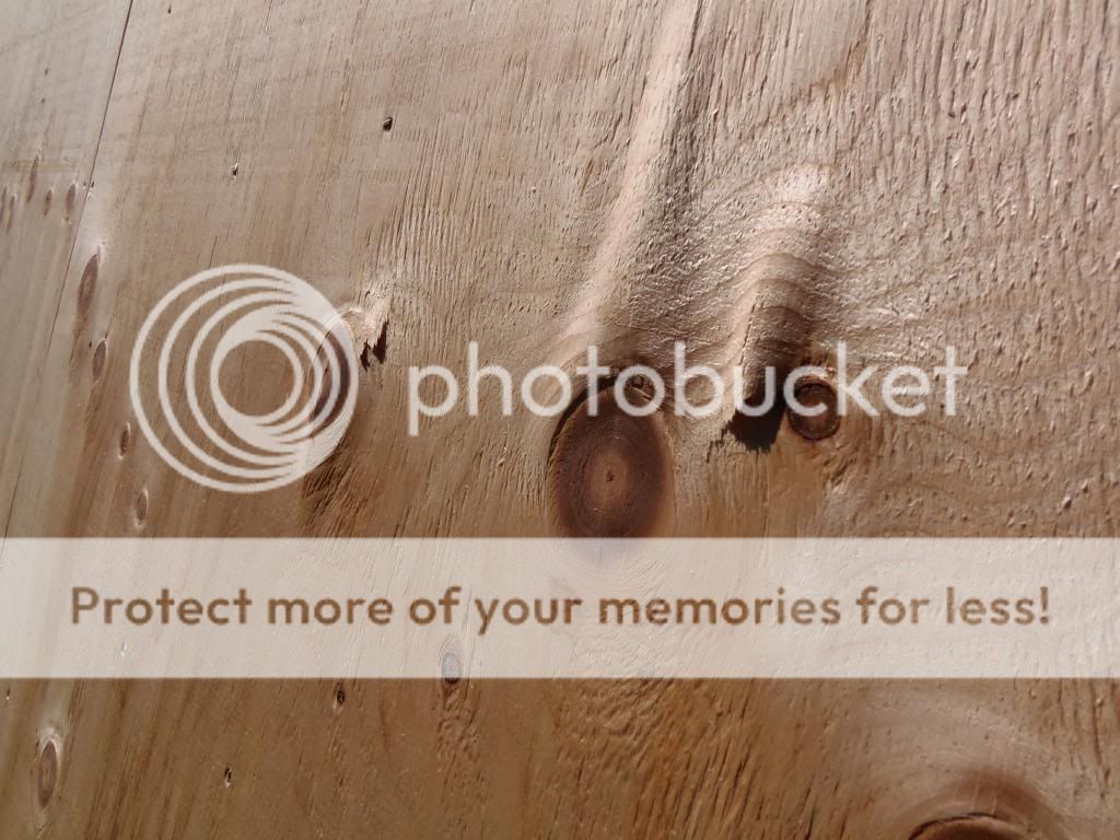

Well, here's a pic of this thing sheeted. I asked my contractor friend if it would be ok to sheet the thing if I wasn't going to get back to this for a short while and it got rained on. He laughed and said "of course", which makes sense as I see buildings being sheeted and left in the rain all the time I guess. Well, an unexpected rain happened and some of the plywood started to delaminate around big knot holes. I'll add a pic of that too.
I assume that even when the plywood dries out completely, these aren't going to go away. Very frustrating. Not super happy about replacing I think it's three sheets of this stuff, but might not have a choice. I better get this thing oil primed as quickly as possible!

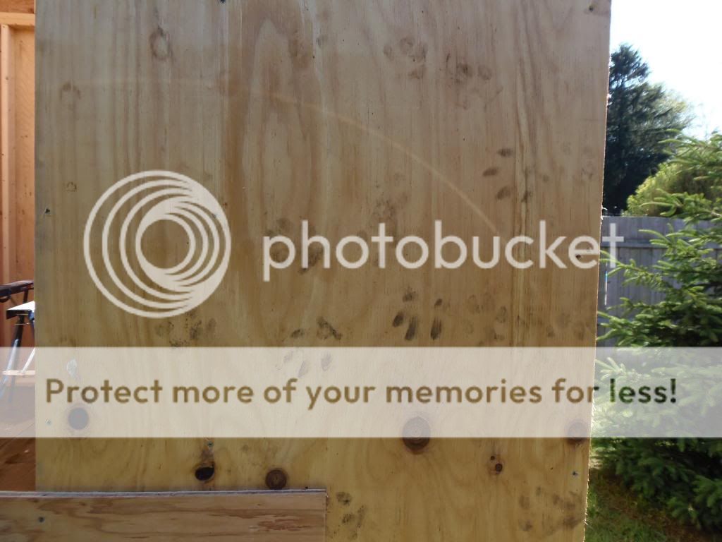

Oh, the plywood on the doorway is to keep the dogs out of there.
As you can see, the dogs left their mark on things as well.

Mmm, I don't think so Mark. I just got back in the house from taking another look. It's been nice and toasty here today (Canadian style, so not really toasty), and they haven't receded one bit.
They actually run vertically for over a foot in a few spots, and they're pretty big. If they were just tiny little guys, I'd agree that filler would be an option, but these are too big for that. I think.
If I run like crazy I can pull the two sheets off and replace then oil prime the sides of the shed that aren't getting hit by sun right now and by the time I'm done with those two, the other sides might be in shade.
