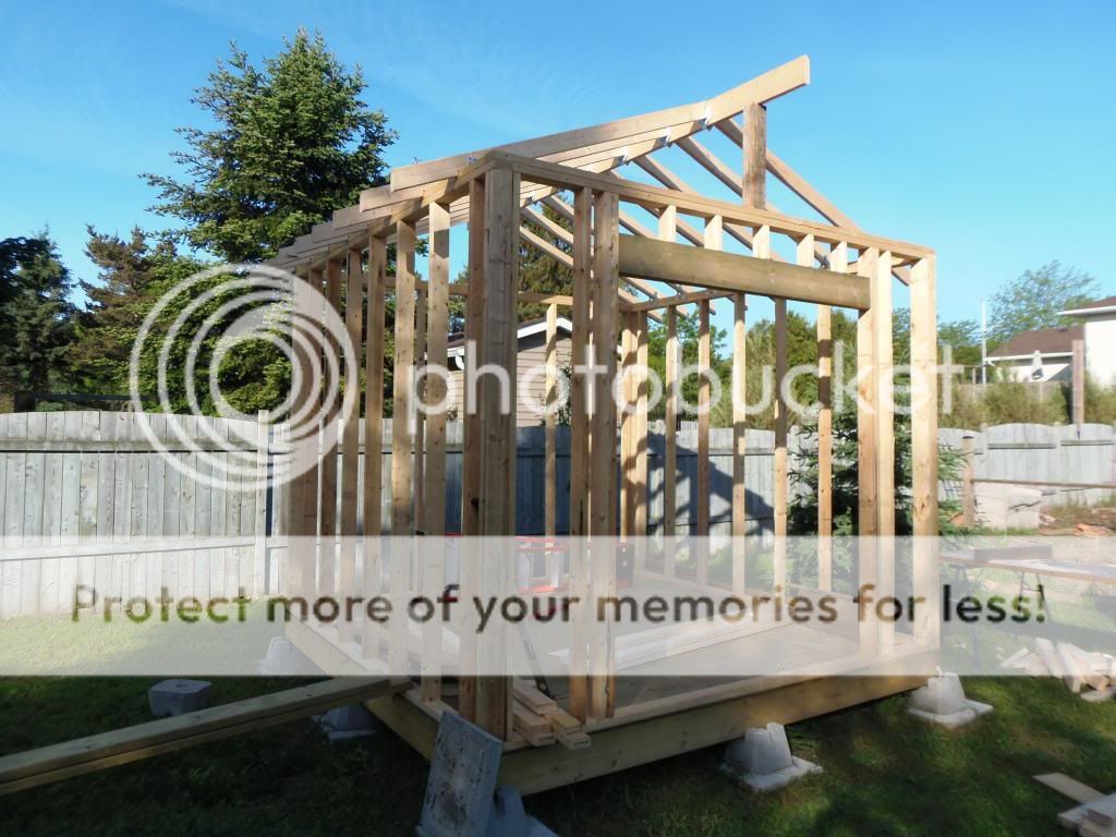

So, in the middle of building my shed for my riding lawn mower, etc., and I'm at the part that freaks me out the most... The roof. In my opinion, one of the most important parts of any structure as it's the lid of the bloody thing.
Framing has been done in standard 2X4 construction. Shed is 10'X10'.
Wondering if anyone has any tips that would be helpful in making the trusses and fastening them to the shed framing. I've seen internet resources that tell you just to screw the trusses to the top plate. Others have suggested using the metal fasteners like the Simpsons ones.
Any thoughts?
Any thoughts?
My thoughts are that trusses are engineered and certified. As such they technically cannot be made outside of a truss factory. I would use rafters and yes, I would use the Simpson plates for fastening the "tails" to the walls.
Or use a ledger on the wall of the garage and joist hangers for the rafters to sit in against the wall, bird mouths at the tail end and hurricane ties to hold them to the top plate, as well as cross nailing.
What is the shape of your roof, standard triangle, gambrel, vaulted? For a 10' x 10' trusses are not necessary unless you are doing something special. I have built a gusseted frame and although not technically a truss it served the purpose of creating a gambrel roof continuous to the 4' wall framing and deck boards (8' x 8'). But it was much more time consuming than just regular framing.
The other approach is to support a substantial ridge beam and nail your rafters to each side with a tie across the top, it almost eliminates the ceiling joists if the ridge is strong enough.
Also, nails and not screws. Good galvanized nails will last much longer than screws and if you use any pressure treated lumber, be sure all fasteners are appropriate for PT.

Hey guys, thanks for the replies. Some carpentry terminology in there that I don't understand, but I'll spend some time today trying to decipher it. Once I get to the painting stage, then I'll feel like a pro....
Hoping to go buy the lumber, and fasteners of whatever type I go with for this today and maybe get to it tomorrow.
It's a shed for sure. Going to house my riding mower, push mower, weed eater, rakes, shovels, etc. Not going to be occupied by any living thing.
It's 10' X 10', raised off the ground by patio stones under deck blocks. I want a simple triangle roof. Hoping to get a 10-12" overhang on the sides and whatever I can on the front and back.
This is my first adventure in building a structure like this. I've built myself two decks around our house. Absolutely nothing fancy as I have a really hard time thinking in three dimensions. Thus, why I paint.
Maybe I'll take a pic of what I've got done so far and hope you guys have a better picture of what's being built. In the end, it's basically going to look like a wee barn of sorts.

Let's see if this link is close to what you are talking about?
Google Image Result for http://www.shedking.net/image-files/ridge-beam.jpg
Wow, that is a long link.
Bud
OK, looks better when posted.
If that is it, then on a 10 x 10 I would still use a substantial ridge beam, plus each end needs very good support as the beam ends will carry the entire roof load.

That's the one Bud. Well, I just got back from the lumber store. One 12' 2X6, 18 8' 2X4 and a bunch of Simpsons strong ties to attach the rafters to the top plates.

If the ridge beam is substantial and fully supported on each end, then the walls will not push out. Collar ties about half way up will add some support, and increase the head room.
If that 12' 2x6 is your ridge beam, that is not what I would call substantial. And on each end, if there is a window or door under that header there needs to be a good header.

Hmm, I thought the 2X6 was going to be enough considering that some of the online plans I was looking at didn't even suggest one at all.
There's going to be one door. A big one on the one end to get the riding mower through. For the header I used 2 2X8's nailed together.
I will take a look at things however, and see if there's something I can do to add more support under the ends however. Thanks for the advice Bud.
As an aside, a civil engineer friend of mine last night mentioned that he thought it would be prudent to install the plywood on the exterior walls before doing the roof decking to add strength prior to adding the weight of the sheething on the roof. Any thoughts on this?

A 10' 2x6 will bend slightly under your weight or the weight of a bunch of snow and ice. But the real concern is time. I've seen sheds look like our over weight America, bulging at the middle, after just a few years. If a little less ceiling height is ok, then move the collar ties down. Are you using a 6', 7', or 8' ceiling?
Now, don't use this as an excuse to not beef up the ridge beam, but if the results a few years from now are not good, attach a come-along and pull the walls into place and add a few 10' ceiling joists.
I recently completed a 10' x 16' shed. With an 8' ceiling I used 2x6's all the way around, ceiling joists, rafters, and ridge beam. I also added a small door at the top to utilize that space for storage. but I have a 9 on 12 pitch.

I really have to bring the camera out there to take a picture of this thing before I consider it done! It just makes me nervous doing so as you guys are going to find all sorts of crap wrong with it.
Once I plywood the walls, roof the roof and paint all my mistakes will get hidden (just kidding, I'll likely make mistakes in the roofing).

Hey, does that mean I don't have to add any more studs? Somehow, the website I used which lined up and measured everything perfectly (or so I thought) resulted in me having the rafters at 15"OC (I likely did something wrong, but can't figure out where). I planned on doing them at 16" rather than 24" just for the sake of doing so. Can't remember where, but I remember reading that someone's roof showed sagging between rafters after a number of years.
Ok, going to take a pic of this thing now and I'll put it up on here. If you guys laugh, my one remaining feeling is going to get hurt.
#29
No one is going to laugh - if they do, we'll ship them off to the Siberia forum
Most of us only have one or two trades that we are competent in but as diyers we do the best we can in other areas. We've all made our share of mistakes! Even if your shed doesn't come out perfect, as long as it works as intended and the permit office doesn't make you tear it down
mission accomplished! You've gained experience which will help you later on and bragging rites to boot

No one is laughing. Looks pretty good. If I can interject a few pointers. Your header over your door is not supported. You should have had a king stud, then a jack stud for the header to sit on. Remember "vertical". I would have extended my (bottom) top wall plate to match your ridge so you can have something for the false rafter to sit on once it is doubled. I would like to have seen pressure treated bottom plate. None of this will require you to tear it down. Just points to ponder for the next project. The others may find more, but once your siding is up and roof decking is on, you're good.
I see no ridge rafter in the blue jay house at all, so it may have to come down

Yep, thanks for the pointers Chandler. Yep, I totally blew the supporting for the header and plan on addressing that somehow. I'll re-measure the width of my riding mower. I made the door opening 6' wide for two 3' swinging doors. Kind of a barn type thing. Should be able to add a king and jack. I hope.
EDIT: Chandler, I sistered two 2X4 studs together and attached two sistered 2X8 for the header. If I put a stick of 2X4 under the header on each side, is that a jack stud? I think the two full length sistered studs make the king stud? I hope?
Yep, didn't even think of extending the bottom (top) wall plate when that was happening. Not sure if there's anything I can do about that now.
I knew I should have done the PT for the bottom plate. I asked around here and everyone said don't bother. I should have gone with my instinct and just did it. The flooring is PT 5/8" tongue and groove, which the guys at the lumber yard mangled the T&G on. Thanks guys. Got them mashed together as close as I could.
Any thoughts on whether or not I need to block the studs about halfway up? Contractor friend of mine said with 8' walls it wasn't necessary.
Any thoughts on how to beef up the ridge beam at this point?

For no more span than you have, the ridge is fine. Yes, putting two jacks under the header is a good idea. If you do it carefully, cut back on your top plates in a staggered fashion with your cuts on top of adjoining studs and insert longer plate pieces to allow overhang to the front and back. Better to do it now than to not have that rafter support.

Ah, ok. Now I see what you mean. Before you added the picture, I had no clue what you were describing. Great idea. I'll see if this is possible as I overlapped the top top plate to tie into the bottom top plate of the adjoining wall. This was suggested on one of those stupid free plan sites to tie the walls together.
I'll probably have to remove, or unfasten the rafters on the back of the shed to do this as I added them at the end of the day yesterday.
Thanks again.

Crap, looks like this could involve a LOT of dismantling. I will do it if you think it's absolutely necessary though. One site I looked at suggested using short horizontal blocks in between the rafter that's flush with the outside wall and the 'false rafter' to support it. Not sure if that would add much/if any vertical support, but not sure if it's necessary. I hope that makes sense.
I'll work away at other stuff until you respond.
#36
You can install lookouts all along the run of the false rafter. It just isn't as solid on the lower side without the good support. If you want to do this, go up to your top plate. Cut through the top board at the third stud in. Then come back to the second stud in and cut through both top plates. Your cuts should be in the middle of the stud. Loosen the rafter tails from the plates, cut through your overlap on the end where it ties into the cross piece and remove the plate. Install a new bottom plate the length you want, then the top plate, which will be longer. Reset your rafter tails.

Well, that was a challenge. Putting that thing together solidly was good, dismantling was not. I'm glad I did it and I think it was necessary in the end.
When you take things apart though, they come out of square. That's not fun to ammend. However, one foot was added to each end of the upper plates at the end of the day on all the corners.
Thanks again Chandler. I'll likely hit this thing again for more progress next weekend if not earlier if I get a rain day. Speaking of which, if I plan on plywooding this how long can that sit if it rains without being finished with paint? Personally, I wouldn't like it to sit with water anywhere near it at all, but if it has to endure water how much can it take?
