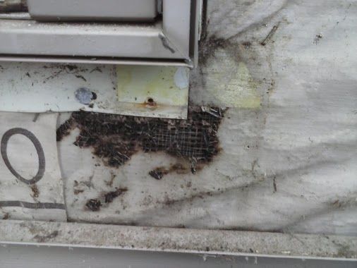

Ok, so I thought I would add some pictures that confirm my opinion of woven housewraps. At work today I removed some siding to install some windows and found the windows were installed on top of a woven housewrap. The house has (had) vinyl siding (which allows water to normally get on top of the housewrap at the bottom corners of the windows). So you can see what a few years of this will do to a woven housewrap.
And across the top of the window, what looks like mosquito netting is really what's left of the crummy woven housewrap.

XSleeper - I read your links to the studies and tests however, there's nothing like a real-world example like this to really illustrate the point. Your picture has definitely told a thousand words.
