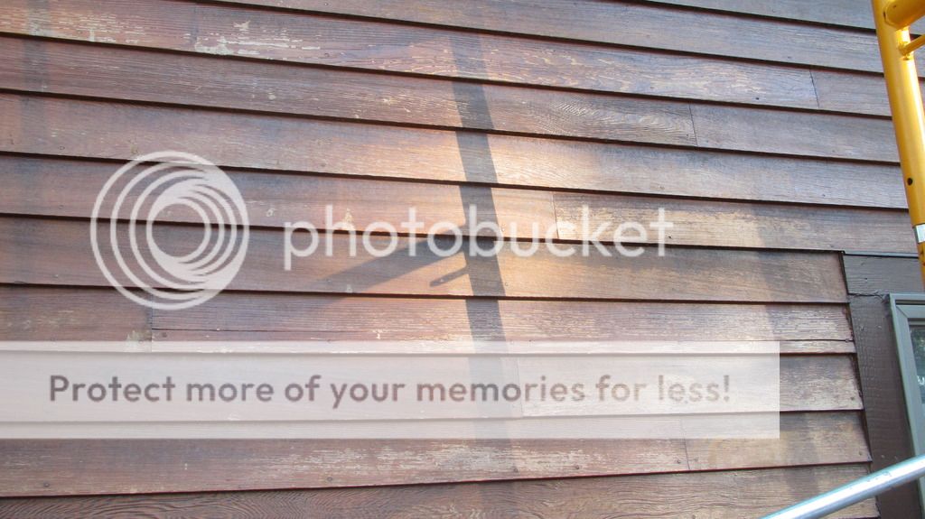

Old 04-11-15, 09:50 AM
Join Date: Mar 2009
Posts: 485
Here's some pics after I washed the back and the deck...
Old 04-11-15, 09:54 AM
Join Date: Mar 2005
Location: USA - N.E.Tn
Posts: 46,257
Received 139 Votes on 124 Posts
The siding would be iffy using a semi-transparent stain, the deck would need a solid stain.
