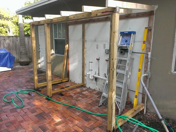

Over the weekend I put up a lean-to wood shed in the backyard.
About 10' wide, 4' deep, and 6' tall.
I have done all the framing with #2 PT lumber, except the roof rafters I used regular 2X4.
Then for the walls and doors I made them out of 3/4" plywood.
My intention was to use pressure treated plywood.
It didn't happen. I was at the big box store and rolled the cart up, and bought 8 sheets of what I thought was pressure treated plywood (it looked like it was pressure treated with a darker tint).
After I put everything up, I was going through my receipts and noticed it says "23/32 RTD SHEATHING PLYWOOD".
Sheathing? That's for underlayment right? I think using it for the shed's roof deck is OK since it would be covered. But the walls and doors...oh boy.
Here is the link to the plywood I bought:
23/32 in. x 4 ft. x 8 ft. RTD Sheathing Syp-166103 - The Home Depot
I think I used the wrong kind right? Any advise? Do I need to waterproof it somehow, or paint something on it?
Location is Miami, Florida, hot, humid, rains everyday in the summer.

How close is it to the ground?

If you plan to put siding and trim on over it, it won't be a big deal. If you weren't, then yeah you will have to prime and paint it. The bottom edges won't fare well being that close to the ground.

"How close is it to the ground?"
If you look at the first picture where I showed there is a piece of 4X4 at the bottom which is about two inches off the ground at the nearest point. The plywood are attached to be flushed to the bottom of that 4X4. The three front posts are PT 4X4 set about 3' into the ground, coated with roofing tar at the feet with concrete around them.
So the plywood will not touch the ground but will be subjected to rain.

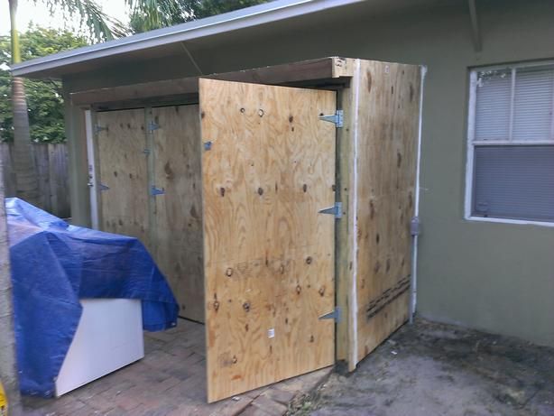

Regardless, as X has already pointed out, this is going to be problematic and you should prime and paint all six sides of the wood.

Any form of plywood should not be within 6" of any grade or it's going to rot.
Pressure treated plywood would have been my last choice for siding.
If you wanted plywood the right way would have been to first install 1 X 6 vinyl lumber at the bottom, Z molding, then something like Smart Board or T-111.

I wouldn't bother with TWS but priming with an exterior oil base primer with latex house paint for the top coat should do ok. The biggest trick will be getting the bottom edge of the plywood primed/painted.

Primer and paint will do a better job of protecting the plys from moisture. A solid stain might look ok but paint would be better. Also if there are any ink stamps on the plywood the oil primer will seal them.

If that door is a just a piece of plywood it will probably warp. Best to have it attached to a 2x4 frame.

Good catch Ray, it needs a framework of 1xs at a minimum. I'd be shocked if it doesn't warp without a framework to stiffen it up.

There is a frame of 1x6 around the doors on the inside.
I originally wanted to use T1-11, but when I picked one up it was already warped and looks very thin. So I opted for 3/4" plywood.

Glad you have stiffeners on the inside of the door. It might also be a good idea to place one diagonally.
