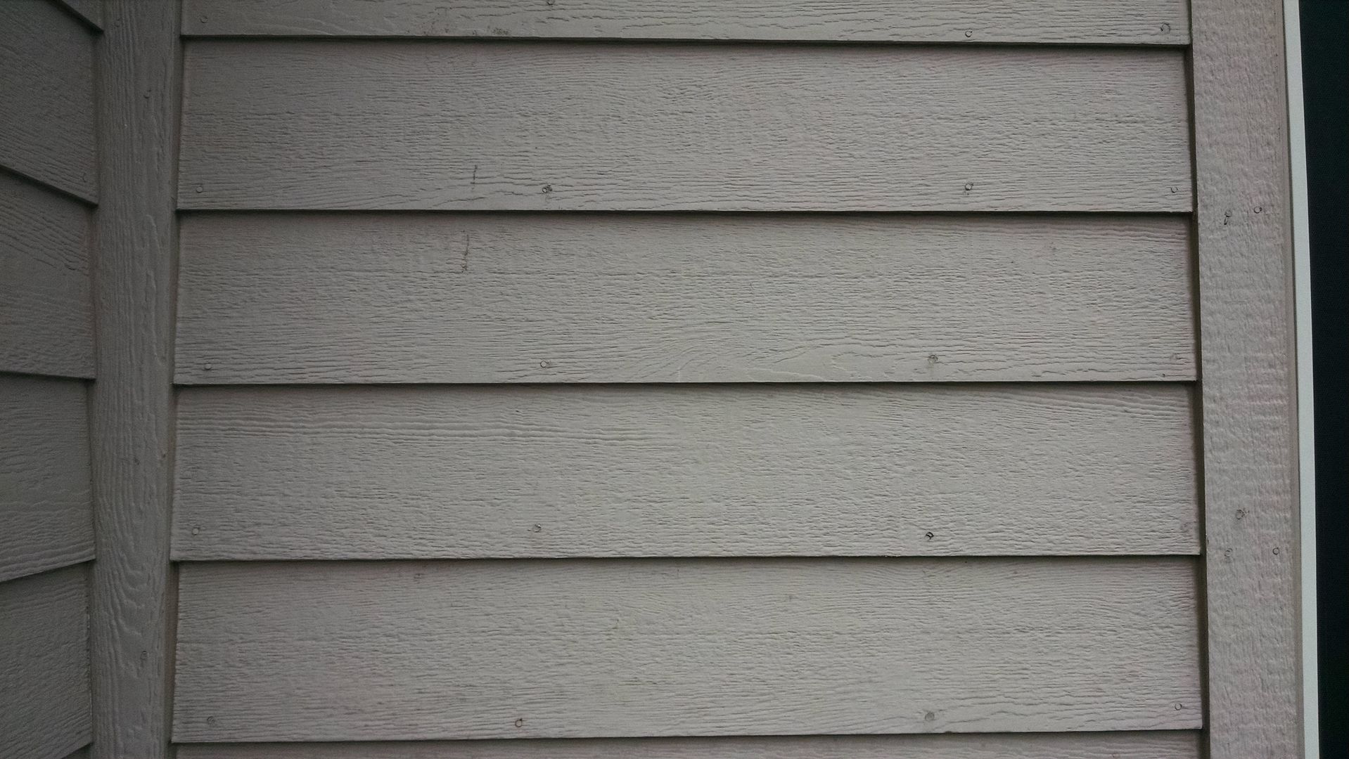

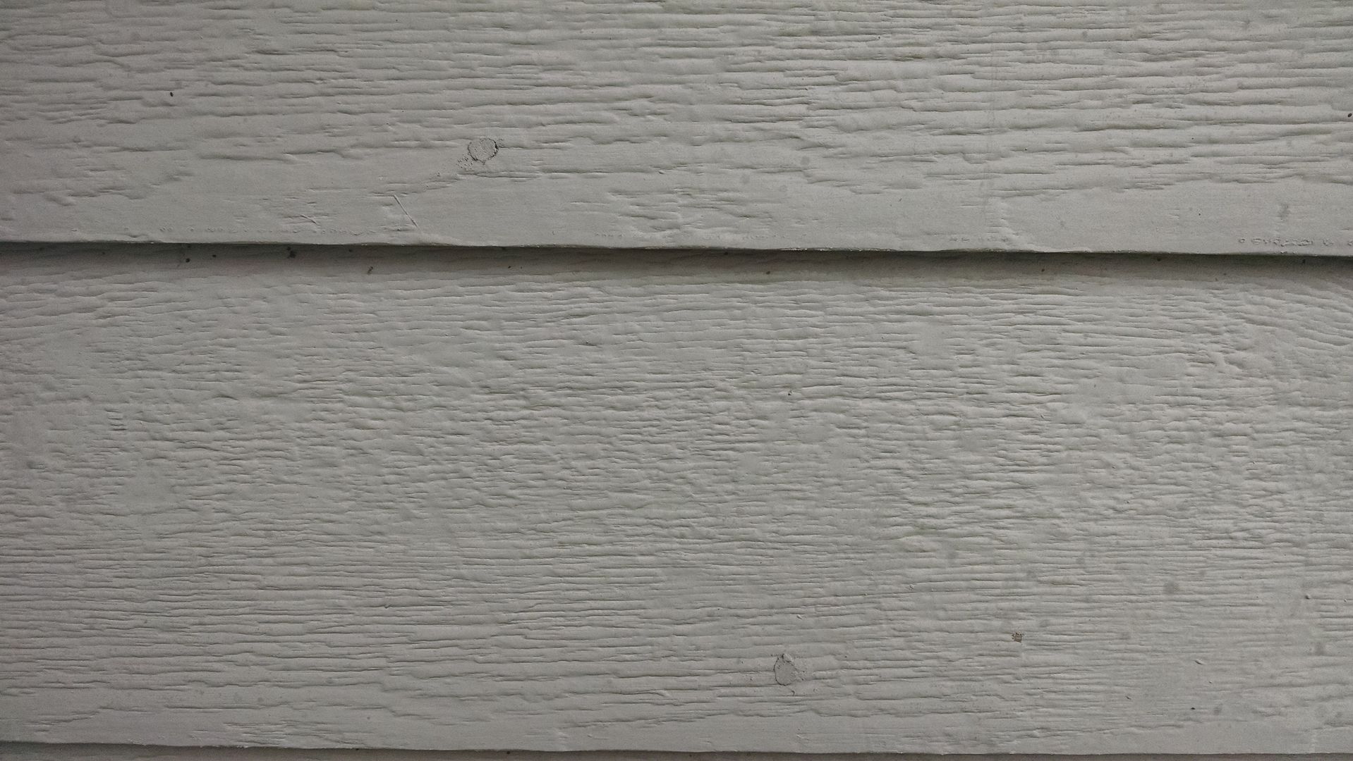

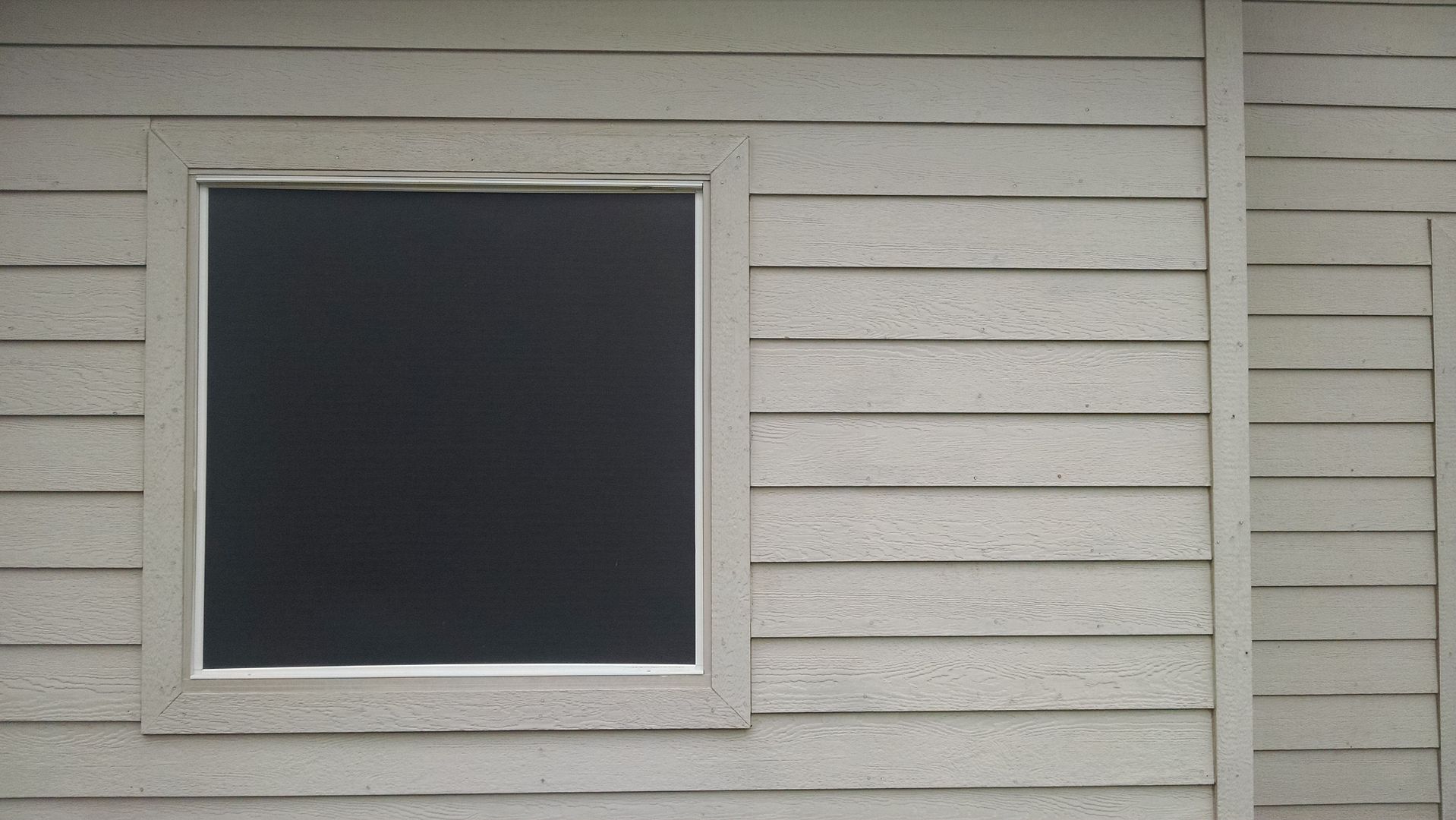

alright. Here are some actual pic of what I am trying to paint to make it last and look nice. I think it is Fiber Cement. the picture I got above yesturday was from home depot page for Fiber Cement (James Hardie HardiePlank HZ10 5/16 in. x 8.25 in. x 144 in. Fiber Cement Select Cedarmill Lap Siding-215518 - The Home Depot). I am not entirely sure. hopefully you guys can tell from the pictures below what I have.
Now as you can see some nails are showing while others are kind of showing. I am not sure what type of nails they used, but if it is Fiber Cement, can you tell? I am not sure if the builders used cocking on nails or just painted after applying the nails. None of the nails are so far out for me to easy pull them out. The paint might be chulk. I can out my hand on an area and paint will come off on my hand like a chulk. not sure.
What do you guys suggest. power wash, use cocking around windows if needed, prime areas that need and paint? no need to mess with the nails, put wood filer or cocking on it? What about the rusty nail or nails that have not rusted yet, but are almost showing with paint still on them, should I use something on them? Few people suggested some products. Can you tell me what type of primer and If I need to prime the whole home again or just certain areas and what to do on nails. I want this job to last along time and look professional. nail set and using oil base seal on nails idea I got by looking stuff online. Paint wise I am gonna go with a similar color using paint sprayer I just got to give me a smooth look. Also how many coats you guys suggest. Texas heat can be hard on outdoor paint.

I'm a painter, not a carpenter but I generally will add caulking to fill the holes left by the nails that were driven in too far. Just caulking the hole and not leaving any excess caulk around the nail hole. Glazing can also be used and is a little quicker/neater but I feel that caulking does a better lasting job.
The properly set nails just get painted over. Generally the siding doesn't need to be primed prior to a repaint but any rusty nail heads should be primed with an oil base rust inhibitive primer. Is the old paint chalky?

It's usually a good idea to wash the exterior before you repaint. I usually use a bleach/water solution for cleaning as it is both cheap and effective. I'll add TSP to the mix if there is a lot of chalk. It sounds like the chalking is minimal on your house. Chalk is the oxidized paint that will rub off of the siding onto your hand. It's often white or at least lighter in color than the actual paint on the house.

Even if you can, I wouldn't try to set those nails below the surface. You're liable to split or crack the siding. Just hammer the protruding heads flush. As far as filling with wood putty, I never had much luck with wood filler on exterior surfaces. It's very likely to pop out after a few seasons especially over a steel nail head. What I see in the pics is wood grained siding that has been nailed. It's a uniform pattern, it is what it is, I would live with the look.
