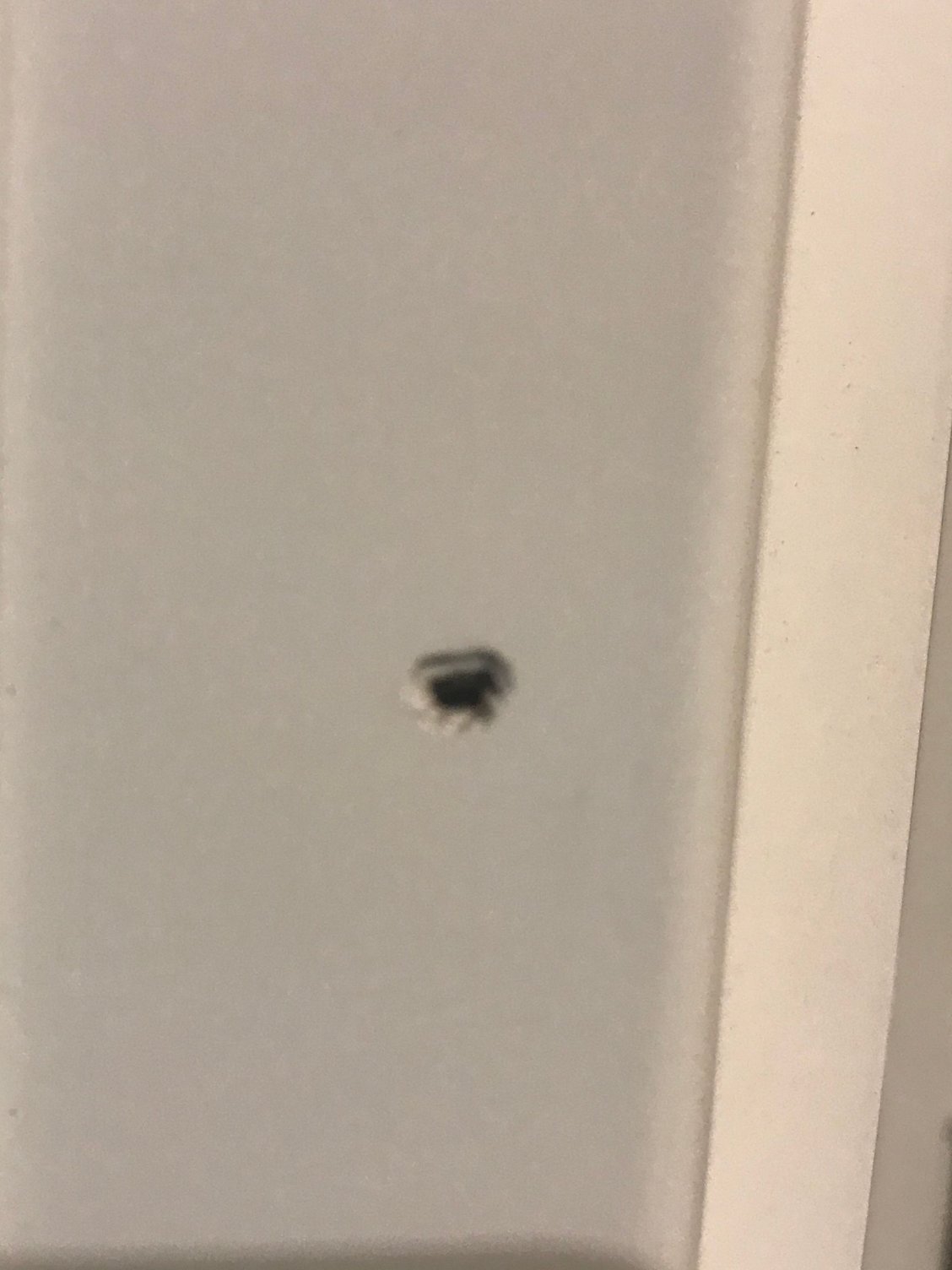

Old 10-21-20, 11:12 PM
C
Join Date: Oct 2020
Posts: 1
Same problem
Slyguysmoke, was curious what you ended up doing and if you were happy with the result. I have the same problem and really donít want to have to paint PVC, when not having to paint it was the reason I bought it instead of wood. Thanks 😊
