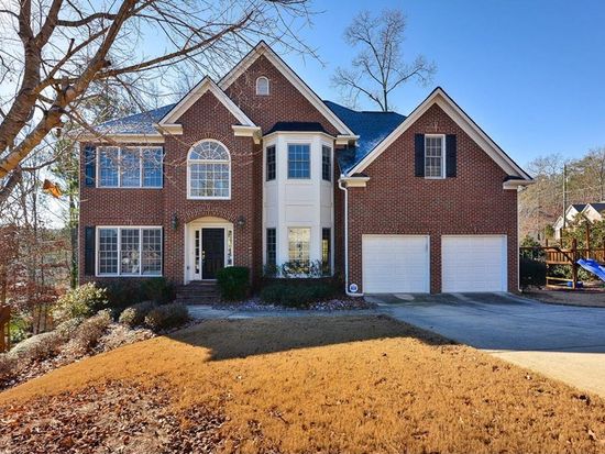

I have a bay window that goes from the first floor all of the way to the roof. The wood framing around the windows is not very even. The previous home owner tried to repair one of the uneven spots but just made it worse. Any ideas how I could improve how it looks? I have attacehd a picture of the worse seam where a repair was attempted but there are a couple of other seams that don't line up.

Old 04-15-19, 06:02 PM
Join Date: Nov 2008
Location: Wisconsin
Posts: 140
Here is a picture of the front of the home. I was trying to come up with something nicer than the wood which, as you see in the other pictures has some problems.
