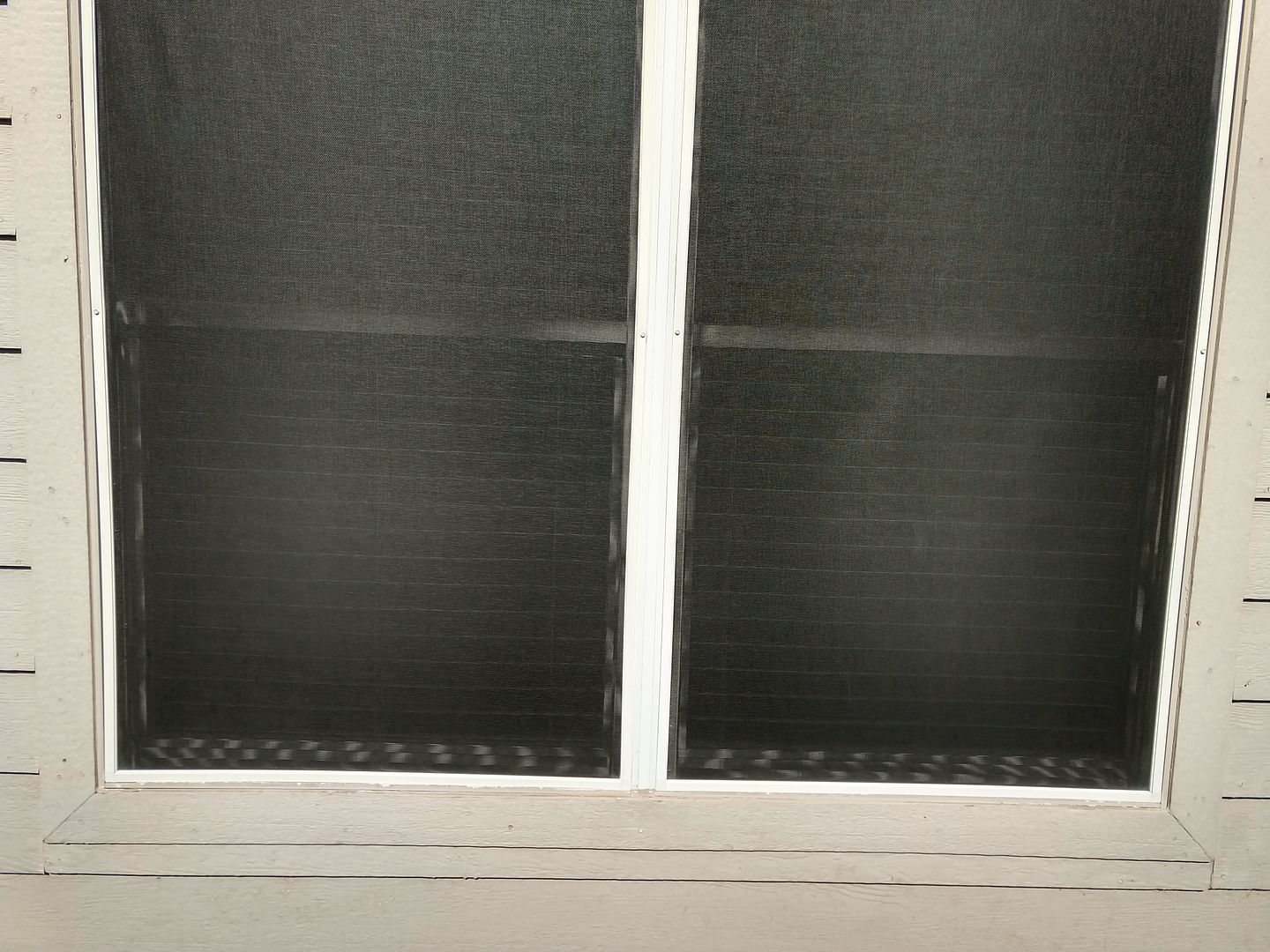

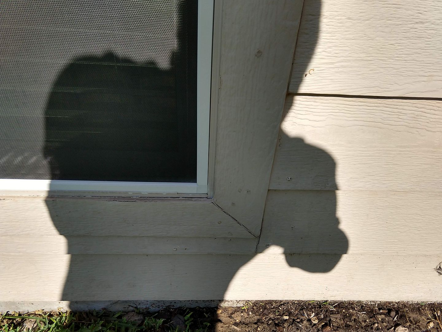

I live in Texas, and this home was build in 2004.
I am about to repaint my home sidings. Already powered wash and used siding cleaner from home depot that I mixed with bleach to spray before power washing. I will do another cleaning treatment before repainting.
Few questions:

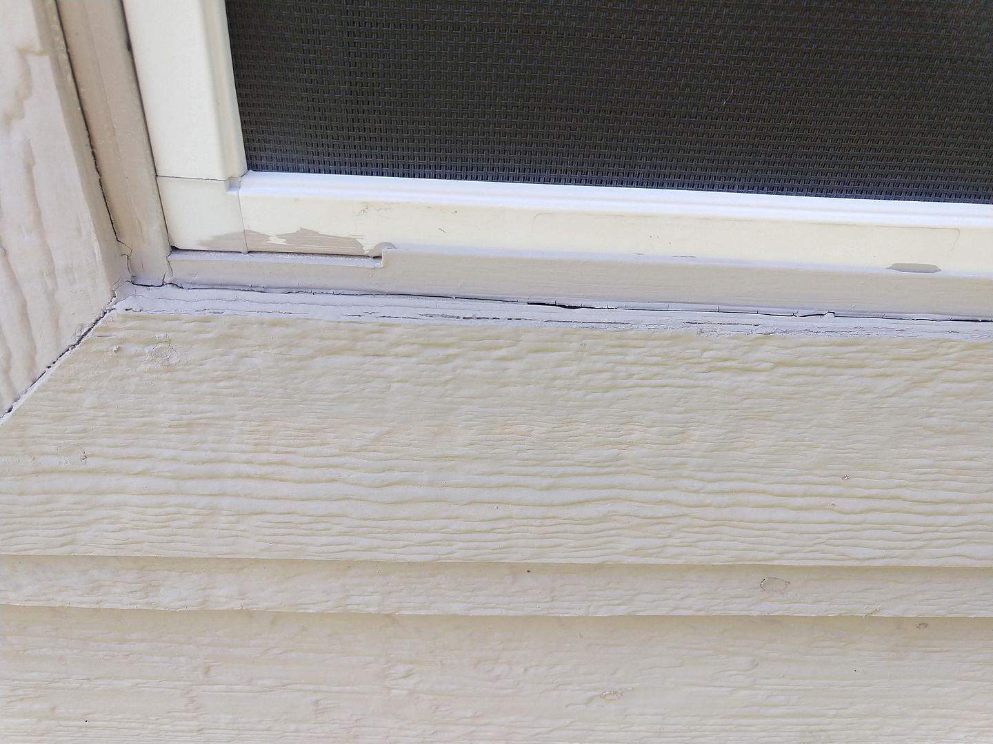

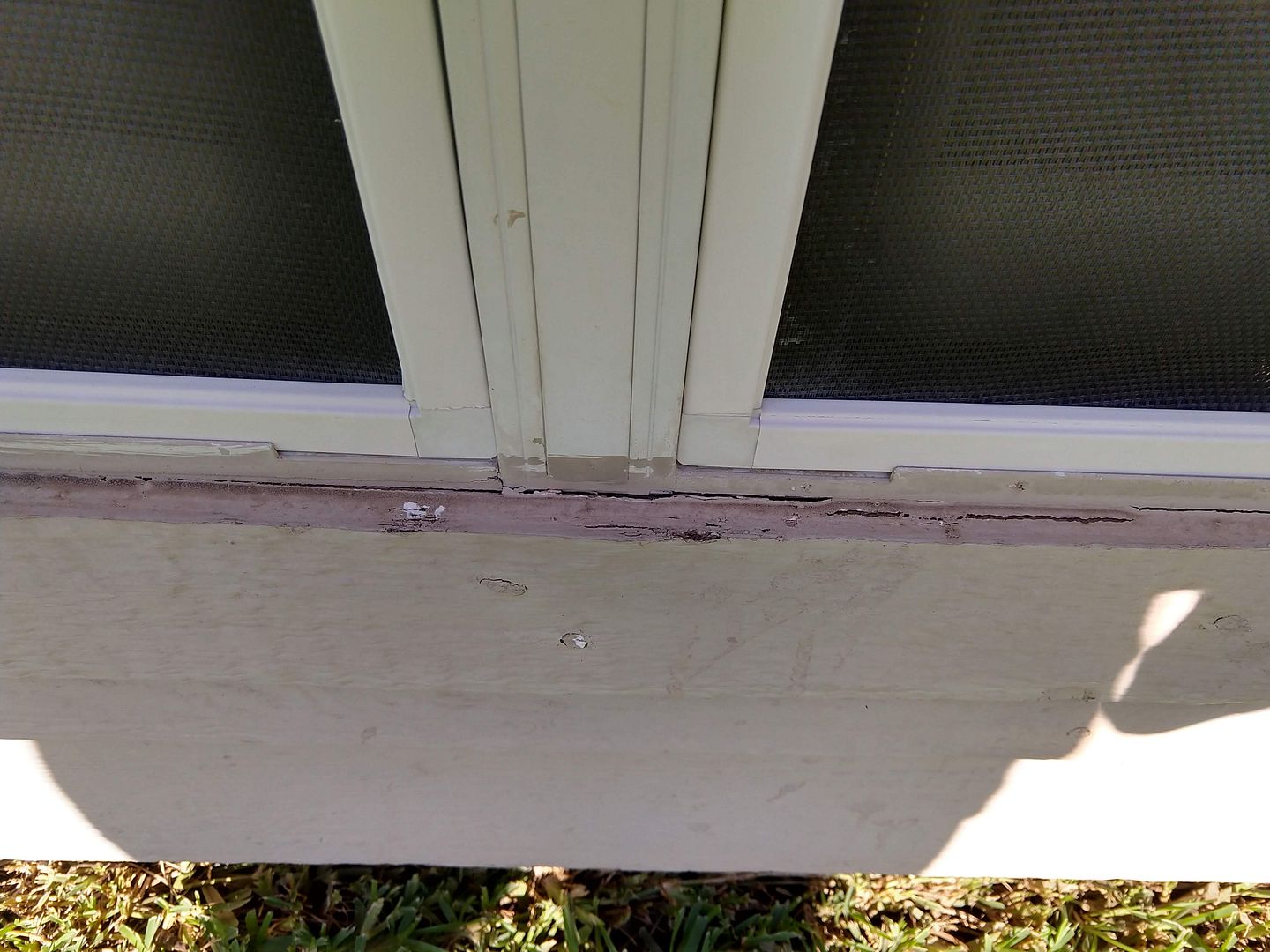

1. Next step before painting is caulking and I am not sure if all 4 sides of windows need to be caulk? Even the bottom?
1.1 do I need to leave any part of window without caulk for water flow from rain? Same reason why we dont caulk under each board that is overlapping. Not sure on the windows.

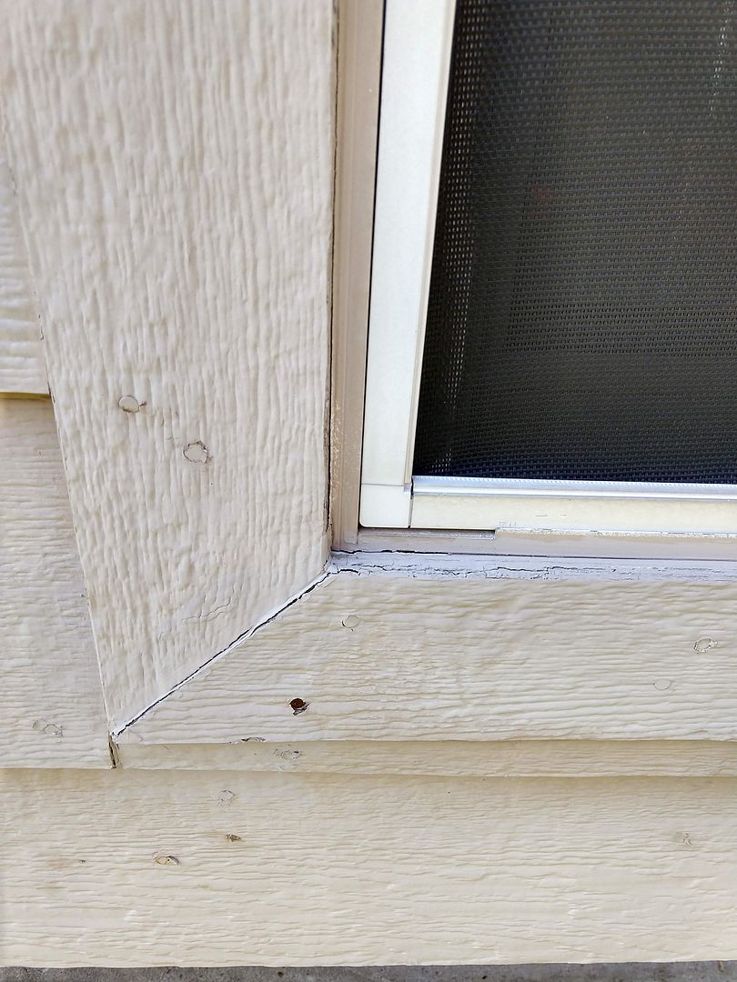

2. Also what about gabs where the siding is cut at a 45 degree or so around the windows. Caulk that?
3. Should I try to remove the old caulk before putting new one on? Some of the corners of the wall for example caulking looks fine, just discolored due to elements over time. I think I will not remove it unless its separating or there are big gabs in the caulking. Same goes for window?
4. If old caulking does not look really bad around the windows, can I just put another layer on it, rather than trying to remove it?
5. I never done outdoor caulking before, I use tape on both side to lay it down usually to get a nice clean spread. Used to go over with my finger and use wet towel. But I could never get it down nice. Any other suggestions?
6. I am not the first owner of this home. Can someone tell me what type of siding is this since if any replacement needs to be done in future. I like to find same or close enough siding. Not sure if Home depot or Lowe's caries these or how to reach out to MFG?
I can add more photos if someone wants to look at the entire home or zoomed in or out more on windows! Let me know. Thanks

If it is soft, replace it. You caulk ALL gaps, everything you asked about earlier, everything you have an arrow on. Anywhere there is a gap, water gets behind the siding where it can mold and rot. That's why it's soft, water has gotten behind it and rotted it. It's not appropriate to patch somethi that's soft... it won't last. L.P. is cheap, just pull it off and replace it.

The answer to all your questions is yes. And like the last time you posted with siding questions, it's LP Smartside lap siding (probably the 38 series) with LP Smartside trim.
When caulking, I prefer to use OSI quad, but it's more of a professional product for ppl who are good at caulking (who don't use their finger or tape). It just doesn't tool well is what I'm saying, and it's oil based so you have to use paint thinner to cleanup. Some people hate it, professionals love it because it sticks to anything and doesn't Crack in a short time like latex caulk does.
kakashi voted this post useful.

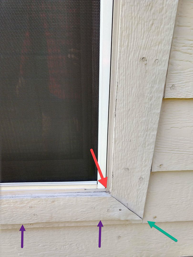

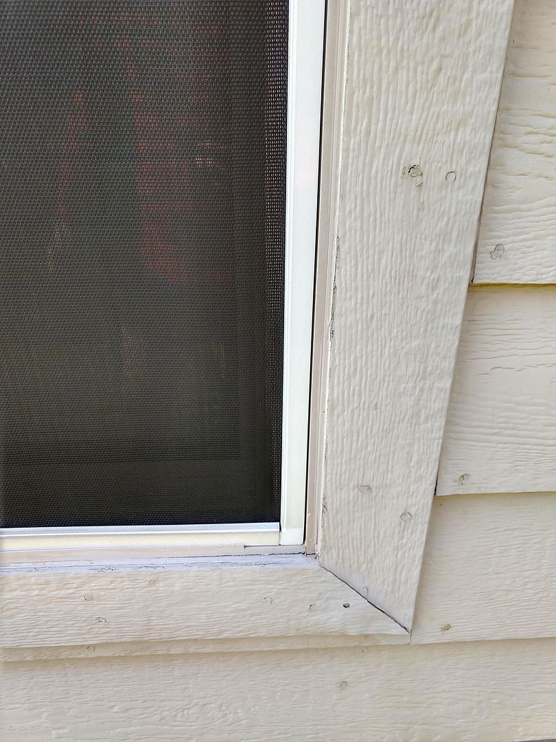

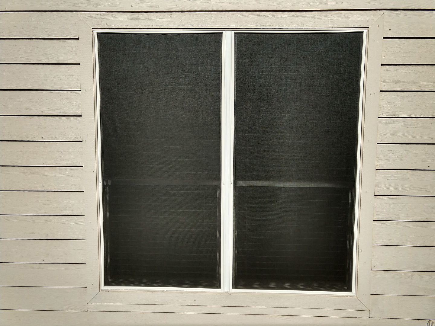

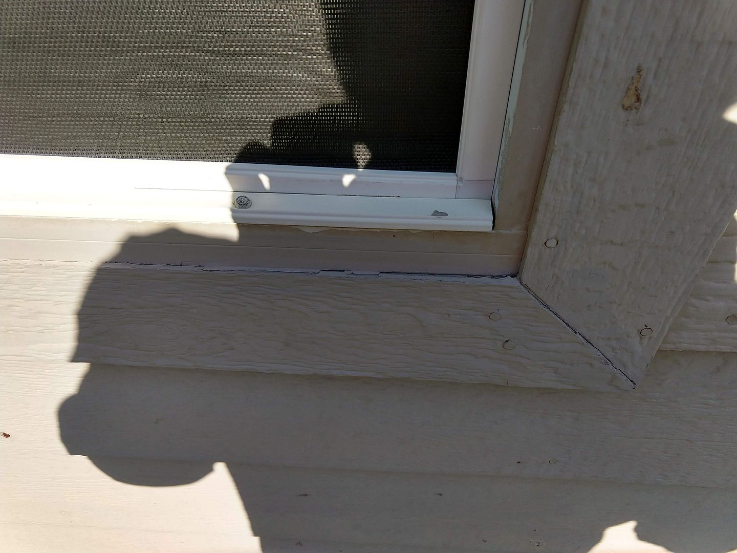

My screen framing I will not caulk that since I usually remove them during winter. But I am go to caulk corner where red arrow shows and green arrow shows and in between. I dont need to leave any thing for water to pass any where?
I am assuming I dont caulk where the purple arrows are made in my photo below. I don't think there was any caulking there.
I will caulk the sides and top of the window frame

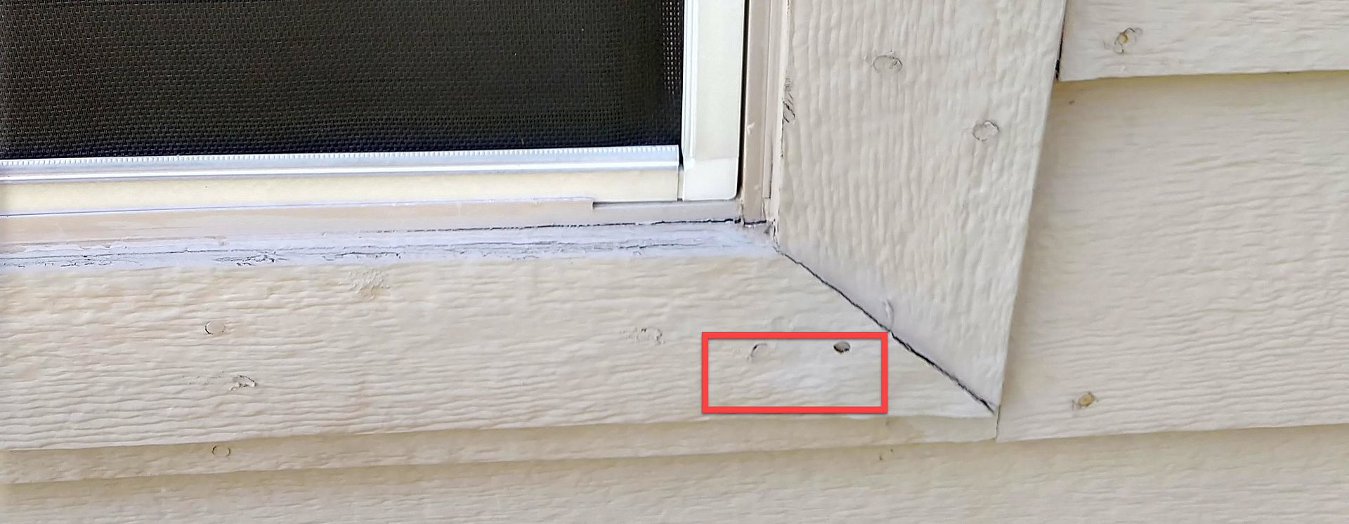

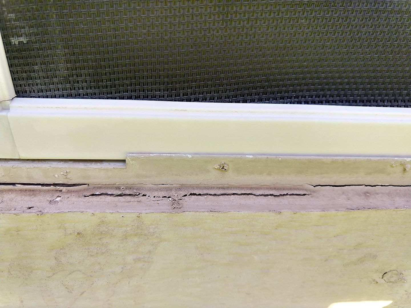

Also while inspecting all the sidings. This window is located on side of the home and I notice the area marked in red only was a bit soft. I did not think its bad enough to replace the entire piece. I am planning to using these two items to fix the small area. Will that do it or should I try something else?
Wood Hardener
https://www.homedepot.com/p/Varathan...0229/305626727
Advanced Exterior Spackling Paste
https://www.homedepot.com/p/DAP-Plat...8741/303781000
