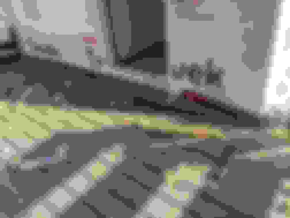

Not sure what to do here. I want to move the deck steps away from the side of the house so that I can vinyl side the complete side.
They nailed the stringer directly to the wall for support. As you can see, other than that, there is really nothing supporting the 2 x 10 that it is attached to.
Any suggestions?
  #87
Old 10-15-21, 05:31 PM
XSleeper's Avatar
Join Date: Dec 2004
Posts: 29,246
Received 1,528 Votes on 1,372 Posts
Tear the steps off and start over once your done siding. You can hang some framing down from inside to support that 2x10. Then something should be kicked up alongside the joists at a 45 degree angle.

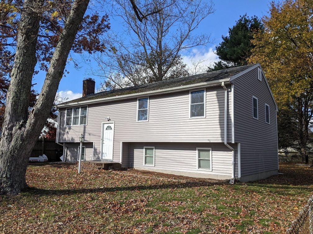

Looks like the j isn't needed over the door as the soffit will just sit on top of the brickmold.
I ended up lining up the siding j with the tops of all the windows as well as the door brick molding in order to hang the soffit. Is there anything I need to or should do above the siding J to help prevent water penetration?
I'm getting there, I only have the left side of the house to do. (progress photos)
  #89
Old 11-15-21, 03:35 PM
XSleeper's Avatar
Join Date: Dec 2004
Posts: 29,246
If you ever plan on powerwashing the siding or soffit, you would want the j channel there to deflect water, and to "kind of" flash the top edge of your housewrap there, or else water will run behind the housewrap. I've seen it happen with the occasional ice dam in the winter too. Water goes weird places that defy gravity.
Shim the j channel down with a strip of plywood that is the right thickness so that it will sit tight to the top of your siding and brickmold.
rufunky voted this post useful.
