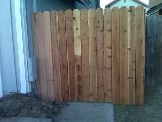

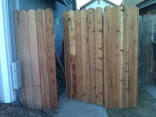

I decided to modify the design a little from the previous idea that I had... now the fence looks completely flush from the outside, I'll try to get pictures to show how the job went within the next couple days. Thank you all for the assistance with this project you've helped a great deal.

Thanks again to all who gave advice, I know the project wouldn't have looked half this good if it weren't for all the great advice doityourself.com is a great site!!!
Enjoy the pictures!
Enjoy the pictures!
