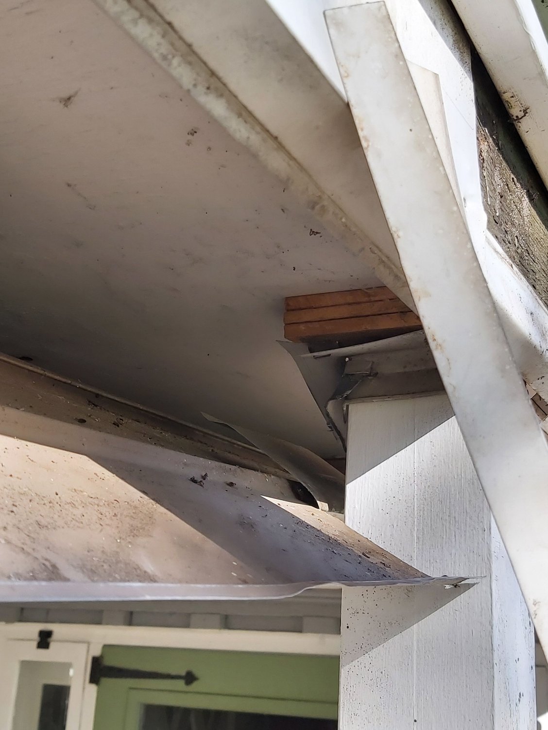

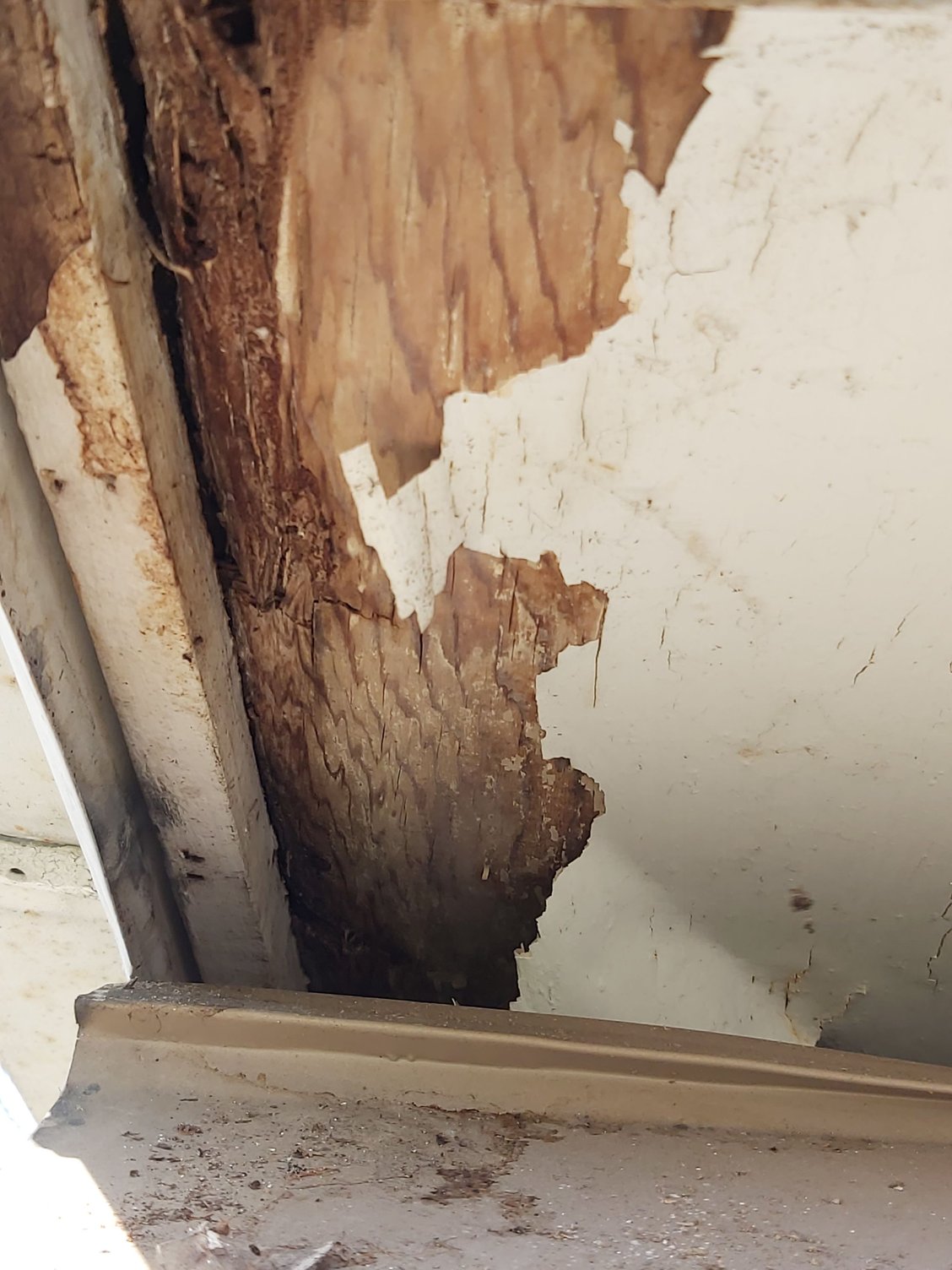

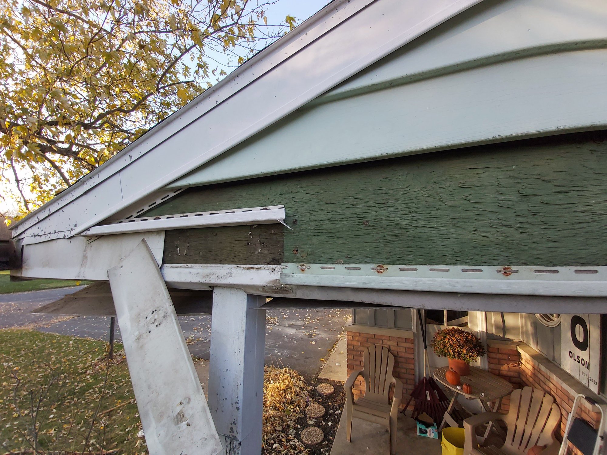

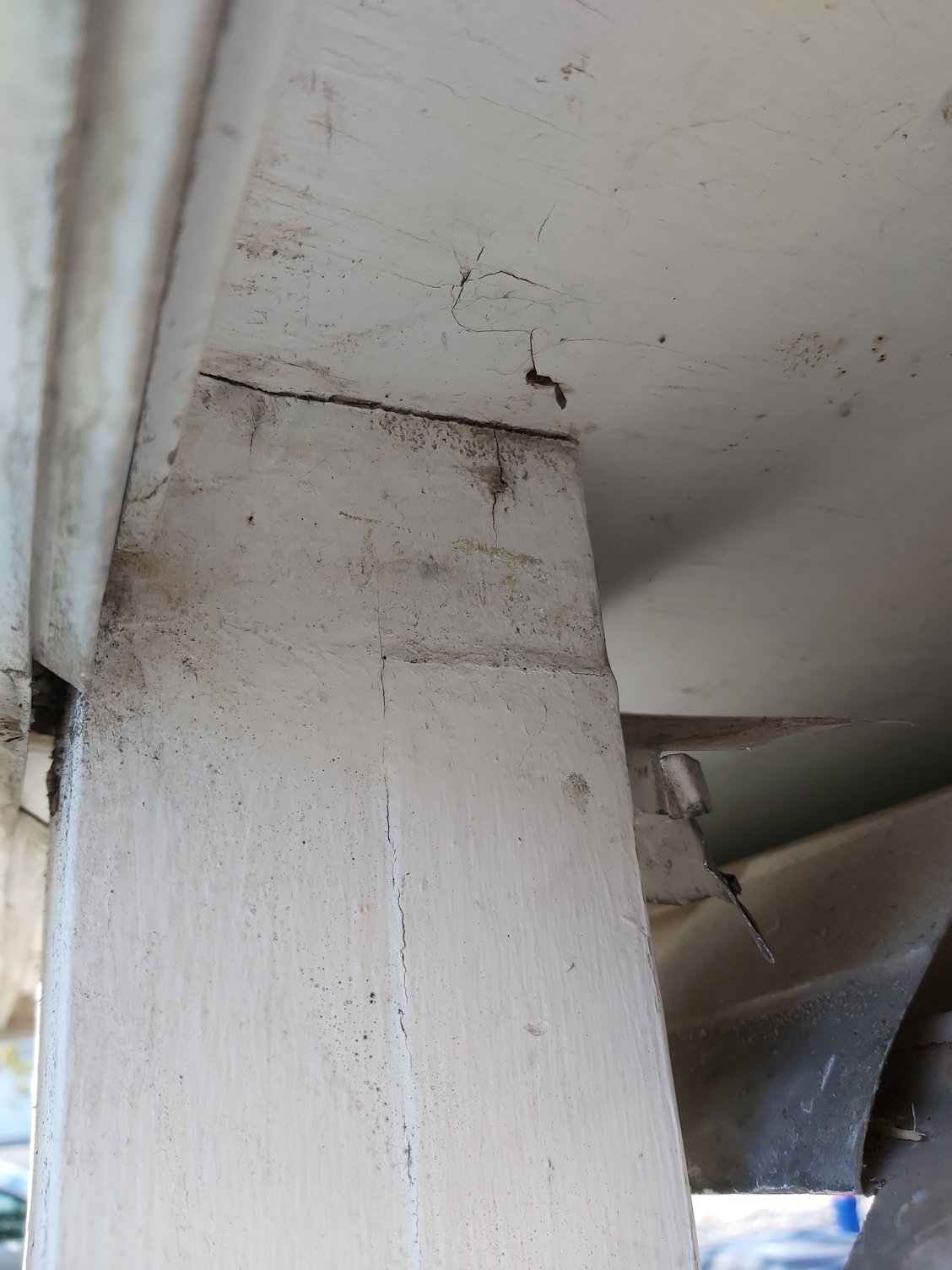

I started tackling this today. I have the end soffit partially lowered down, enough to see what appears to be the top of the post. Not sure if it shows up clearly in the picture, but the white-painted wood above the soffit is above the post as well. Unless there's a smaller section of the post above the visible part, but that doesn't seem likely.
My challenge now is figuring out where I can safely put a jack. I had expected to find the trusses directly on the other side of the soffit, not solid wood covering the entire expanse. Wondering if I'll need to cut away a section of that wood to confirm the truss locations. Actually, now that I'm thinking about it more while typing this out, it sure seems like the whole south end would have a truss member above it. So as long as I place the jack underneath that south side, it should be good. Would sure feel better about it knowing for sure, though. Suggestions? Also, I'll have to somehow get that end piece of soffit completely removed to fit the jack up against the wood and not the soffit. It seems to be securely crimped into the adjoining piece. Not sure I can get it detached without mangling it in the process.
The east side of the post
The west side of the post.
Some water damage to the wood above the soffit at the front (west side) of the porch
Outer view of the south side

Looking at your first pics, 1 if not 2 sides of the current post if wrapped would not fall completely on the concrete. So they effectively are not included in support. The other two sides touching your concrete would be at most 1.5" thick (thus providing very little lateral support). One of the properties of vertical wood support qualifying as structural is the continuous cross section of wood. You can eliminate the current post as providing any support due to the rot (I know it provides some currently but because of it's condition I wouldn't use it in any support equation). In the end you'd wind up with the 1x's boards as the only effective support.
I'm not a structural engineer but I wouldn't do it that way.
Take a 2x4 or 2x6 and use it to span 2-3 ceiling/roof joists and then put your temporary jack studs under it.

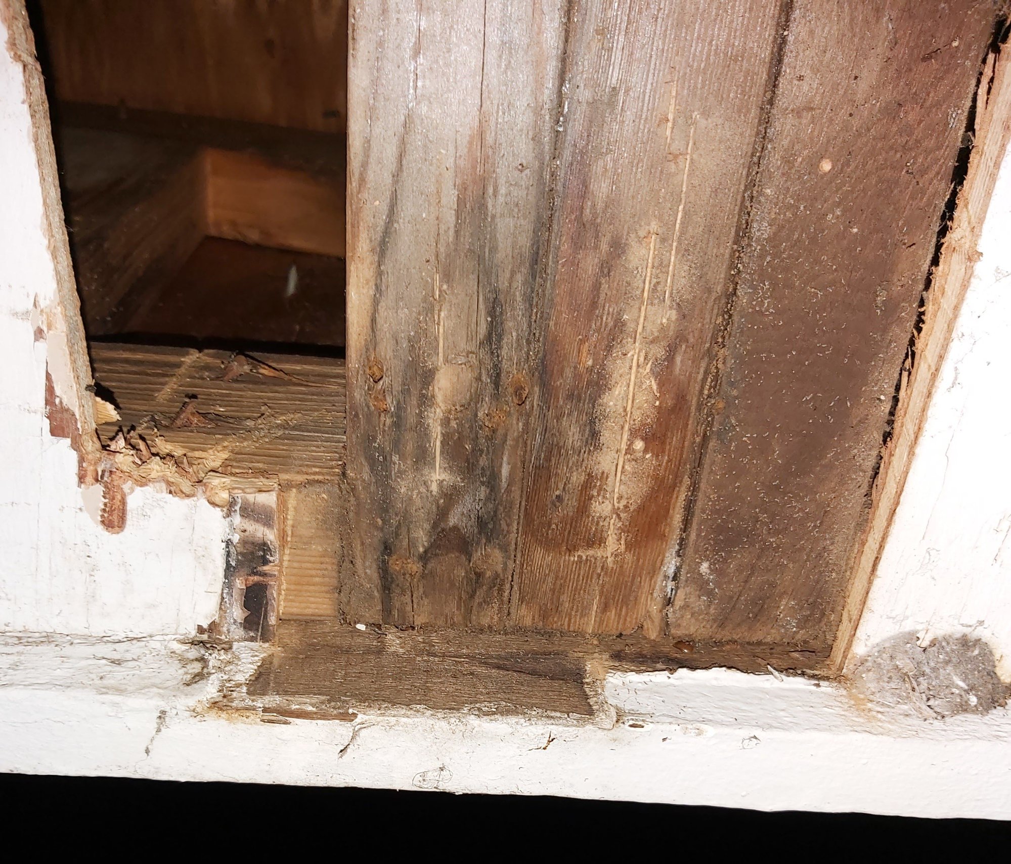

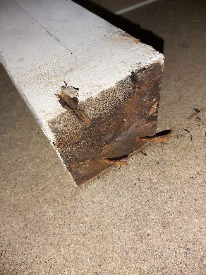

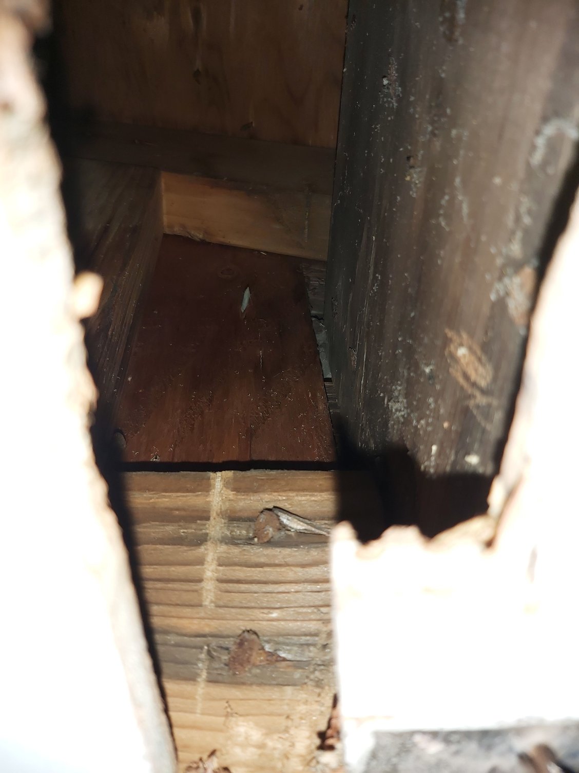

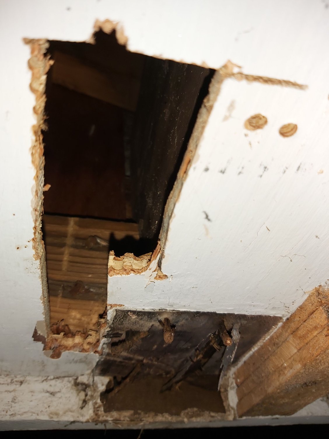

I took the old post down tonight. If my understanding of toe nailing is correct, then you're correct about it being toe nailed to the beam. Nails were angled up from the top sides of the post and into the wood above, but the heads were embedded into the post and then apparently patched over to make them invisible from the surface.
I enlarged the hole a bit as well. I can see the truss-like members now. The beam is pretty big, didn't have my tape measure with me at the time so haven't measured it yet. Looks like probably a 2x8 or 2x10. Haven't confirmed the width yet, need to drill some more holes to find the other side of it. It's curious that the beam wasn't centered on the post, but on the edge of it. Next step is to find the other side of the beam, then cut away the plywood underneath the beam where the new post will sit. Hoping I can then securely attach it directly to the beam without messing with toe nailing myself. Once I confirm the width of the beam then I'll know what my connection options are.
Top of the old post, showing two nails that remained in the post when I pulled it down.
Surface area where the top of the old post touched the plywood above.
Glimpse of the truss section and the beam.

Yes, that is toenailing. Simpson makes all kind of straps to attach wood at different angles (see hurricane ties). I'm thinking you'll need to remove those 3 stacked boards, they'll interfere with your trim boards. I know it's another tool to store when not in use but if you don't have one, get a oscillating multi tool. They're $100 and up. They are so useful for so many projects. They would make opening up that plywood to expose the beam/rafter very easy and clean.
Toenailing upside down is can be challenging. I've found it easier sometimes to start the nail more perpendicular to the wood, then sort of bend it up/down to the desired angle. That way the nail doesn't skip when you initially hit it.

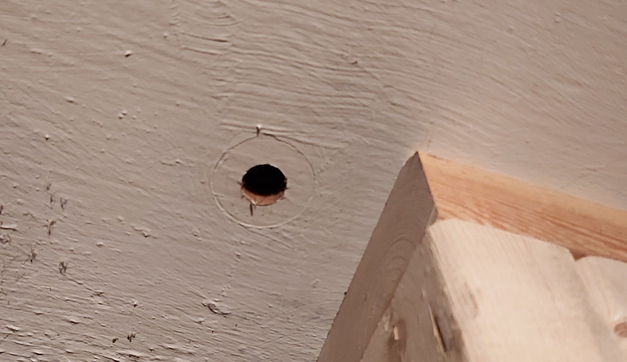

Turns out the beam isn't just one 2x8 or 2x10, but three of them sandwiched together. The one whose side is facing the plywood hole is roughly a 2x10 (1 5/8" x 9 1/4"). The middle one is even wider, as I can tell by feel that it extends another inch or two above the top of the first one.
The old post was centered underneath the first of the beam boards, not all 3. The 3 beam boards together have a combined width of 4 7/8 inches. My plan now is to place the new 4x4 so its edge is aligned with the edge of the first beam board, and connect the two on that side with a Strong Tie AC Post Cap. As the opposite side of the post will be underneath the 3rd beam board, I'll have to somewhat improvise I think. The Strong Tie DJT Deck Joist is almost just right for the task, but the post-edge distance to the beam edge will only be roughly 1 1/4 inches, not the 1 1/2 inches for which the DJT appears to have been designed. What do you think about toe nailing it on that side, and then overlaying the toe nailing with the DJT? Would it make sense to shim out that side of the beam by 1/4 inch so as to get a secure fit with the DJT?
Unrelated to the current task, but this hole in the plywood makes it appear that the plywood was the original porch "ceiling" for the house's initial years, as it looks like a hook was screwed into it for hanging a flower pot or something.
