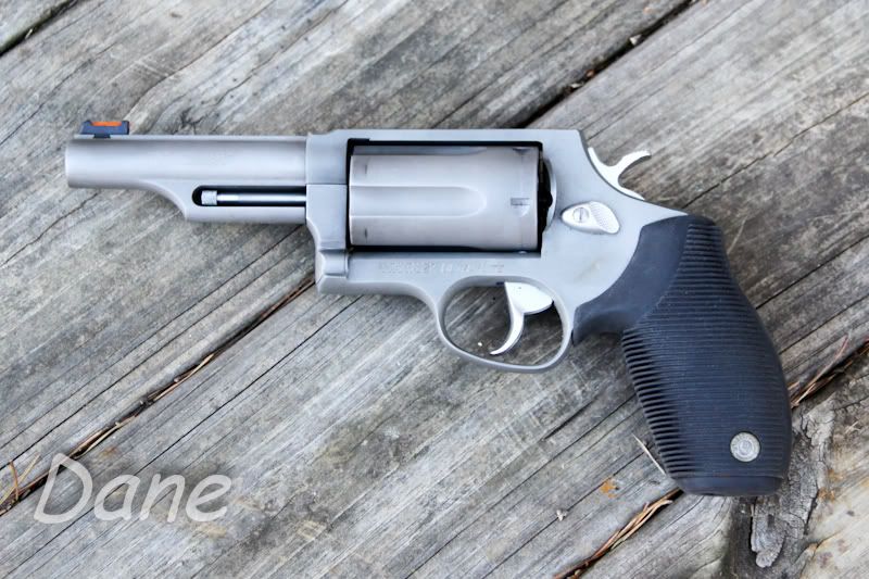

For the test I used my Judge Ultra Light and a shooting chronometer to measure the velocity of the projectiles.

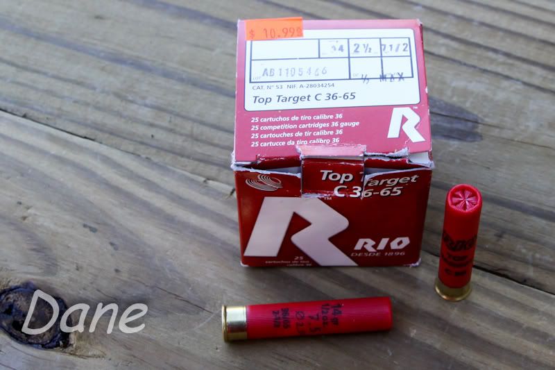

Since I am not a fan of the Judge as a defense weapon I also tested it with a variety to bird shot for use against small vermin. Since these cartridges are not marketed for use in short barreled pistols I don't mind the velocity claims printed on the box. Here are the results:

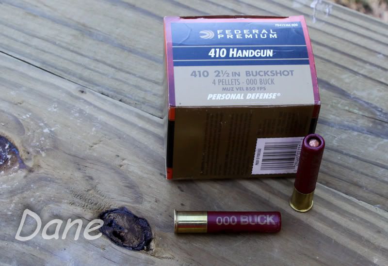

The fastest buckshot cartridge, the Federal with four 000 buckshot, had a energy of only 100 ft/lbs while the Hornady .45LC came in at only 81 ft/lbs. Compare that to the 125 ft/lbs of energy in my 32 grain .22lr test rounds. Something must be totally wrong. The felt recoil from the Judge tells my palm that there is a lot more power there than my numbers say. At first I thought the chronometer was seeing the plastic shot wad which at 10 feet from the gun would be seriously slowing down. Unfortunately the velocities from the .45LC rounds were also in the same velocity neighborhood so I have to assume the chrono. was seeing the shot. So, what's going on? What did I do wrong? I've been racking my brain and cannot figure out why the velocities are so low. I then got out my .308 and fired some rounds and they reported up in the high 2'700's where I expect so again I'm thinking the chronometer is correct.

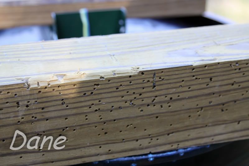

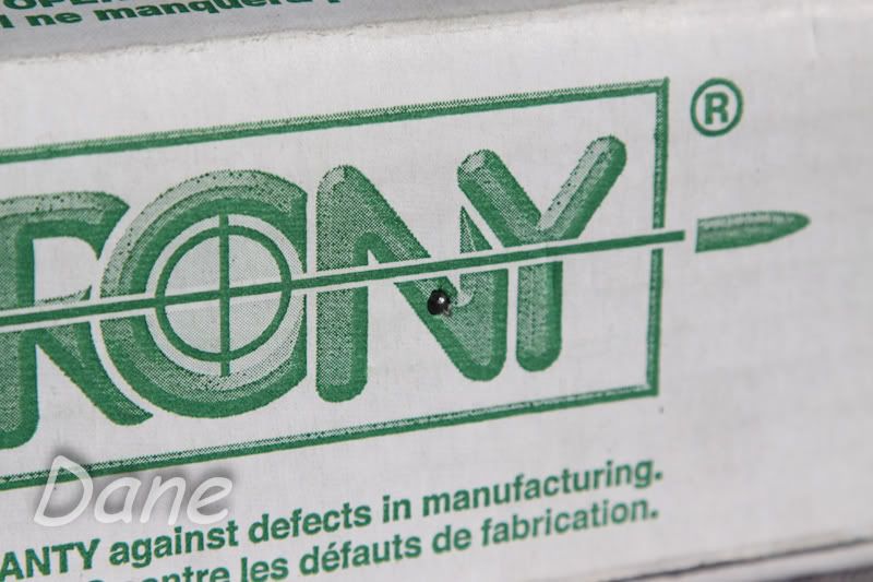

Knowing how the shot shells would pattern I am very glad I protected the chronometer with blocks of wood, which ended up taking more than a few pellets.
I expected some couchettes though I never felt any touch me. I wore safety glasses and a full face shield just in case. Packing up I saw that at least one pellet bounced back and embedded in the box sitting at my feet so I don't feel so wussy for wearing a little protection.

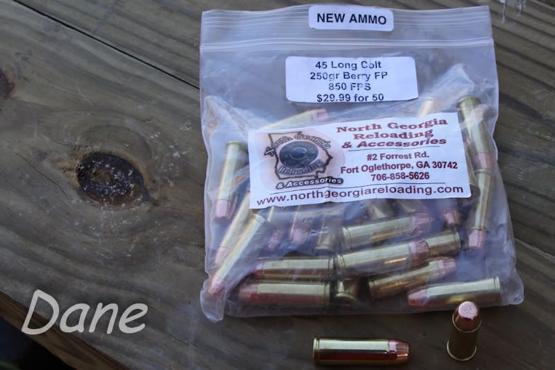

I took out a Bond Arms Derringer with 3" .410/45LC barrels. The cheap .45LC averaged only 80 fps and the Winchester #6 shot were 173 fps. Even the 80 fps rounds were hitting the water 40 yards away, close to my aim point and the bullet was not visible flying through the air so I know they were going faster than 55 mph.
