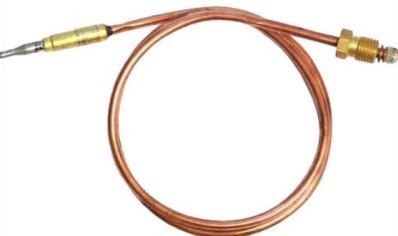

Would that be a slight gas leak ?
A thermocouple sits in the flame and generates a small voltage to hold a gas valve open.
It connects to a gas valve with a small nut but there is no gas in it.
Can you post a pic of it....... How-to-insert-pictures.
Generic thermocouple.

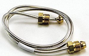

I can't update the thread. The leak is inside of the pilot flame just inside of the nut. We tested with a meter. The replacement tube has threaded nut on both ends that need to be replaced. Do I need thread tape on that or any sealant?

Gotcha. Pilot supply tubing leak.Title corrected.
Does it look similar to the picture ? Maybe a little fatter but the nuts spin loose ?
That is a flare fitting and doesn't usually require any sealant. The nose is shaped to do the sealing.
You could put a small amount of pipe sealant on the threads but usually the gas leaks between the fitting and the tube and there isn't a way to seal that. In a pinch..... if tightening slightly doesn't stop the leak.... you could put a very small amount of sealant on the beveled end but it cannot get into the pipe.
Pipe thread sealant

100% match. Thank you sir.

I lied. The end that connects to the main gas housing is male but the gas valve near the thermocouple is female. I searched Home Depot and couldn't find it. Is there a technical name for it?
