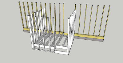

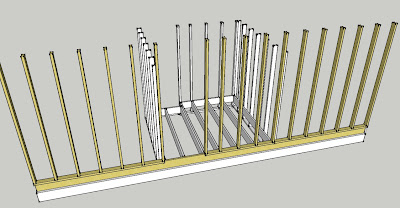

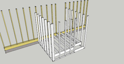

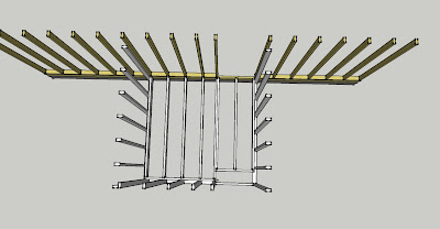

OK, here are a few images of what I have in mind. Note, the stuff with color is the existing kitchen wall, while everything in white is what I'm planning to add:
A few questions:
1) Does this look overall feasible?
2) Can I just use joist hangers for all the joist hanging from the new rim joist (which is attached directly to the studs on the new walls)?
3) Any special watchouts around the new step area?
Also note, I will be adding a wall on this raised area basically dividing it into a hall and a bathroom.

G, egress does matter if that main level has no egress sized windows, so lighten up a little on stopping safety concerns from entering the posts. Some shotgun type kitchens I have been in are almost tubular in design with a door at the end and no means of egress within 20'. The kitchen window, if any, wouldn't suffice, in those instances. So egress from a door to safety would make sense. Now the OP may have a different design, and we'll let him and his inspectors decide on his particular situation.
And the OP is working under the Southern Building Code, which may differ from where you are located.

I am south of Nashville so my suggestions may not apply. Piers are not used here. Blocks of block and beam usually rest on 16"X16"X4" thick pads just enough into the ground to level. Concrete floors generally don't have peers. I saw the slab as a thicker stronger substitute for pads. My answer may well have been totally wrong for his area so please ignore.
