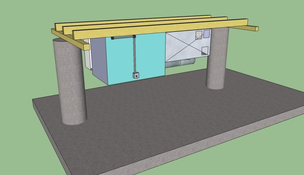

I didn't notice nothing was there lost internet while editing. I would put the furnace on a temporary scaffold system. Then fix the sag in the joists by raising about 1/8" a day till level and then attach a sister joist to each one. Then I would build a support system for the joist Its basically a pillar support with a 4"x4" across the affected joists. See pic:

Hi JP. first, understand that a sister attached to a joist that has been forced back to straight, will rebound about half of it's memory. If you force them to be straight, they would have to stay there for years before they their memory is gone.
A furnace that is designed to hang from above, may not be able to be supported from below. Something you need to determine.
I don't see where you mention what your current joists are, 2x8 or 2x10 or what? But any common dimensional lumber, even with new sisters, will slowly sag. I would consider two engineered beams as large as you can get in there to take over the entire load. Engineered beams will resist sagging very well. The trick will be getting them into position.

1/8" a day is the norm, it is actually a pretty small amount. But you can go slower if you feel it necessary.
