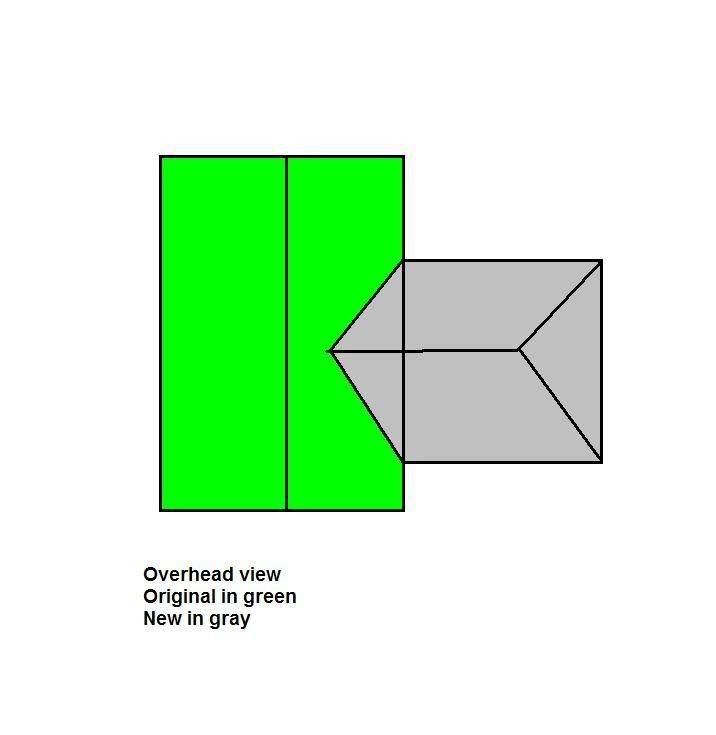

Roof
Here is my visualization of the view from above of the old and new roof configuration. The original roof is a gable roof and the proposed patio cover is a hip roof connected to the existing gable roof. The roof pitches of the old and new are the same pitch. Is this close or am I way off?

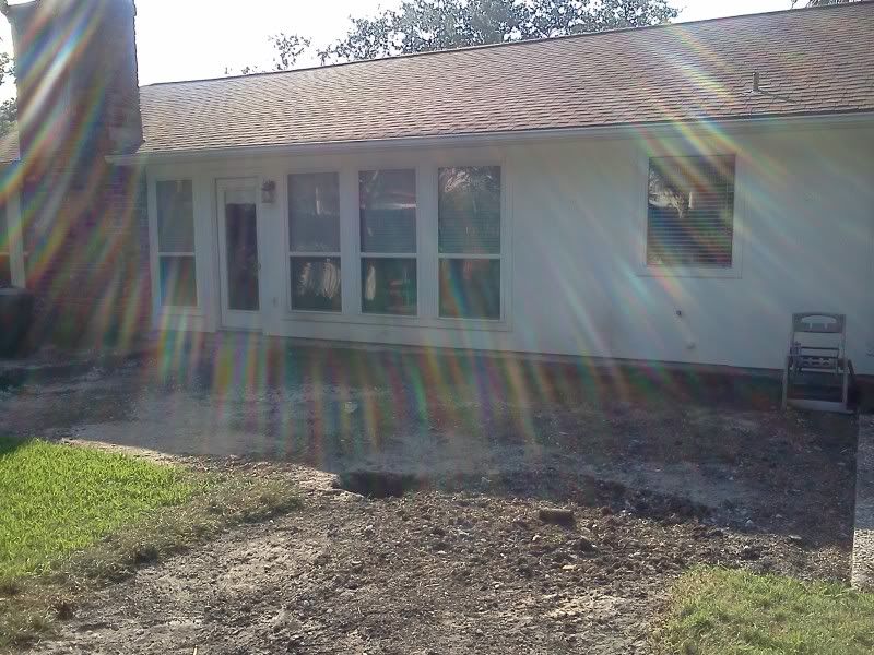

Yes, that is exactly what I'm planning to do. Attached is a pic of the back of my house. Obviously, the slab has since been repoured. The cover will go from just to the leeft of the back door to just before the kitchen window underneath the roof jack.

Ridge Board
The ridge board will be same length as the 2 sides of the roof addition. Look at the upper and lower horizontal lines in the gray area of the diagram above. Hope this helps.

Patio Cover
.if I want my overhang to match the existing overhang exactly, won't the top plate of the patio cover have to be at the same height as the top plate on the rear of the house?
Yes, and I agree with your calculations.

In my experience you will need to adjust the pitch of the new roof to match the ridge of the old roof. you do want the ridges the same and tied together do you not?
If the new addition is 16 feet wide with a 5/12 pitch then the top of the ridge board will be 80 inches tall. Let's say for guess that the old is 24 feet wide with a 5/12 roof. That means its ridge is 110 inches tall, so if all the walls are the same height then the new roof will fall 30 inches lower than the old ridge.
Now I am not saying that is not good just that you need to be aware of it before you start building and then are confused when the ridges do not match.
I am a bit confused on the hip roof to gable roof thing as a true hip roof would only touch the new roof at the existing exterior wall. Meaning the peaks will be quite a ways apart and I see a potential for snow and ice to build up in this area. Or am I totally off base there?
