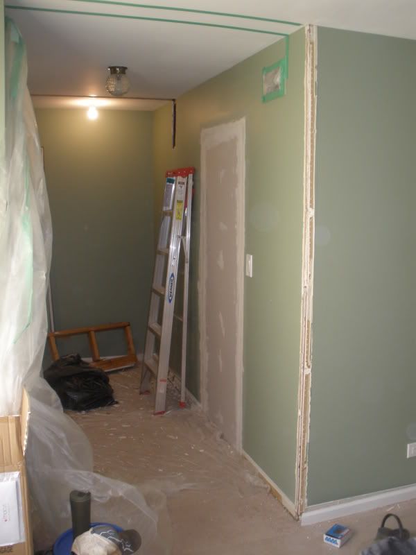

I am helping to transform a closet alcove in a bedroom into a walk-in closet. I need to build a wall with a door between 2 finished walls/corners. Is it acceptable to attach the new framing end uprights thru the existing wall drywall? Or do the areas where the new framing attaches need to be down to bare studs?
Need to add wall between the left & right walls to make this area a walk-in closet:
Thanks for any help.

I'd probably remove the baseboard on each side and then glue the perimeter framing to the drywall and save yourself some work. You should be able to toenail into the top and bottom. If you put up the perimeter, a couple braces across the middle will hold it into the construction adhesive until it sets up. Just be sure you select perfectly straight 2x4's and ensure that you have them plumb on both sides or you will be kicking yourself when you go to put the door in.
If this wall is going to be flush with the existing corners, you definitely want to remove the metal cornerbead from each corner first.
My favorite is PL polyurethane. (but I don't like how it keeps oozing from the tube.)

Ok I have a new question that I would appreciate any answers/opinions about. The right and left wall/corners that I am building the closet entry wall between are not straight across from each other.
Meaning that, (use photo for reference) if you extend the facing wall on the right (straight out) to meet the wall on the left, it actually meets the left wall about 1-1/2" back from the corner.
Do I just angle the wall I am building so the drywall is flush with both current facing walls, or do I extend it straight out to the left and have a 1" setback from the left corner?

Well that sucks.
Yes, it would probably be easiest to extend the wall on the right, which would create an inside corner on the left side. That way you will only have one butt joint (on the right) and one inside corner (on the left) to tape. A little less work that way. You would leave the existing corner bead on the left intact... but you would want to remove the corner bead on the right side to get rid of that "bump" so that you can line your drywall up exactly.
You could also extend the left wall and put the door in it, but it would probably be a little more work, because you would have the one butt joint (on the left) and it would also create an outside corner bead where it meets the wall (on the right)... plus you'd still have an inside corner to tape (also on the right).
Out of curiousity, how did you determine the walls are out of alignment? I'm assuming you placed a straightedge on one wall or the other? You'll get the best reference marks with a chalk line (or mason's line if you don't want to leave a mark on the ceiling) by extending the chalk line clear to the end of one of the existing walls, and place the chalk line parallel to it, then extend it beyond the corner.

As far as determiniing their alignment, I just held a 2x4 - 8 horizontal and against the right wall. Extended it out until it reached the left wall, and it was off. I will use my laser line when I go back tomorrow.
So you didn't mention just building the wall from corner to corner. I wonder not only which way is easier, but also which way is more appealing when looking at the finished wall.
One thing that might be a slight concern - if I build the wall back from the left corner.... if the entry door swings out (with hinges on the left), it will not be able to open all the way flush with the wall. It will/might hit the protruding corner first.

Yeah, I didn't mention it because I wouldn't even consider that as an option. If others think it's a good idea, I'm sure they will chime in. I don't have the monopoly on opinions... LOL
I'd build from the corner which sticks out further into the room just to maximize the created space.
I'm with X, I would not just go corner to corner with this, I would go parallel to the existing walls.
That was my first thought too, mitch... it would probably look best too. No problems with the door swinging back either (if that's really a concern). It would create a little more drywall work like I mentioned above, but it wouldn't really be that big of a deal.

Here is one more "before" photo.
[IMG]
[/IMG]
Since the photo I have taken out the doorway on the right. Also have removed the bifold doors, tracks, and have removed the header above the bifold at the back. Working on it more today. Am planning to take some photos.
Steve
[IMG]
