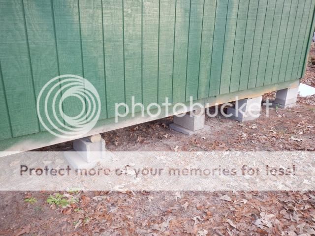

Had a country cabin built about six months ago. It's on blocks and soil is sandy loam iirc. What's the settling time before I get it leveled?

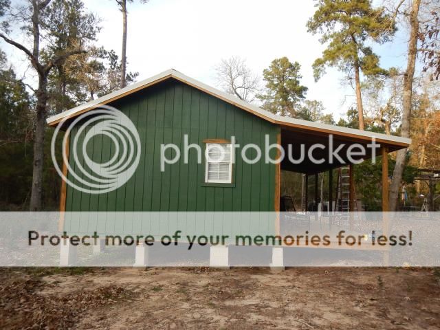

Is there a concrete footer below the blocks or are they just sitting on the soil? A properly constructed bldg shouldn't settle, at least not a noticeable amount. If it has a poor foundation, re leveling may be an ongoing process.

Without footings, it will never stay level. It should have been set on a footing and leveled at the beginning. Of course mobile homes are set on blocks every day, but require leveling. Different with steel beams versus what you have, however.

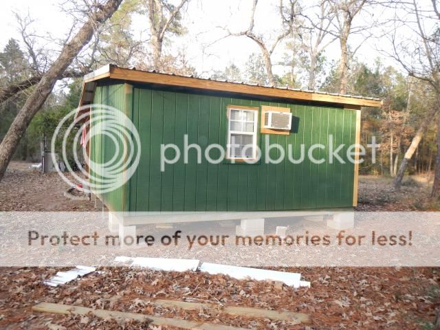

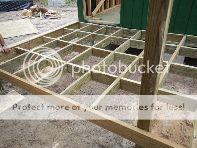

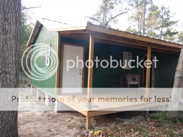

I must be losing my mind, didn't include any pics
The front porch, third pic was set in a hole and concrete poured in, not an actual stand alone footer. Cabin interior is 16x32, porch is 8x32. I did the primer and paint.

And I'll bet those are hollow concrete blocks and aren't mortared. Was it a licensed contractor that did that? No permit pulled I'm guessing.

Correct, hollow and no mortar. See a ton of it everywhere and no permits (or inspections) required for anything but septic. Guessing not licensed, not sure if you need one in Texas like electricians, plumbers, etc., do.

Texas, home of the shrink swell soils.
Without proper footing your always going to dealing without of level issue.
No joist hangers?
Are those just 2 X 6 joist?
No mortar!!
Codes or not there's a right way and a wrong way to build things.

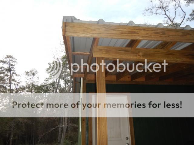

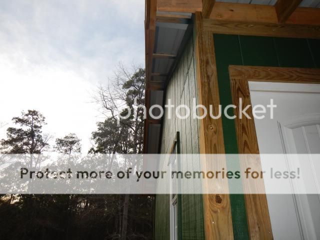

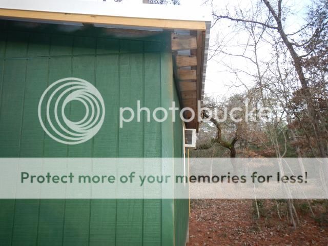

Aside from what has been said on the foundation, you will benefit greatly by extending your rafter tails to 12 to 18" past the edge of the building and installing lookouts and a false rafter at each end to perform the same function. What are the metal pieces on top of the joists on the house end? Did you use joist hangers on the outer band?

Yes, I believe the 2x6, but I could be wrong, no joist hangars used anywhere.
What does the rafter tail/false rafter do? What length should the tails be? 3 to 1 (1 overhanging)? Should I go back and install hangars? How often should I get the cabins leveled?

Ideally you'd jack the building up and support it while the pier blocks are removed and redone with a concrete footer and mortar. Not really a diy type job Whenever construction is booming the good contractors stay busy and have a long list of customers waiting for them.

Yes, install joist hangers at the end of every joist. I see they are resting on a 2x2 at the house side. As long as your joist is not notched, it may pass, but joist hangers are required. Rafter tails and false rafters will keep rain and other inclimate weather from banging your house and causing problems. You want to keep rain at a considerable distance when dripping off. Otherwise your siding will not last long. Rafter tails and false rafters should be a minimum of 12" from the face of the siding. They tend to offer some shade at critical times of the day as well.
You will be leveling the house forever if you don't have footings poured, and will have to contend with door binding, window cracking, interior wall covering (sheetrock) cracking in the meantime.

On the rafters, I'm sure I can do that. If I go 18" outside the structure, do I go 54" on the inside? Also, does that mean all new sheets of metal or can I extend/splice (so to speak) those?

Pictures don't show any metal. Is this thing further along than the pictures show???

The metal problem didn't relate to the overall cabin. If it is dried in, leave it as it is. It is better to have it finished than to go back after the fact and make patch work repairs. Do you have pictures of the exterior of the cabin so we can see how far along it is now?

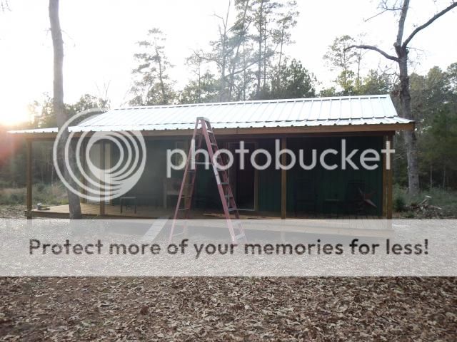

Got off work later than I hoped. Has in a hurry to beat the sunset and forgot to measure rafter size.
Three parts here, big cabin, small cabin, then small cabin deck.
Other cabin, same contractor

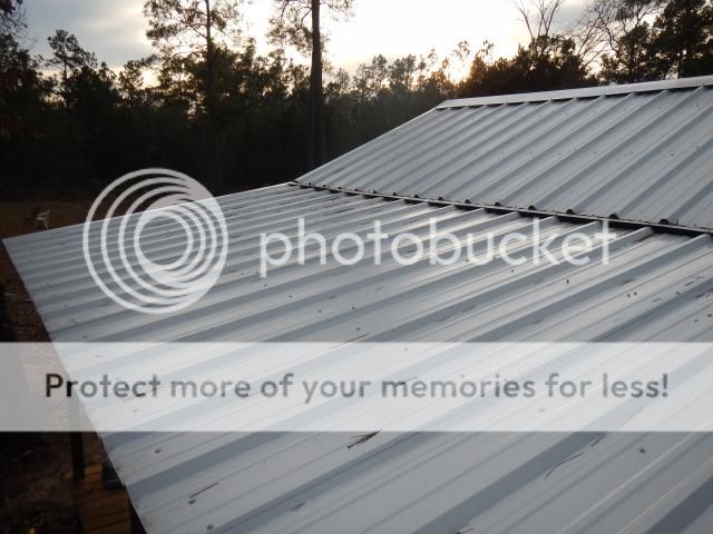

Overhangs are good. Did you correct the over-under flashing between house and porch/deck?

Not yet, waiting for a break in our work schedule. Doing seven days a week at the moment.

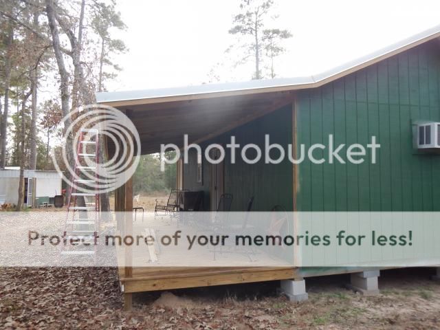

Question about the flashing where the ends meet/overlap. Do I need to add that black sticky stuff that comes on a roll between the seams? The same stuff they use to seal/join the roof sections to each other. Also, do I put the closures at the end of the flashing (like where it is now)?

Asked earlier but didn't get a response. If I get four ten foot pieces for this 32' span, how much should I cut off and how much should overlap.

The flashing between the house and porch/deck.

Oh, OK. You'll need at least a foot of overlap. You will have a little over 2 1/2' each, so no harm done with the excess overlapping. Just remember, under the top half and over the porch part. Glad to see you are back at it
