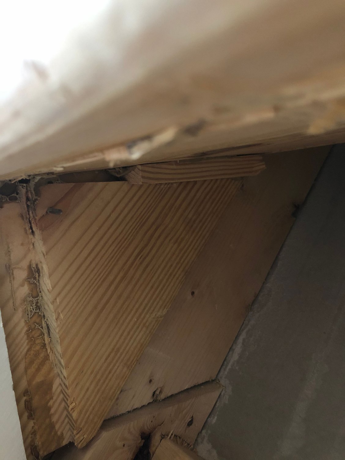

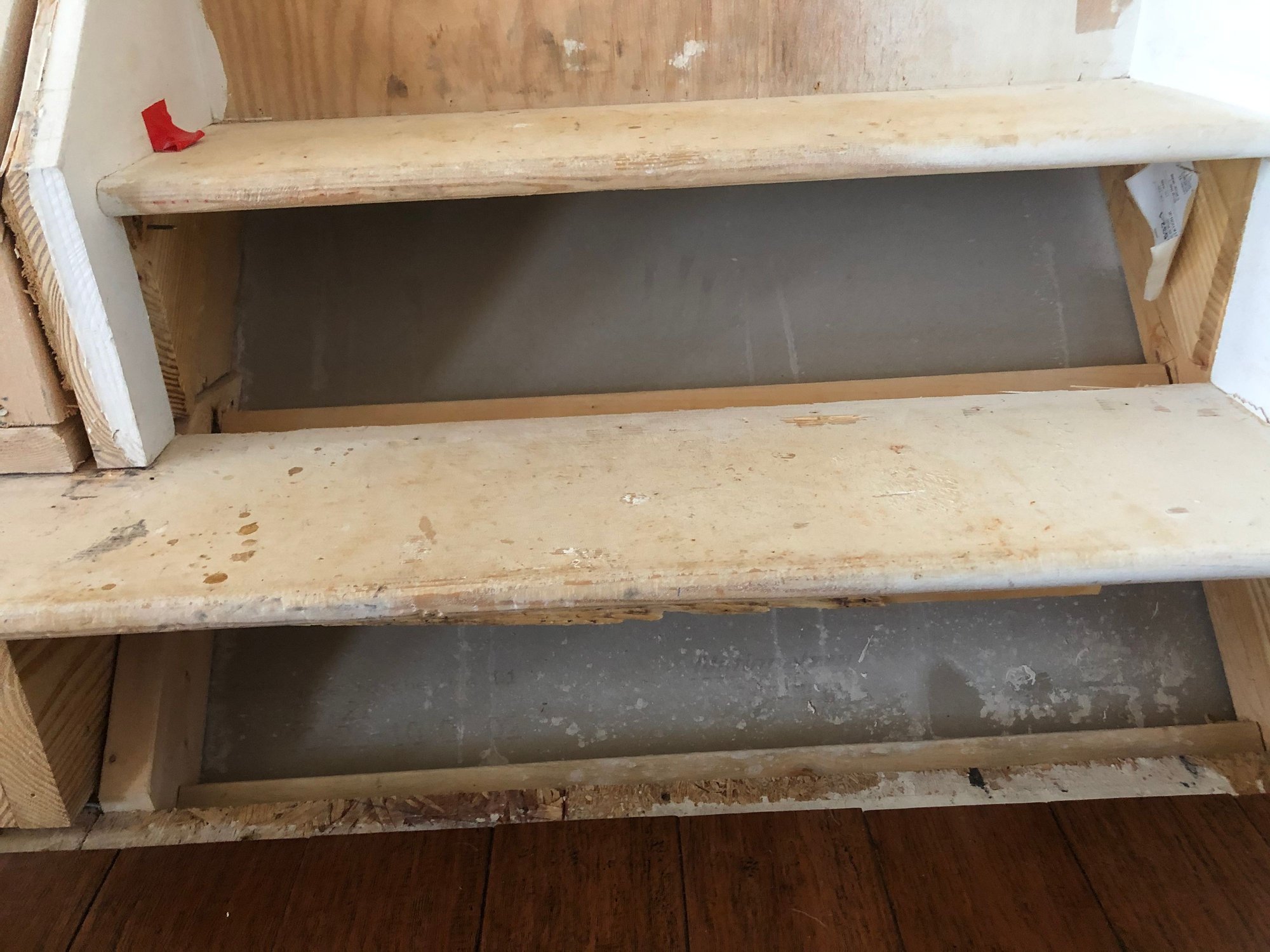

So Iíve attached a few photos. The problem with installing middle stringers is that there is 2x4 bracing every three feet or so that would need to be removed. The drywall below is nailed to the bracing. Also, the builders had to used wedges in order for the treads to fit snugly into the dado. Why canít I just install 2x4 blocking underneath the current treads so I could eliminate the wedges and in places of the side stringers? Also, since there isnít a current middle stringer, they screwed the bottom of the riser into the tread. Why canít I simply have a longer riser and accomplish the same thing with angle iron in the new treads? It seems like I would accomplishing the same thing as the original builders.

Wedges in dadoes are a standard method of construction for such stairs. The 2X block helps with the compression but is not the primary support for the tread. (The dado in the side skirt/stringer is.) The problem with your idea (although it will work) somewhat is that it depends on nailing for support. Also quality stairs have a rabbet/dado joint at the back of the tread into the riser and the same at the top of the riser into the tread giving support across the entire width. Google "stair construction" for some explanations and ideas.

I contacted my county permitting department and talked to an inspector. He said to cut the tread length so that it fits fully inside one of the dados and then slide it over into the other dado so that it fits 1/2 way in both dados. Once in, I then installed and glued shims to the bottom of the tread to force the it to the top of the dado. Then I attached 2x4 blocking underneath the tread and nailed the blocking to the existing stringers. I used subfloor liquid nails to attach the blocking to the underside of the tread.
Before installing the tread, I installed the riser that was above the tread. I similarly used shims to hold it in place. I then glued and screwed a 1x brace 3/4 of the length of the tread that was above the riser, which secured the riser in place. I cut the risers long enough to extend to the bottom of the back of the treads. Once the treads were installed, I fled and screws the riser to the back of the tread.
I followed the riser/tread/riser/tread methodology the entire way and it worked like a charm. I had to gain access to the underneath of the stairway by removing the drywall though.
