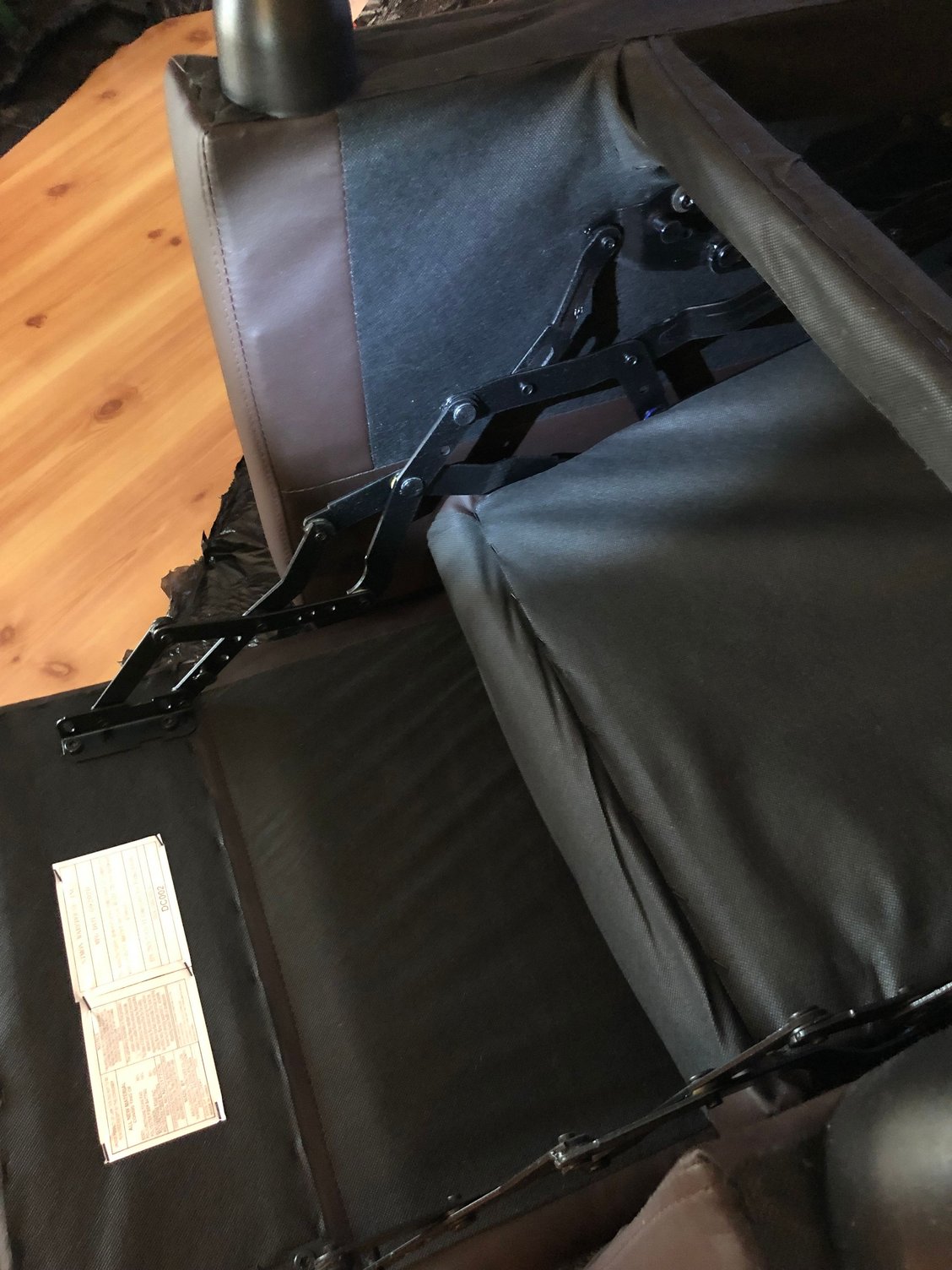

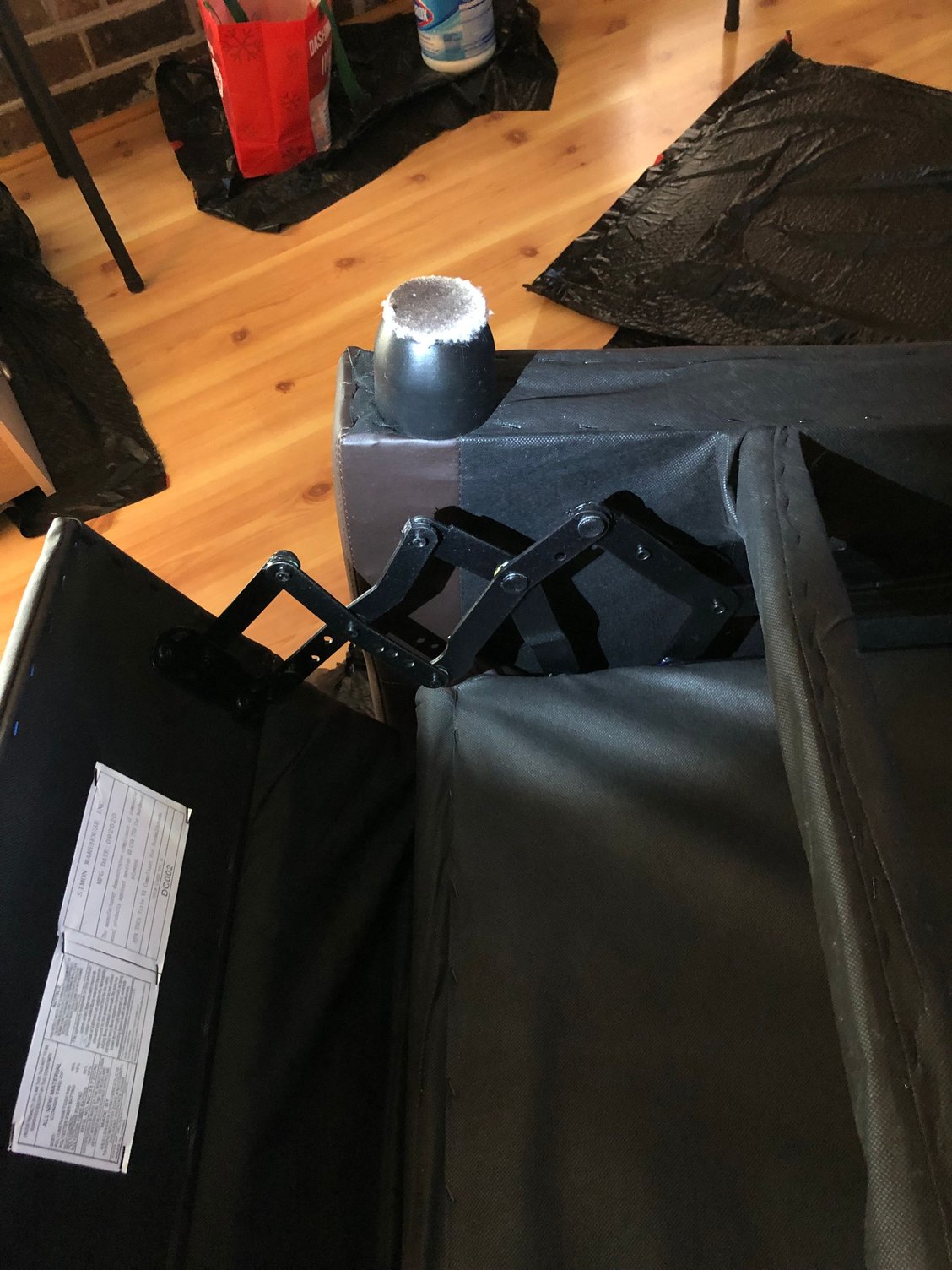

Old 03-21-22, 03:17 AM
Y
Join Date: Mar 2022
Posts: 7
Received 0 Upvotes on 0 Posts
pictures and video of underside of foot rest...please help me ...
...choose the right rivet to remove
Link to download short video of underside of footrest in action: https://we.tl/t-uux8r8c0DL

Old 03-21-22, 11:20 AM
Y
Join Date: Mar 2022
Posts: 7
Either of these two places should work
I was hoping I could keep the footrest in place without it coming out. What would happen if I just removed 1 of the rivets on each side?
I didn't want to join or OK your site that the video was on (I already have too many such things).
You don't have to join...just agree to the TOC and the file is there but I understand. You never know what might happen when you start clicking around on things. The video just shows the mechanism working. I couldn't figure out how to get the video to load here. I have the video in .mov and .gif. format. I see that this forum won't accept .mov but does accept .gif but I kept getting an error message. It may have been too large.
Old 03-21-22, 11:32 AM
Norm201's Avatar
Join Date: Sep 2013
Posts: 10,969
Received 727 Upvotes on 643 Posts
OK I misunderstood. Of course you want the footrest in place.
I think if removed the rivets just one more back from where I maked, should do it. The only problem I see is securing the unconnect accordion to the foot rest and not have it interfer.
Old 03-22-22, 06:18 AM
Y
Join Date: Mar 2022
Posts: 7
Sounds good. Thank you for taking time out of your day to reply.
