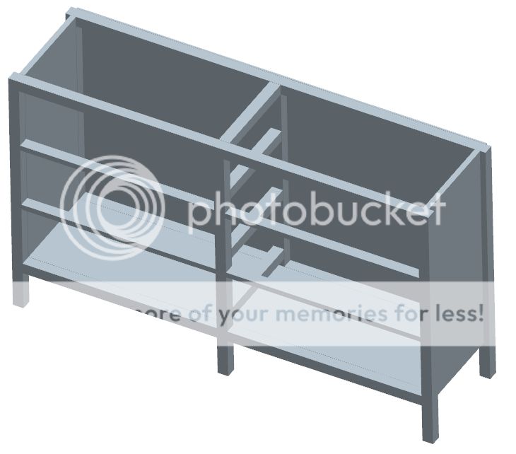

Anyway, we want to paint the dressers. We don't really care for the stained wood look. I've created a design using Pro/E of all the boards that I need for one of the dressers. I think it is a doable project. Just looking for any suggestions or tips as well as information on what type of wood to use. My plan was to use mostly 2x2's & plywood. My lack of woodworking experience leaves me without the correct term for nice plywood that has the outer surfaces finished, but I know I will want to use that. Also, I am fully aware that lumber does not come in the actual sizes that they are called.

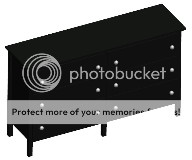

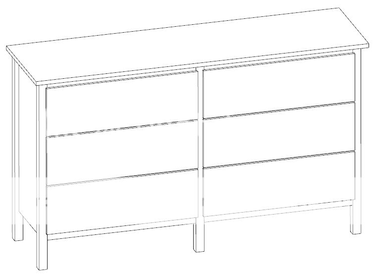

Anyway, here are a few pictures of what I think my first piece will be.
This is what I am basing my design off of:
This is my design:

This is an image of the structure of the dresser with the drawers & top hidden from view. Constuction is primarily from 2x2's & 3/4" plywood panels. The drawers will be mounted to slides which will be installed on the outside panels & on the 2x2's that span front to back in the center.

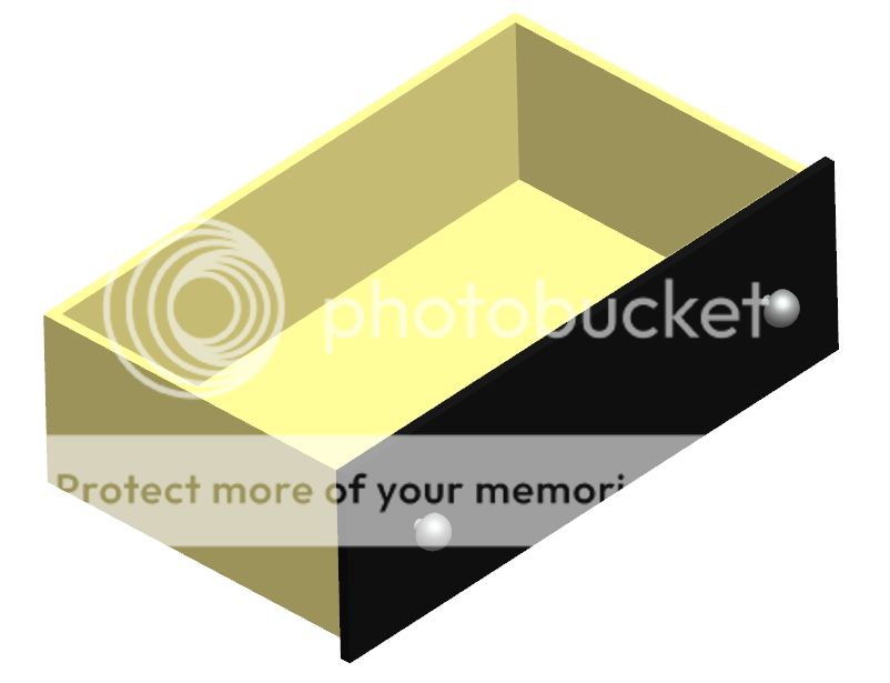

The drawer design is mostly made from 1/2" plywood:

Your carcass plan and the drawer plan are fine. You need to formulate a plan to keep the drawers in place once you insert them in the hole. Either use full length side drawer glides or something similar. You can find the hardware at most of the box stores.

I planned on using full length slides for the drawers, that's why I didn't have anything in there for drawer support.

Your drawer bottoms might fail if you just attach them to the bottom of the drawer carcass. Normally you rip a dado on the side rails and insert 1/4" plywood in the groove. I don't have a dado blade but found out yrs ago that 2 passes with the table saw does fine [I set a fence on each side of the blade and just turn the wood around for the 2nd pass] It is a lot easier to get a straight cut with a table saw than with a skil saw.

A router, even a small trim router really should be used to at least round over the side panels in the drawers, if not they tend to chip with at the top outside corners.
It will also allow a perfectly straight dado cut to slide the bottoms into with a guide on the router.
