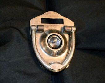

Old 10-25-17, 07:45 AM
G
Join Date: Nov 2007
Location: MI
Posts: 2,364
Received 2 Upvotes on 2 Posts
Need a knocker?
