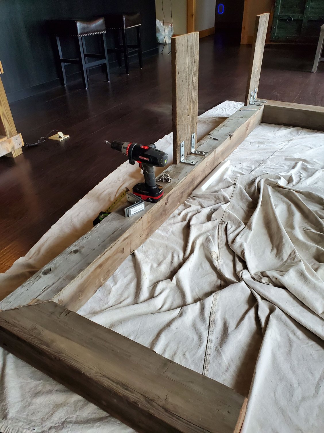

I'm envisioning 3 boards connecting the two top beams, per the very rudimentary table top view drawing. The 4 legs would be attached per the first drawing with no boards connecting them vertically to maximize the leg room of the two end chairs. The estimated weight of the glass is 280lbs. If you think there are instabilities, what changes would you recommend to the design? The 2nd set of drawings has two braces connecting the legs and beam. Is this enough? Thanks.

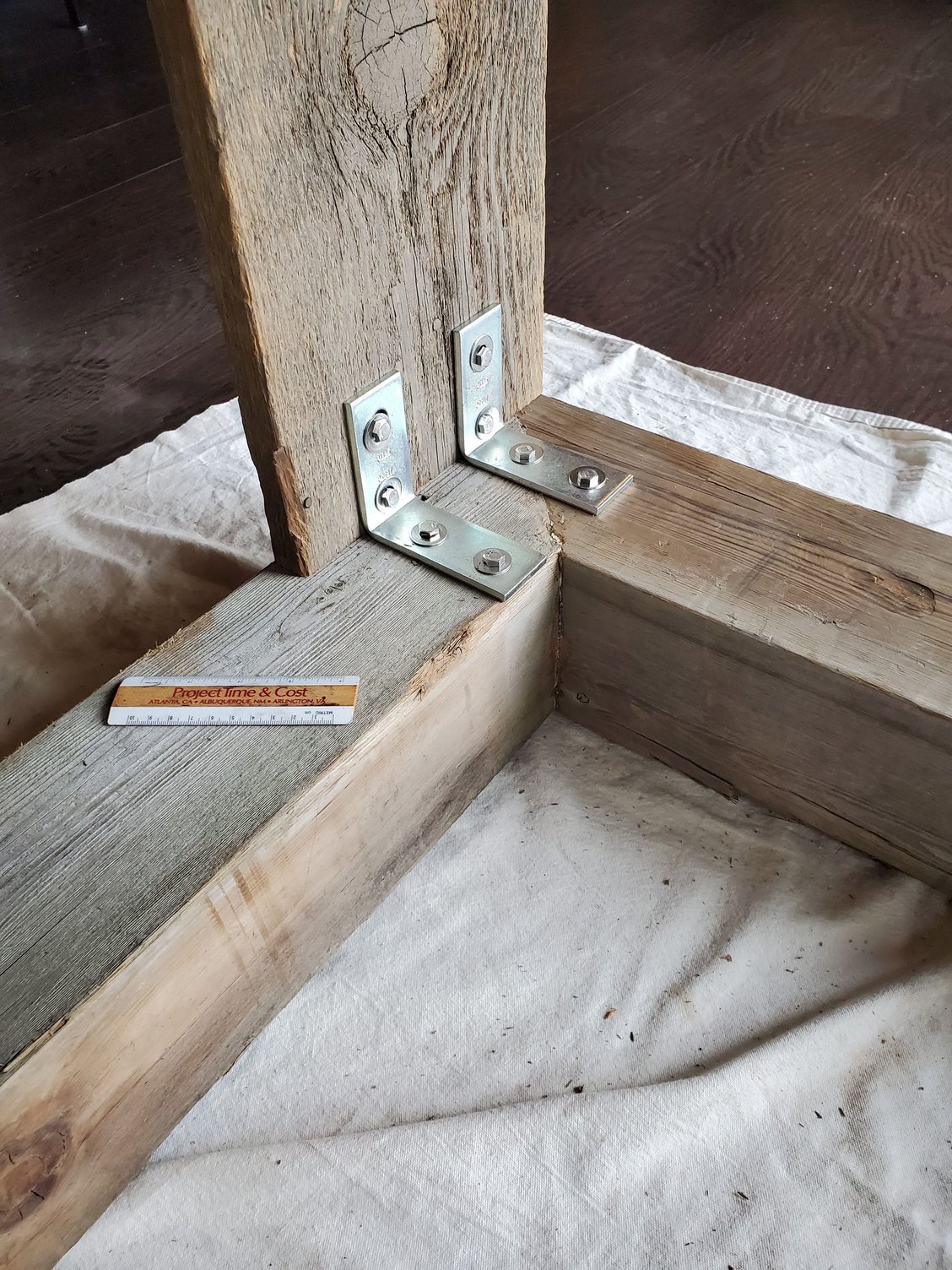

I have marked up your drawing to show the problem areas and some suggested solutions.
If you decide to use brackets I would advise that they be heavier than the ones usually found in the big box stores. Steel that is 3/16 or 1/4 inch thick would be my choice. They could be surface mounted or set flush into the beams and legs. If you want them to show as a design element they could be on outside faces. Otherwise hidden on the inside faces.
Many tables with heavy elements use mortise and tenon joints that are very strong and by their nature resist these kinds of forces. Google "trestle table" or "table mortise and tenon joint" for examples.

Thanks, great advice. I think I'll try the 6"x6" braces for the beams and legs. Then find a way to strengthen the cross members. I don't have the tools for mortise and tenon.

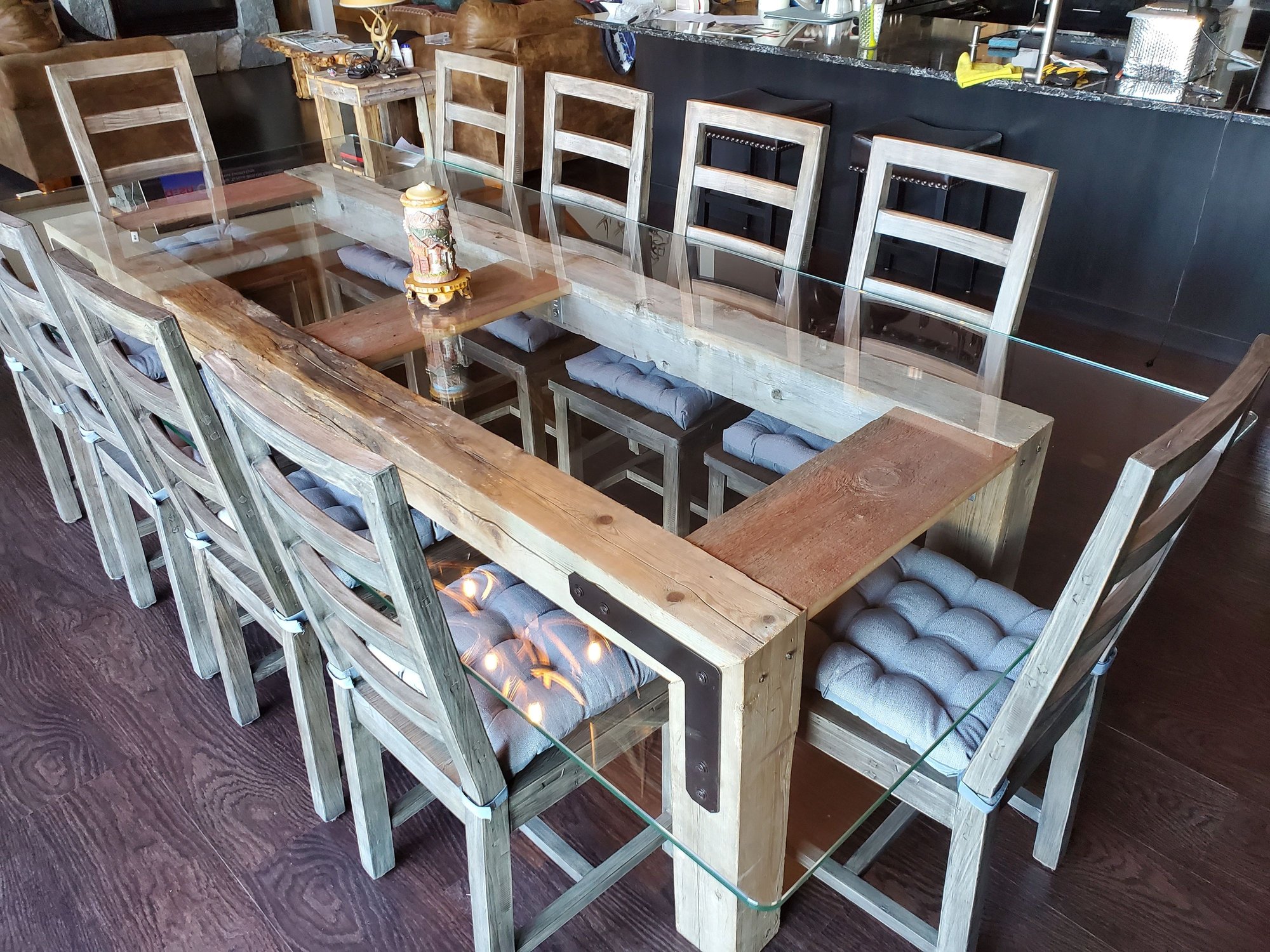

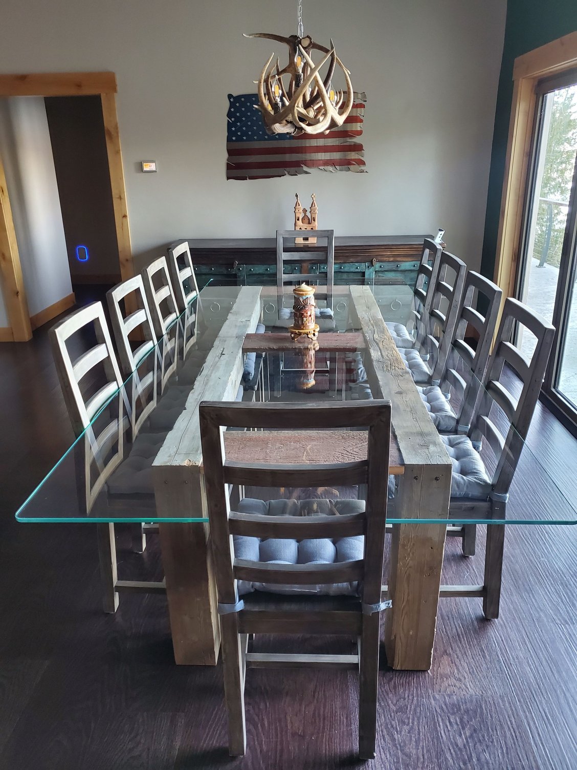

Finished the table
Here's how it turned out. Thanks for all the help.

Rustic, yet modern. Looks nice!

Thanks. The design is simplistic maximizing leg room and view of the outstanding reclaimed cedar. I'm happy with the way it turned out.

Looks really nice. Glad it worked out. Thanks for letting us know.

I love this forum because there are great people here that are knowleable and willing to help. I thought you guys would appreciate seeing the fruit of your advice. Btw, the glass is low iron. It's much more expensive than regular tempered plate glass, but much clearer so you can really see the wood grain. Thanks again all.
