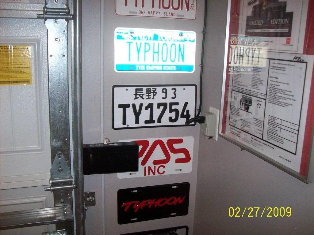

I have this one and I love it. Here are a few pics of it installed.
Jimmy
Wall mounted switch with tempurature and time display. Also has motion sensor to open the light when I walk into the garage from the inside.
Also, it comes with an automatic lock. (Black box).
