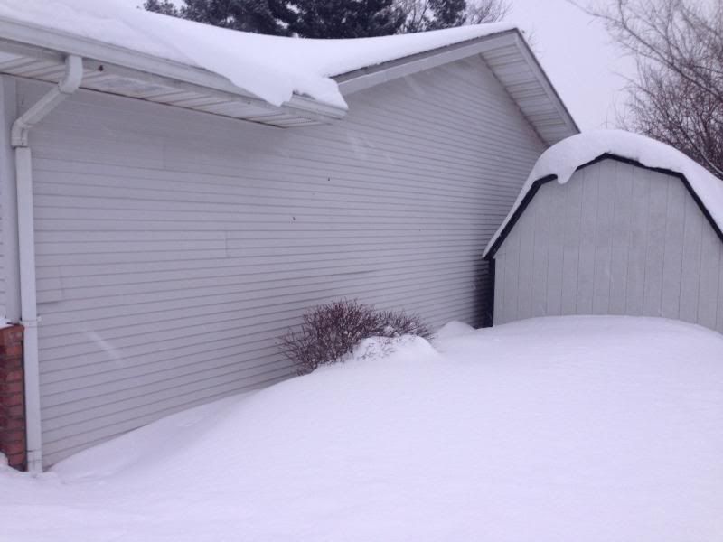

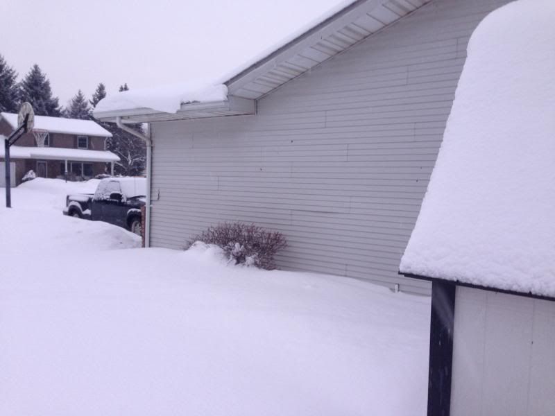

Hello Everyone,
I am seeking some advice on how i can go about adding on a 3rd stall to my existing garage. Unfortunately, the setup of the roof on the current house may make this tricky. When i purchased the home, it had a 2 stall attached garage, and at one point it had a side access door to the outside. Somebody boarded it up before me, so i just put some peg board over it. Now I would like to open it back up and build a single stall addition next to the current garage and make that my primary workshop, adding heat to only the addition. I'd like to do as much of it myself as i can, other than probably pouring the concrete. The tricky part is the location of a storage shed, and the roof line. I have added photos of the space that i would like to use for the addition. I would appreciate any advice or suggestions.
The photo below shows the space that I want to add the extra stall in. The current garage is about 21.5 feet deep from the garage door to teh back of the garage.
The back of storage shed is right at the back wall of the current garage and its entrance faces the backyard, and is inside the fenced in back yard. If it were possible to move it further in to the back yard so the extra garage could be deeper, that would be fine, but I'm not sure it possible or practical. I would love for the new addition to have a single stall overhead door and regular access door both on the front wall, and eventually i'd add a small curve to the driveway to lead to the existing driveway. My main concern is how to handle the fact that the roof line is awkward on the side of the house. Here are a few more pics and I can certainly add more if it helps. I realize its a bad time to get photos cause of all the snow. There is a cement pad from the old side access door on the existing garage that came out right about at the back of the shed.
If anybody can tell me how you would handle the addition and any ballpark costs that would be helpful. Thanks for your time.

A lot of this may depend on how your garage is currently framed... an architect or structural engineer may be needed to come up with a framing plan that won't put any stress on the existing frame that it can't handle.
But here is just a quick sketch of what I would suggest. It's a continuation of the left garage slope up to a new peak, that might be centered on the existing garage wall on the right. The back of the new garage wall would probably best line up with the centerline of the existing gable end that faces to the right. So yes, definitely move the shed!
The setback of the new addition (just a few feet) helps maintain the original look of the two car garage, and also probably makes it a bit easier to frame and trim. As far as the cost is concerned... I would say that it would be a small fortune.

No, I think it sounds like the chimney is in the back half of the existing roof, not in the front half. Even if it is in the part of the roof that gets changed, it's not a big deal.
Here is one last picture from above if it helps you visualize the roof line. Just compare the new with the proposed and note the changes. Each area represents an entire plane. So you will notice how the existing left side of the garage roof just becomes larger and longer in the proposed plan. The peak is higher than previous. The valley is gone. The back side of the proposed garage addition is lined up with the center of the gable end on the right side of your top picture. And then you can see how that creates an inside corner in back... where the front edge of your shed is kind of currently sitting. It would need to be moved away just so that a guy could get in there and work.
One last thing... if that fence on the right represents your property line, you will want to check into how close you can come to the property line with your addition. You may need a variance to build closer to it than they allow... if the local zoning board would even consider it.
